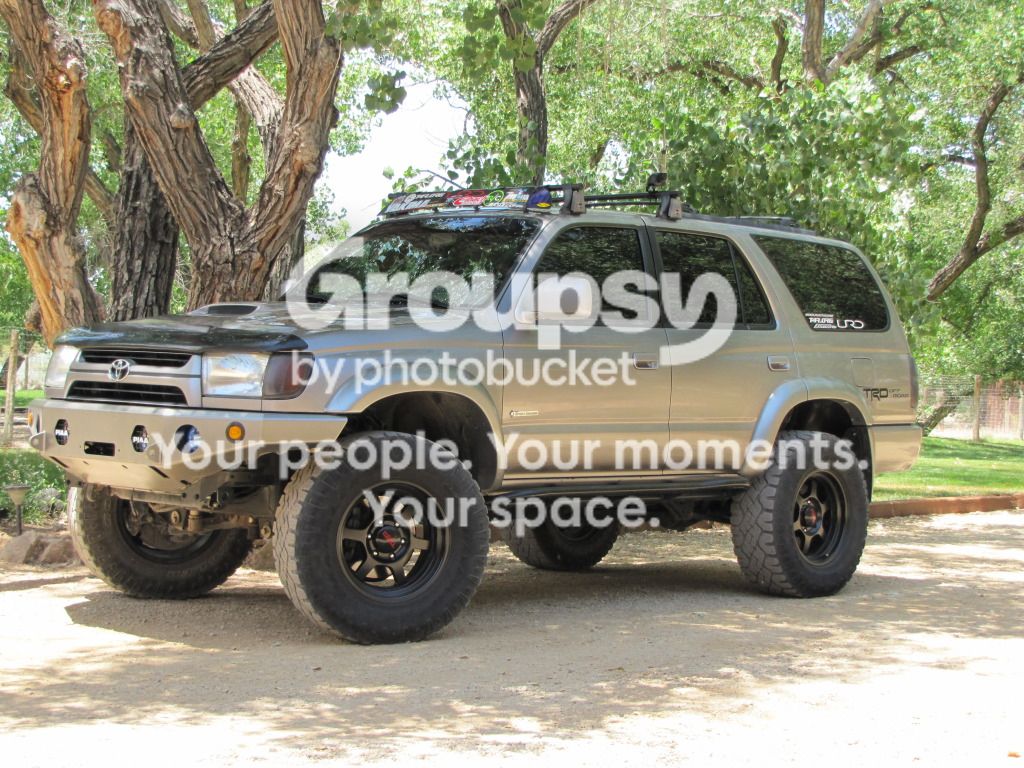

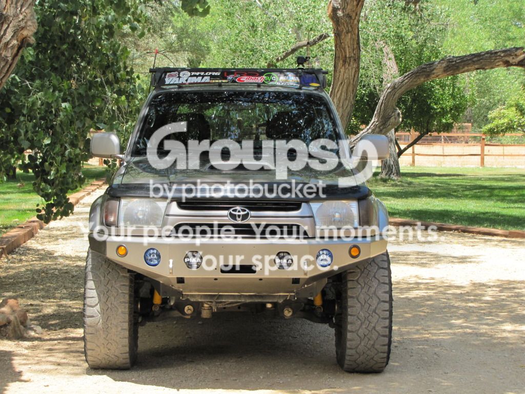

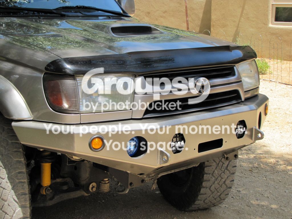

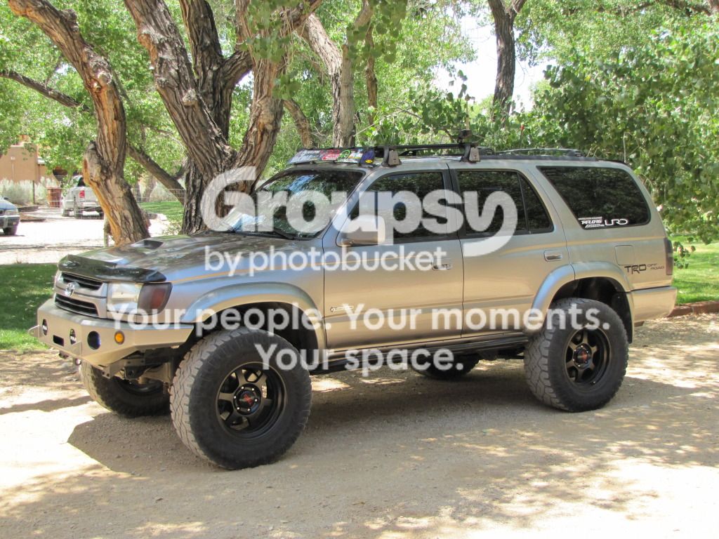

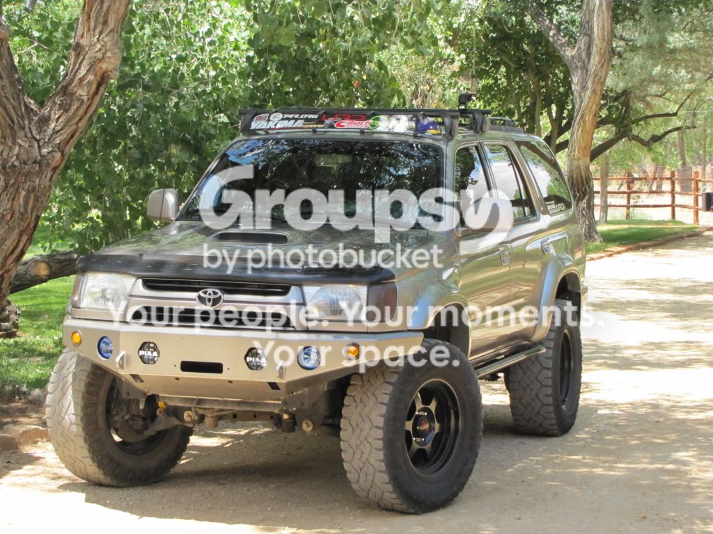

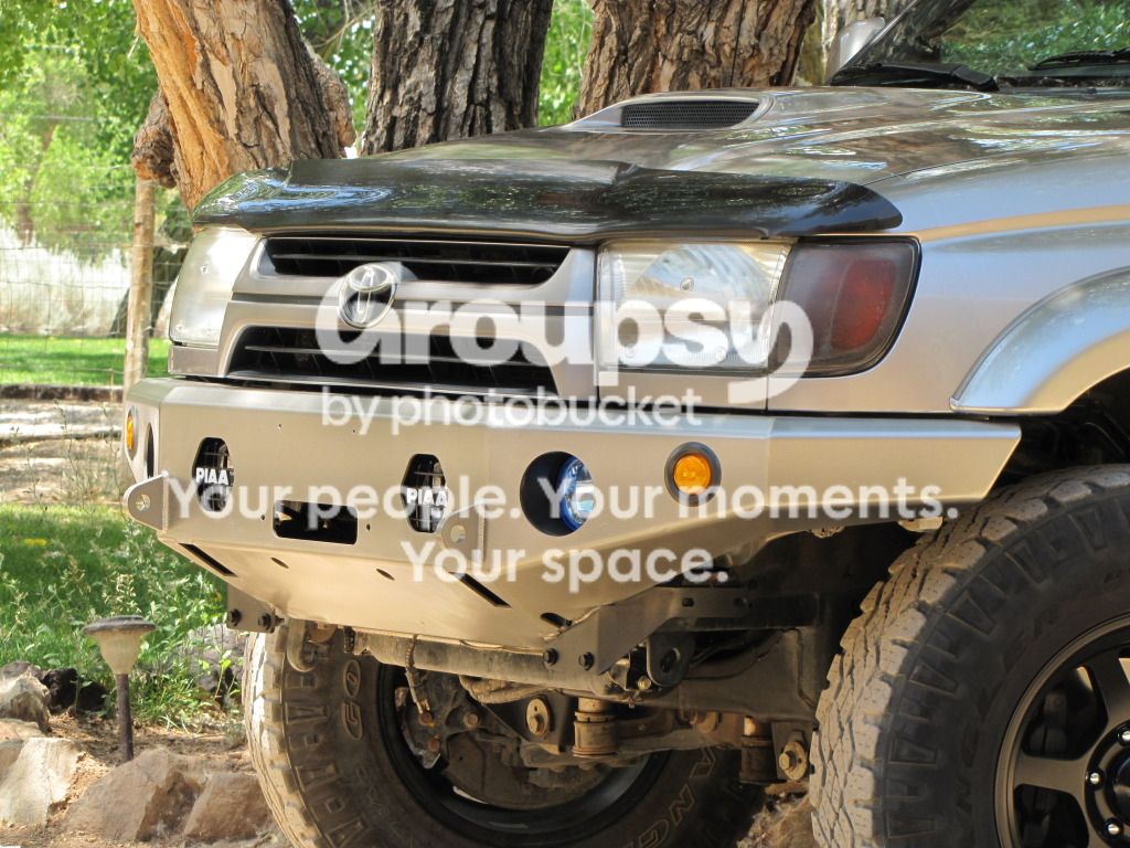

I had to wait like 2 1/2 days for the paint to dry, AND HERE IS THE RESULT!!
IMG_0003-2.jpg~original
IMG_0002-3.jpg~original
IMG_0001-2.jpg~original
IMG_0004-3.jpg~original
IMG_0006-3.jpg~original
IMG_0005-3.jpg~original
what do you think?
