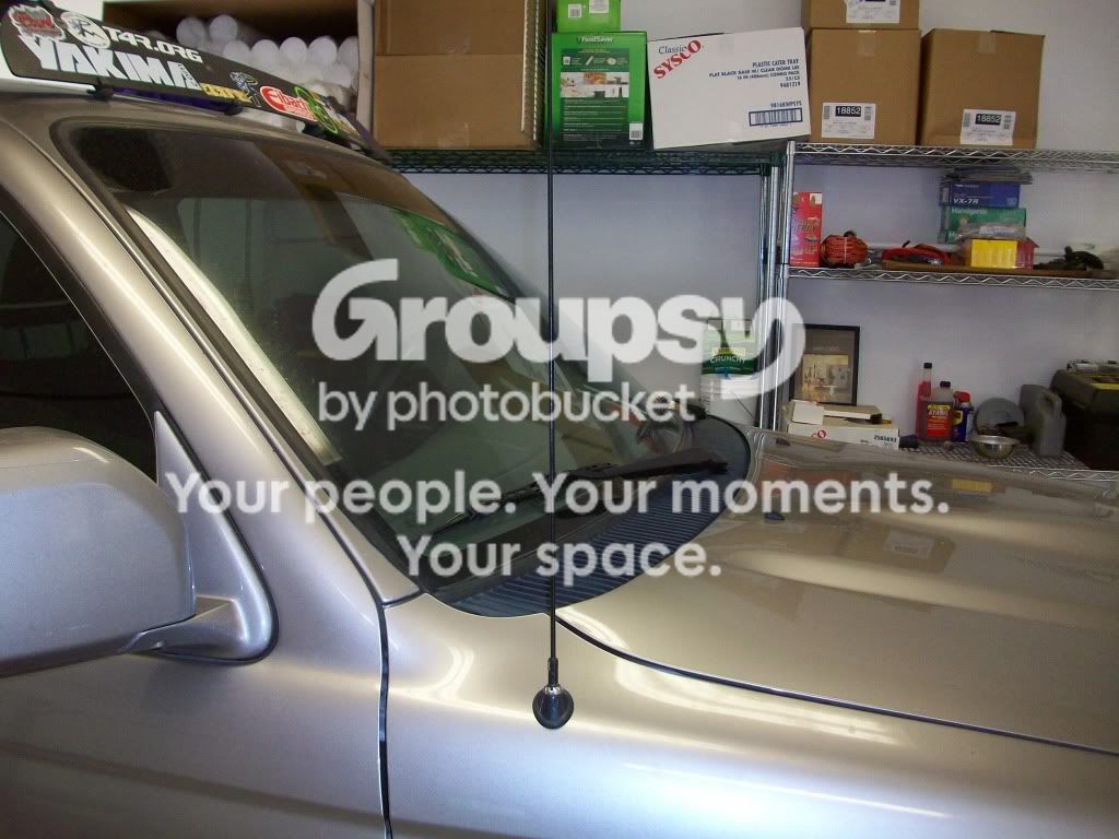

Alright, so the previous owner of my 4runner somehow snapped the antenna off like 6 inches above where it comes out of the fender. It's sharp enough that my dad cut himself on it, but I really don't feel like spending all that time and money for a new one, when I still get a pretty good signal with the old one. That being said, I've never seen the power antenna in action. Is there a way to make it retract while the vehicle is running? My local Toyota expert says they pop up when the vehicle is turned on, is there a way to override that? Thanks.
Do me a favor and don't quote massive posts just to ad a small question to the end, thanks.
The antennas go up and down depending on if the radio has power. one of those ways is if the truck is turned on, also if you manually turn the radio off by pressing the volume button.
You can add a switch to the power line going to the radio to control that.

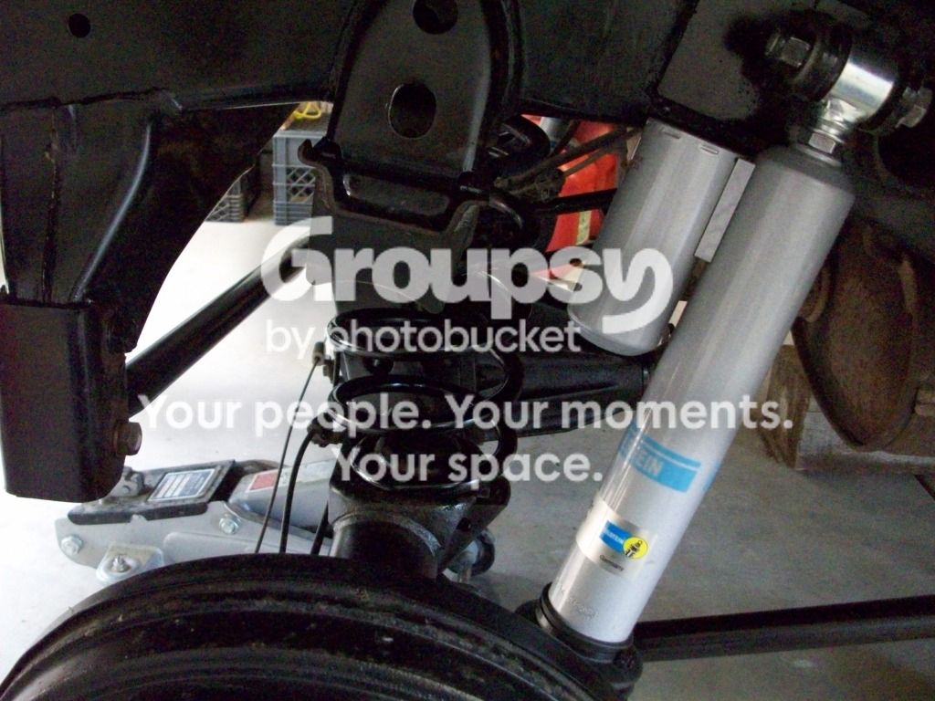

After everything was in, I went for a little test drive around the neighborhood. Everything worked properly, it was good to hear that supercharger whine again . The rear new 5150s are so AWESOME!! I am 100% happy I decided to upgrade, its a very noticeable change over the 5125s. The front feels so barbaric in comparison, coilovers are high on the list now.
Still to do is build the new HD rear links.
For those I am going to use 2" DOM .120 wall sleeves with poly bushings on both ends and 1.25" OD .083 wall DOM 4130 arm. Its gonna be super beef!

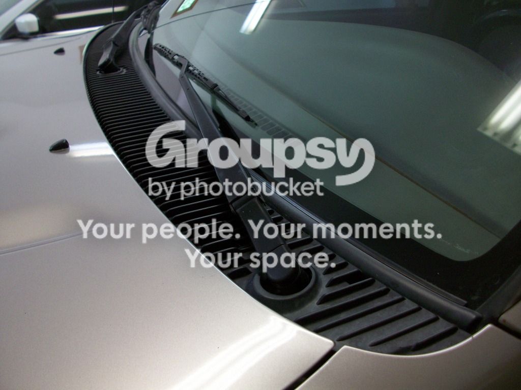

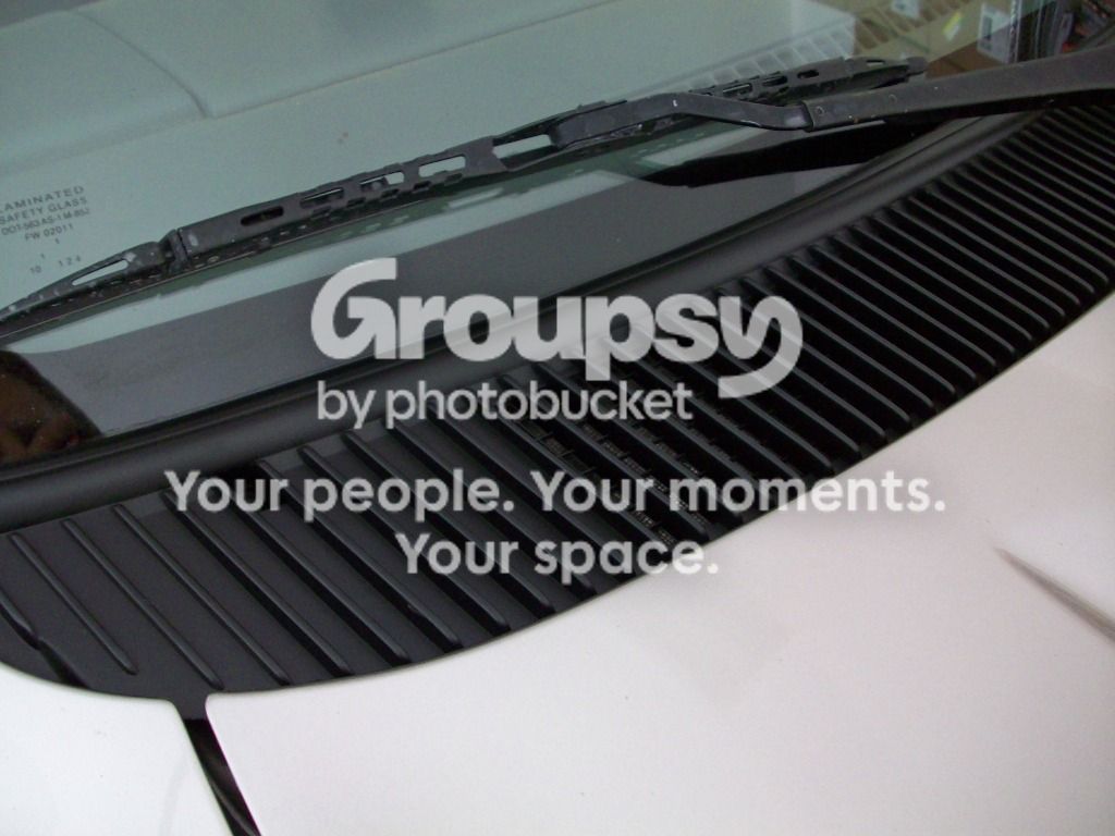

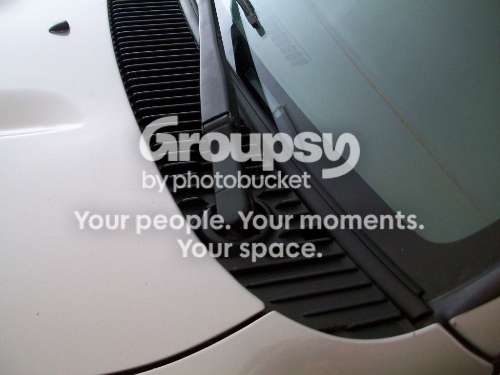

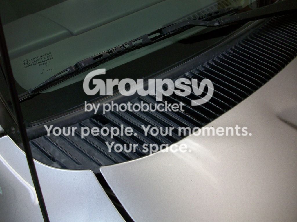

Restored Cowl piece
Today I also did a few little touch ups on the 4runner.
One of them was to remove and repaint the Cowl piece in front of the windshield.
I used RonMAIDEN's write up for it.
http://www.toyota-4runner.org/3rd-gen-t4rs/111794-restoring-your-weathered-cowl-piece.html
A few notes about the write up,
-There are 6 screws holding it on, not 5.
-The nut that holds on the wiper arms is a 12mm, not a 13mm.
-Those wiper arms did NOT want to come off, They were seized on there or something. It took some elbow grease to get them to slide off that bolt.
For paint, I used Duplicor's Trim Paint, it is a durable satin black finish.
BEFORE:
125_1310.jpg~original
125_1311.jpg~original
AFTER:
125_1312.jpg~original
125_1315.jpg~original

What separates the 5150s from the 5125s besides the reservoir, or even the 5100? Is it like a hierarchy system?
Different valving, and the resi allows for crossflow. The 5150 is designed for high speed stuff and it absorbs bumps a lot better. At low speeds there is not very much of a difference between 5125 and 5150.
