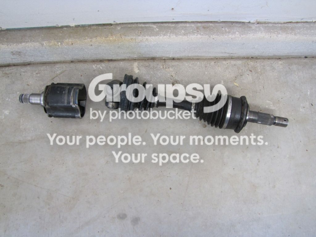

Once I got home I looked at the CVs.
Here is the Driver's side one that came apart, I'm just going to take it to my Driveshaft/CV guy and have him put it back together.

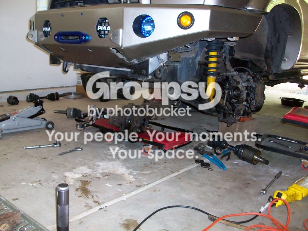

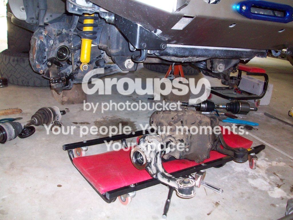

Once I got the new Napa axle in, I went for a test drive around the yard. I was still having binding and clicking when I was in 4wd and at one point it locked up the drivers side wheel when I was idling along. The wheel slid for a foot and the truck came to a stop.
After that I knew something was wrong with the diff, it had to be. So I pulled into the garage and pulled the front diff drain plug. First thing I hear is the distinct sound of metal chunks falling into the plastic drain pan.. Gear teeth.
Cancel my plans that afternoon, this diff is coming out!

One question... what was it about the diff breaking that caused the CV to pull apart like that?

IDK why that CV came apart, maybe it was just over extended at the same time the diff broke. It will forever be a mystery.
