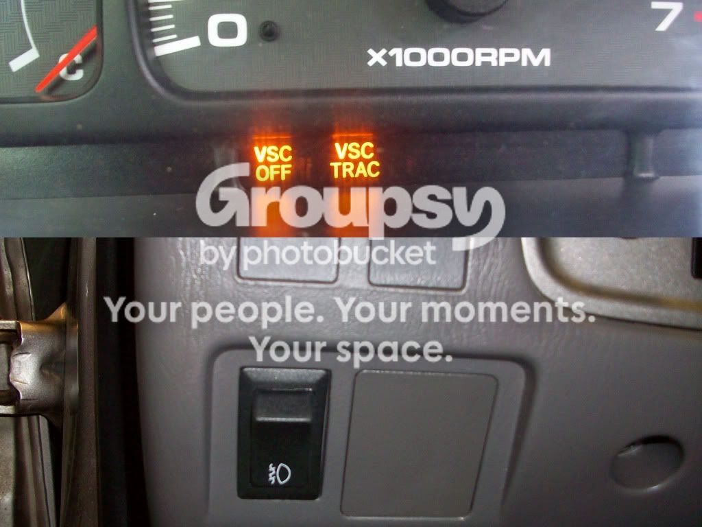

First up was the fix to the most annoying thing about 4runners, the VSC/ TRAC system, and the glorious AndyMod 2.0!
The VSC is what prevents sideways vehicle movement (ie. donuts, drifting). And the TRAC is a remedy for an open differential (when one wheel has no traction/in the air and gets all the power). The TRAC, which stops the spinning wheel, also hinders donuts). The TRAC system is basically a wannabe limited slip differential.
VSC: Vehicle stability control
TRAC: Traction control
Note: Without the andymod; When you are in 4x4 with the transfer case locked, the VSC is automatically disabled, and the TRAC is still active. This is the ideal setup when offroading.
Andymod is just for fun.
For this mod, I ordered an OEM fog light switch ($8.00)
The switch working:
Andymod.jpg~original

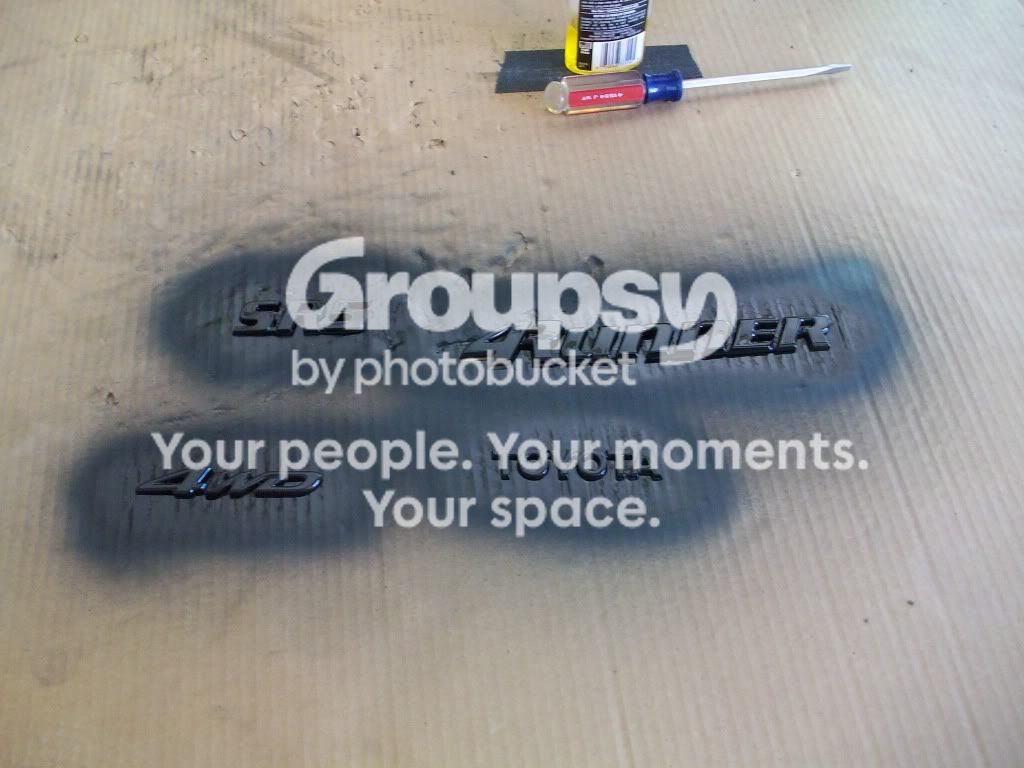

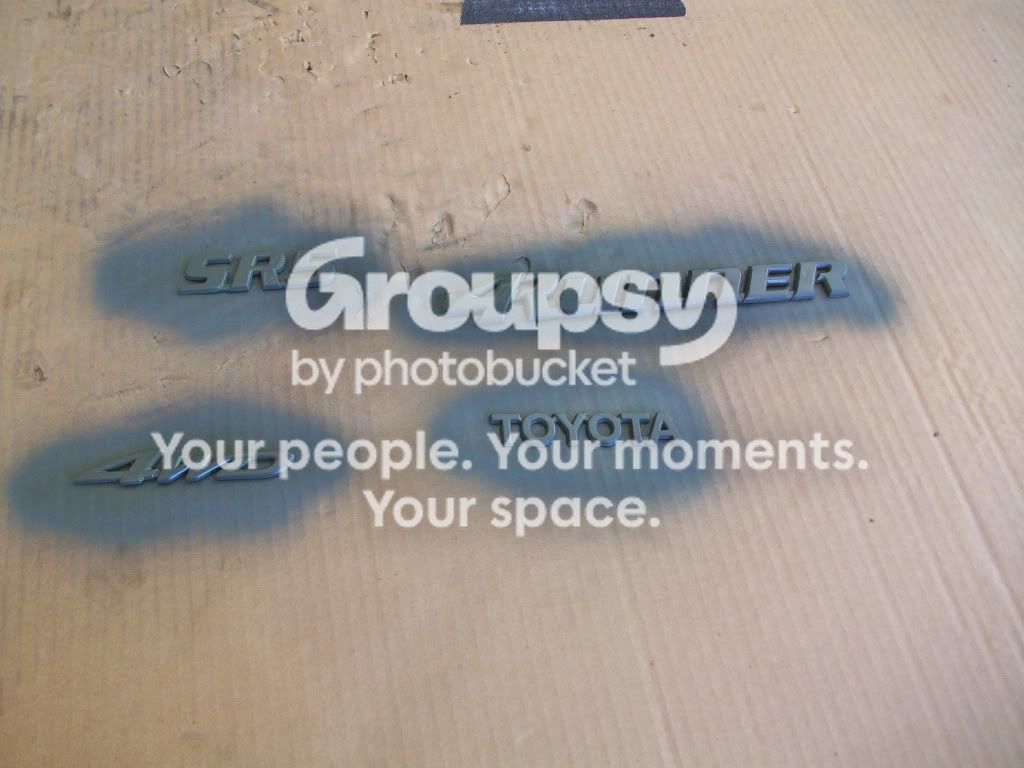

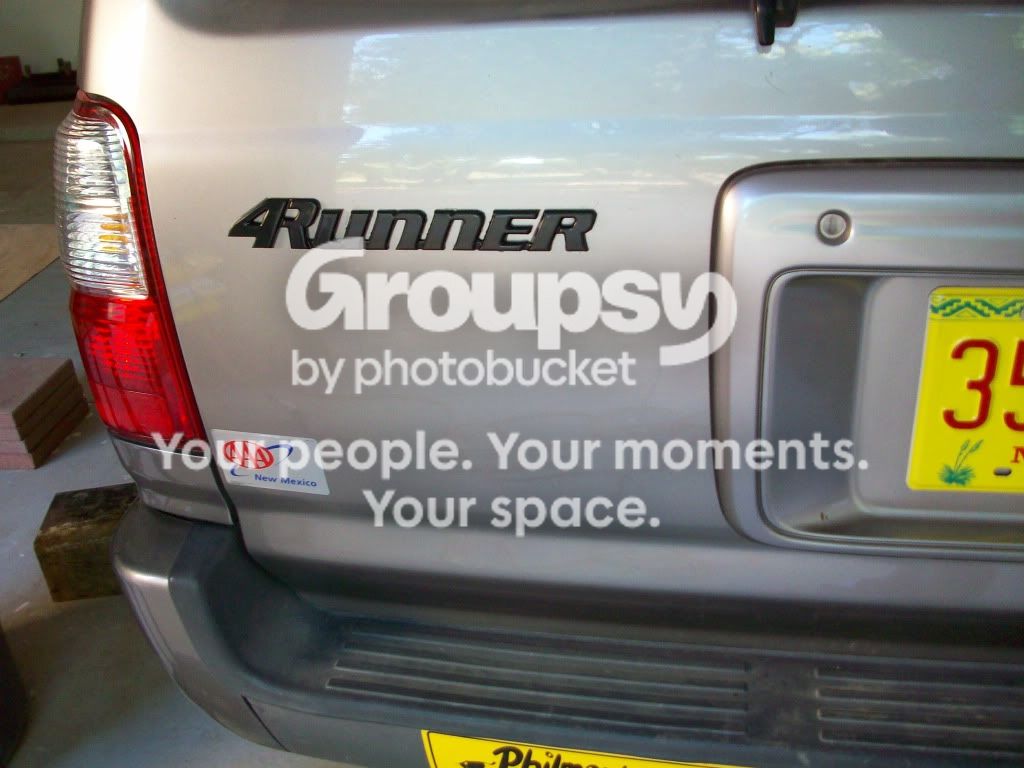

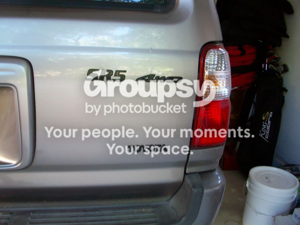

Black Emblems:
Remove and Paint method
Plasti-Dip: (Don't need to remove emblems)
Looking back now, I should have gone with Plasti-dip. This way still works out nicely though.
-For removal, use a hair dryer and fishing line, then goo-gone the excess adhesive.
-Sandpaper emblems with 1000 grit sandpaper.
-Use 1-2 coats of primer and 2 coats of paint. Let dry for 2+ hours.
-For re-installation, use 1/2" double sided molding tape from pep boys for $4.99.
Primed:
100_0507.jpg~original
Black:
100_0508.jpg~original
Back on:
100_0510.jpg~original
100_0509.jpg~original

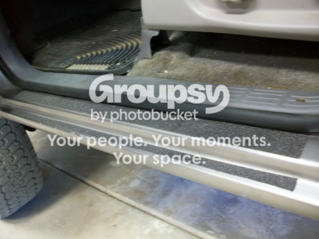

Grip Tape Door Sills:
I used a spare roll of 2" industrial grade grip tape.
3M 7635NA Safety-Walk Black Outdoor Tread 2-by-180-Inch Roll - Amazon.com
For each side, I cut out a section that was 2-feet 3" long. I cut 2/3" of that strip and used it on the door jamb. I used the other, bigger, strip of grip tape on the actual door sill
100_0511.jpg~original
I tried to plasti dip my emblems last night and I did not go heavy enough nor did i have the right platic tool to get the rest of the plasti dip out of the cracks. I figure that im just going to take the emblems off the car so get the remaining plasti dip off. Now my question is how did you get your emblems back on so clean in the right spot and how did you use that tape so none of it is showing once the emblem is put back on?

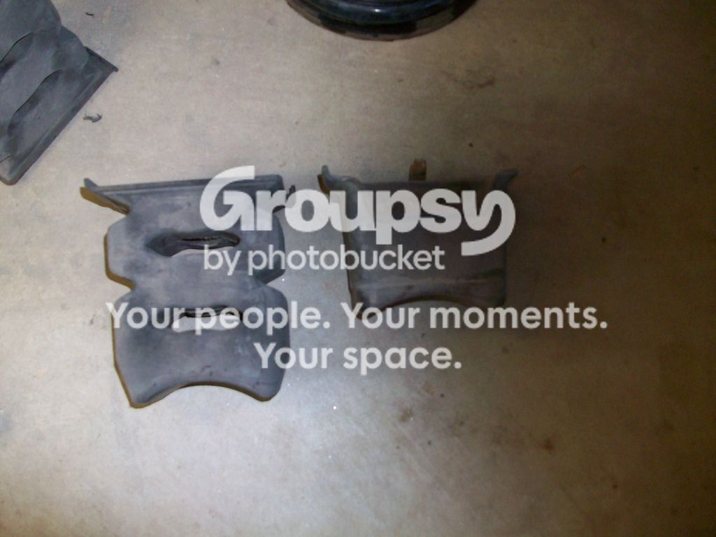

First thing to talk about is extended bump stops. A while back I found some extended bump stops on a 4runner at the local you pull it yard. But even though they were longer than the stock ones, I still needed longer ones as my shocks were compressed before the bump stops were reached.
The stock Bump stops compared to the ones I found at the junkyard on a 4runner they had.
I found a thread recently that had a way to get even longer bump stops at the junkyard from other vehicles.
http://www.toyota-4runner.org/3rd-gen-t4rs/134139-junkyard-rear-bump-stops.html
So off to the yard I went to find the stock bump stops from a Chevy Blazer.
These are what I found:
Installed:
Hopefully these work!
out of what year did you get those blazer bump stops?? and how much are they taller than the OEM?? and for the other 4 runner ones what year aswell?? thanks
