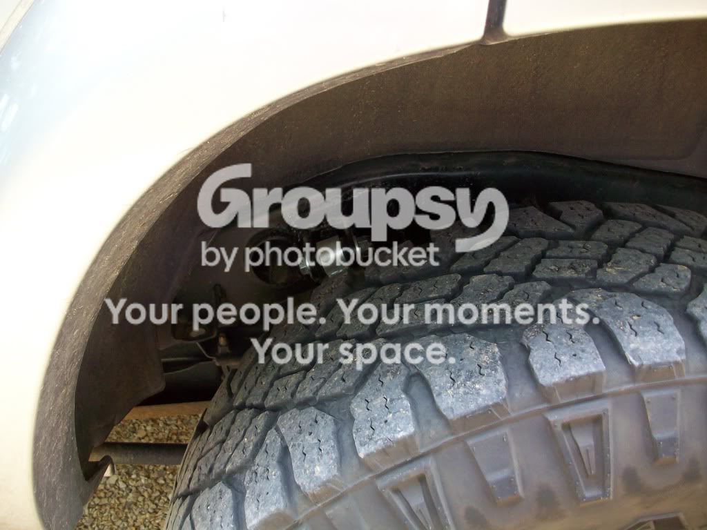

110_1067.jpg~original
So it looks like you ended up right by the circular opening in the frame, and I'm guessing it's the same height as the stock mount was, looks like about 19". I've been toying with the idea of doing this to open up more options for rear shocks, but I'm worried that the placement of the mount has to be exact or I'll mess something up, though it seems like guys mount them several different ways. Just trying to get some insight into what goes into the decision on where to weld the mount. Thanks in advance.
Its on the opposite side of the frame rail from the stock mounts. You can tell what angle it needs to be when the lower mount is in, it pushes itself to that be that far forward.
