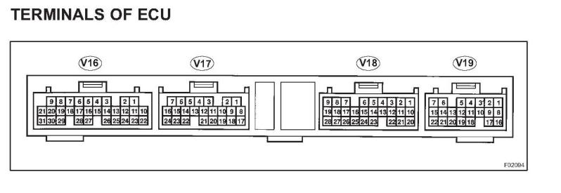

Now for the speed sensor, we need to find the speed sensor wire in the ABS ECU. Here is a diagram of the back of the ABS unit. For 99+ 4runners it is located under the driver's dash, next to the brake pedal. The Blue/Grey speed sensor wire is in the V18 plug, it should be number 16 on that plug.
Just remember that it is the only Blue/Grey wire on the entire ABS unit..
Blue/Grey speed sensor wire located. (The other red wires are for the Andymod, ignore those)

In regards to the temp sensor, does polarity matter? Or can the wires be connected to either post? I've yet to see anyone actually label either of these leads beyond their colors; as positive or negative

The temp sensor is a non-polarized variable resistor. Either pin to either location will work fine.
