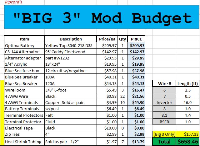

Here is my parts list for the entire electical project

Parts/Cost:
$209.97: Optima Yellow top 8040-218 D35
$57.98: Blue Sea 12 circuit fuse box
$40.31: Blue Sea 100A Breaker panel mount
$44.13: Blue Sea 120A Breaker panel mount
$19.95: 1/4" Acrylic 18"x24"
$16.47: 3/8" Wire loom
$21.56: 22ft 4AWG wire ($0.98/ft)
$49.90: 10 pairs
$6.49: Marine battery terminals

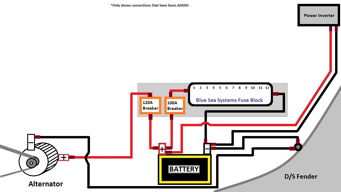

In the end, my wiring will follow this diagram: (NOTE: The power inverter and fuse block are not part of the BIG 3 itself, they are an extra piece I have added)
