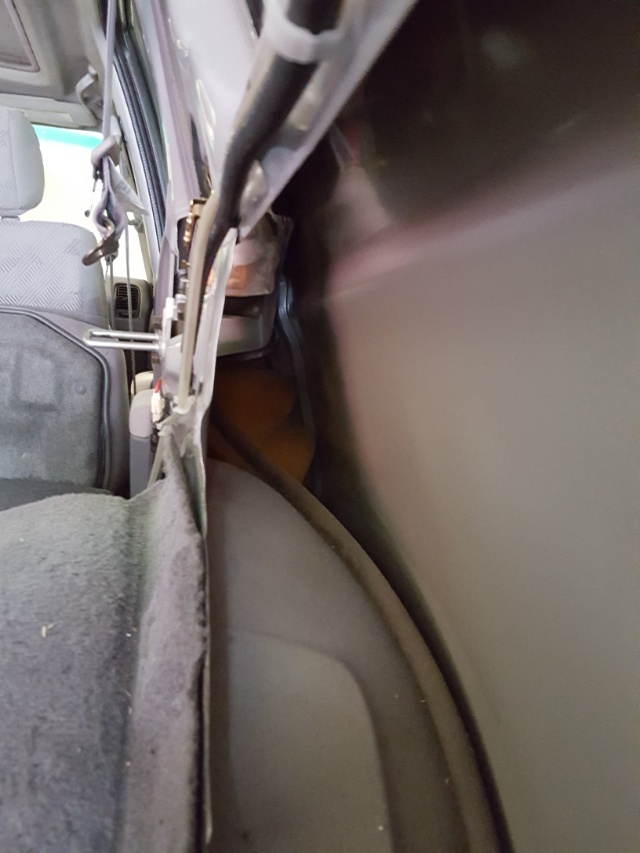

Start by removing the middle roof plastic trim that the rear cargo light is on. You need to start by removing the plastic lenses cover for the light. Use a screwdriver to pry, from passenger side, the lense cover away to expose the four Phillips head screws that hold the light fixture in place. Remove the four screws and gently pull the light down and angle it so that it can go through the hole when you remove the plastic trim piece. Gently tug the plastic trim piece starting it either side and then guide the cargo light through the hole setting the trim piece aside. This will expose a tiny screw that anchors the large interior quarter panel piece to the roof.
Once you remove that tiny screw, and removed both cargo cover mounting brackets, then you will be able to start gently tugging the interior quarter panel on the cubby hole side away from the body. Some of the cargo area panels and cubby holes very from year-to-year in their size and design. My 2002 has a small removable shelf type tray in the dark black plastic cubby hole portion. Remove this by pressing up from underneath once you have the panel slightly separated from the body. If you do not then this Trey will prevent you from pulling the panel away from the body as it sits behind the wheel well pinch weld lip. Once it is removed you have greater access to remove the panel. At this point we opted to take the seat belt off. It's a little bit more work but it would have been a righteous pain in the ass to try to mount the compressor with the panel still in side vehicle. Of course you could try, but why would you?

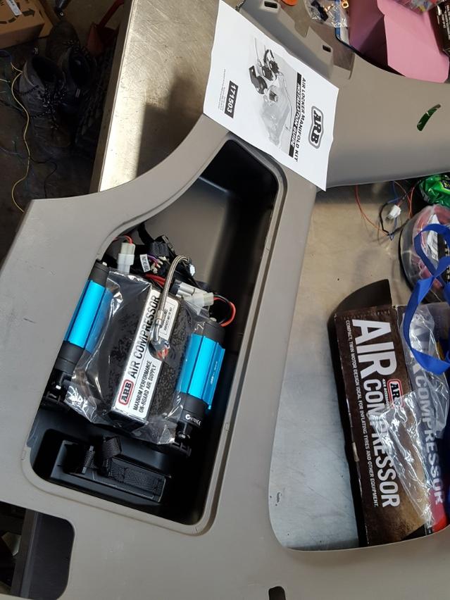

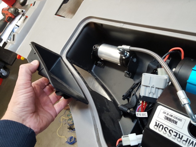

Mounting the unit.

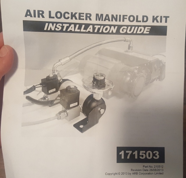

ARB does provide you with a sheet of paper to serve as a guideline for marking the holes for drilling. Note that cubby hole mounting surface is not perfectly flat, meaning that if you lay this piece of paper perfectly flat and draw and drill your holes they may not match up perfectly. You will want to mount unit so that the logo is upside down with the electrical connections facing the front of the vehicle unless you want to just make things hard for yourself. Give yourself enough room two awesome mount the manifold kit just to the front of the compressor.

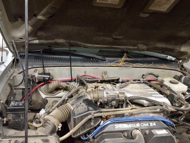

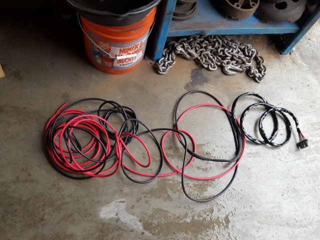

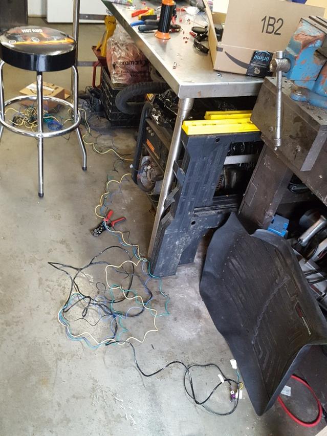

This is not my idea of fun. Trying to fit 10 lb of funk in a 5lb bag. To go the distance that we needed from the rear cargo area to the front battery was about 25 feet give or take. So after creating the extensions for the loom, we routed a hole in the removable tray portion of the cubby hole for the wires to pass through being careful to think where are the wires will have to run to not interfere with mounting surfaces and not have to make 90 degree turns with the 6 gauge wires and the control wires. We slightly bent an interior body piece of metal between two mounting post towards the outside of the vehicle somewhat to create a more agreeable surface for the wires to make their turn as opposed to a hard-edged that could get scrape or fray the wires if they rubbed.

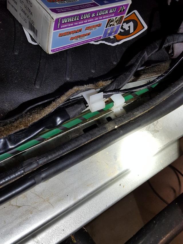

Remove and route interior trim on passenger side to route wires. Take your time and remove both front and rear floor trim pieces. Then remove the three darker door transition pieces. ( if you're removing the rear quarter panel the rear transition trim molding piece should have already been removed.) Then remove the b-pillar trim piece that the passenger side seat belt routes through. Lastly remove the passenger front right kick panel right underneath the glove box.

No fun. The control cables are fairly easy to manage and they can simply take a left turn once they get to the dash area and be routed under the dash / behind the dash to the on-off switch selector that will be on the driver side.

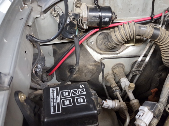

Once you get the power cables up to the front passenger seat area go to the front of the vehicle and locate The Grommet pass through that is about two to three inches in diameter. This is what I used to pass the power cables through to the engine bay. Unless you feel like removing a whole bunch of items I would suggest doing what I did. Have a friend take a small wire to pass through from the front of the vehicle on the engine bay side. If you're down by the floorboard shining a light towards that area you can locate The Wire and wrap the two power cables around the wire with electric wire making sure to get a good connection by folding the smaller wire back towards the area it will go after you've wrapped it up a few times with electrical tape finishing off the lead portion with a bit of coned electrical tape as to provide a smoother transition surface for it to guide through the grommet. Once your friend has hold of the power cables we found it easier to manage to pull one cable at a time black or red till they were fully fed through. We routed the cables along the firewall towards the driver side of the engine bay and then forward towards the battery terminals.

Looks good Ryder! I want some sort of on board air so I can tuck it away and not have to carry the VIAR portable compressor anymore, but they're so pricey.
Drawbacks to mounting in rear cargo: lose some potential rear cargo space. Air compressor is louder when mounted in side.
Nice. Before you get the locker you might need to rotate the manifold 90 degrees. It's hard to tell in the photo but it looks like there might not be enough room for the locker solenoid with it facing down. There's enough room for sure if you rotate it so it points rearward.

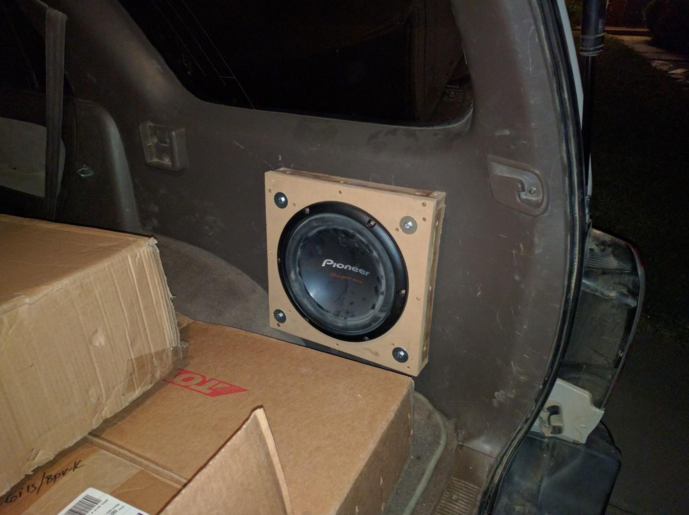

As far as loosing space and noise in the cubby hole goes, I'm pretty sure mines louder. lol
You have no idea I have 3000 watts in my runner 3 amps 2 battery’s 1 sub you wouldnt believe the sound of you heard it

I love those cubby sub boxes. THAT is a great use of space in my opinion. Yeah, the pics make the downward firing ports a tight fit for the solenoids. But the manifold can be loosened and pivoted to try to create more room. Or it could simply be relocated should i need to down the road. Till then, it will be mostly used to air up tires. Where are all the contest to win an air locker? That's what I want to know.

My friend is a great help with all things electrical, but mainly we just extended everything. We used the provided ARB loom harness. The front end as far as switches are ARB provided. I don't have a locker at this time. :sobbing: , but this is a way forward should the opportunity present itself for me to pick up a rear air locker. I have some finishing touches to include, primarily adding an aux blue sea fuse box. Most of my major electrical additions hitherto this point consist of a Warn 8000m winch and the ARB compressor. Neither can really go through the Blue Sea fuse box to to amperage draw limitations of what the fuse box can handle. I have a 500 amp Mega fuse to go between the winch and the battery. However... Amazon sent me the wrong Mega fuse holder. :mmph: Figures... It will get sorted. I still need to pick up the ARB air hose and connection before I can even use my compressor. I hear you one the wiring front. My main goal is not to burn my truck down. You might not have to do any extra wiring if you engine bay mount. Then installation is more straightforward.

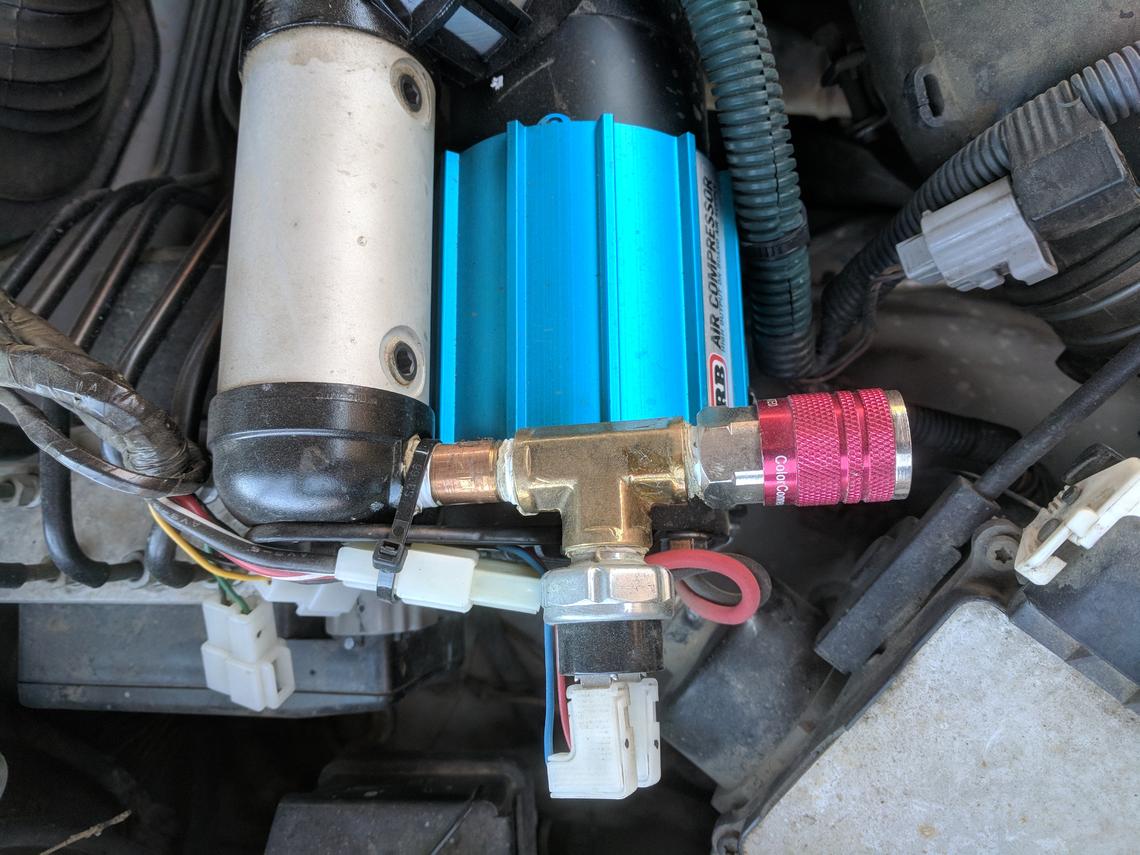

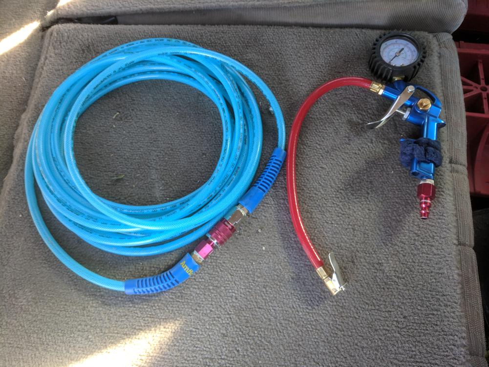

OK. Here's my setup.
You'll need:
1/4" NPT brass tee
1/4" x 1 1/2" NPT brass nipple
25' x 1/4" Male NPT air hose
1/4" Quick connect adapter kit.
Tire inflator
Just look at my set up and copy it.
Basically you unscrew the ARB pressure switch. Screw in the nipple. Screw in the tee. Screw in the pressure switch. Screw in the 1/4" Male quick connect. You can orientate it anyway you want. The quick connect kit contains all the parts and then some to make it work however you want. You could probably save some buy just buying the adapters you need instead of the kit but it's cheap enough. Also make sure to put pipe dope and teflon on all the fittings.

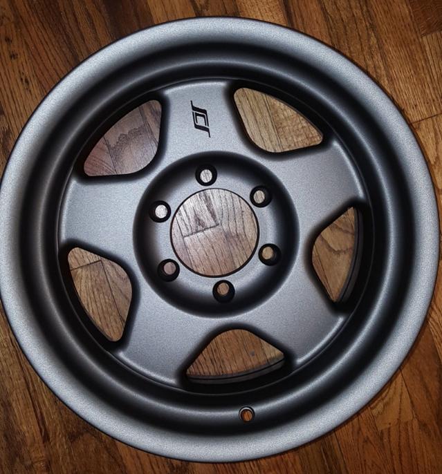

In other news, I found out my SCS F5 wheels are at UPS waiting for me to pick them up. I'm pretty stoked about that.
SCS F5's 16"x8" w/ 3.5" BS in Matte Gunmetal
My dumb smartphone can't capture how cool these things are. I love the finish. It looks a bit darker than the pics let on. I am sure it will look better with natural light. I need to rescue the 5th wheel that got held at a different location than the UPS sort facility tomorrow. I might get these on this weekend with some luck.
Shout out to Vuth at SCS! I dig the sticker too.

Like the wheels. I got those in black a couple months ago and like how "deep" they look. Had a hard time deciding between the black, dark bronze & gunmetal. When mine get scratched up will probably have them powder coated dark bronze or gunmetal and see which color I like best.

Excellent choice! Can't wait to see what they look like mounted on your rig. Did you have to wait long to get them? How was the ordering process? Mad dash once the site was updated? That was my experience when I was considering them.
I see they're 16x8. What offset/BS did you go with?
Yeah, I wanted to get back to a hub centric wheel. Trust me, I spent quite a lot of time on Google search, here, and Tacoma World trying to get an idea on what color I wanted to go with. I just wanted to try something different from my current black Pro Comps. I think that's what tipped the balance in favor between the the Ray 10's & F5's. I already had black wheels with holes in them.
Thank you. You need a little luck, but the Ray 10's are the ones that seem hard to get, or if you are looking for a limited finish it can be difficult. But they seemed to have multiple sets of F5 in gunmetal, so once I decided, it was easy. They shipped super fast for me. I am not too far from Oakland though. I can't wait to see what they look like as well.
