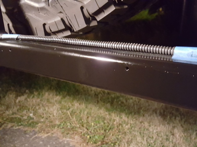

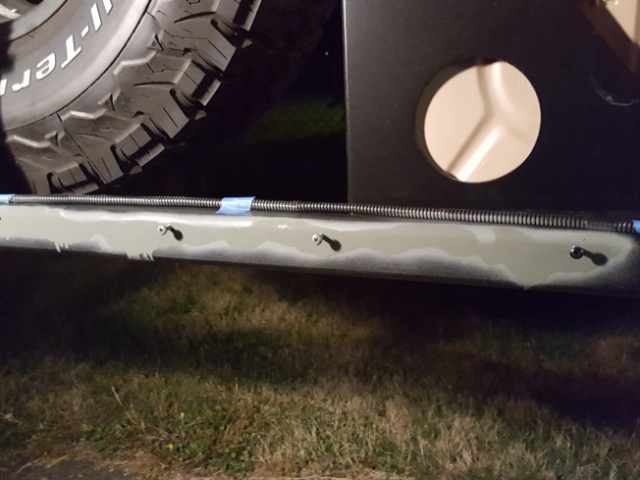

Temporary fold-down table delete.

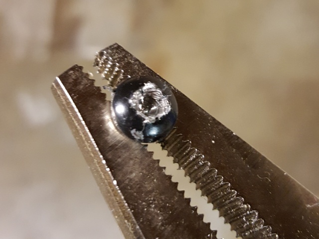

So my 4X Innovations fold down table has been clanging back and forth due to securing latches being bent either in shipping or at the powder coater. I ordered some extra latches from Adam to address the issue. They have been very cool to deal with. Adam and Ben have been super helpful with all my questions.
So swapping hardware out is pretty straightforward except that the bonehead powder coater powder coated everything. The intake person who took my bumper said that they would remove all the hardware and put it in a box for me to reassemble when I picked up the bumper. No problem there... sounds pretty straightforward. However, when I picked up the bumper, well beyond their target date, it completely different and much younger person brought my bumper out on a pallet. I noticed that they just powder-coated everything and did not remove any hardware. So this meant that nothing behind the hinges or latches was actually powder coated. I knew this would create rust issues and it would need to be addressed at some point. I should have just had them fix it then... Anyway..
Due to all the screws and bolts being powder coated, they did not want to break free and began to strip. So I decided to pick up a screw extraction kit and began to pickaway where the head of the screw meets the surface with a pick tool. I only needed the extraction device for one of the screws, but it came in handy.
I was working in the dark and found out there was a chance of rain tonight. As I can't put my vehicle in the garage I wanted to try to prime and paint the section that was bare metal and rusting. I managed to get it sanded down and remove the rust from the surface. I primed it with some self etching primer and then followed it up with some semi-gloss black. I also threw in some stainless steel screws to keep water from getting into the swing arm body.
This will buy me some time to better address the issue on some weekend with compliant weather. I think I will just do my own painting from here on out. The powder coater did offer to redo the bumper. I thought about pulling just the swingarm and having him redo that portion, but I would probably need new bearing seals once I put it back together and it just seemed like a giant pain in the ass I did not want to deal with.

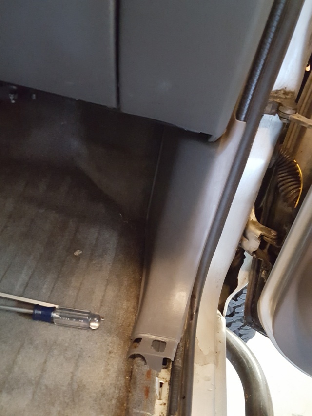

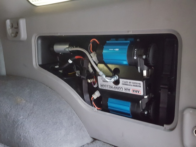

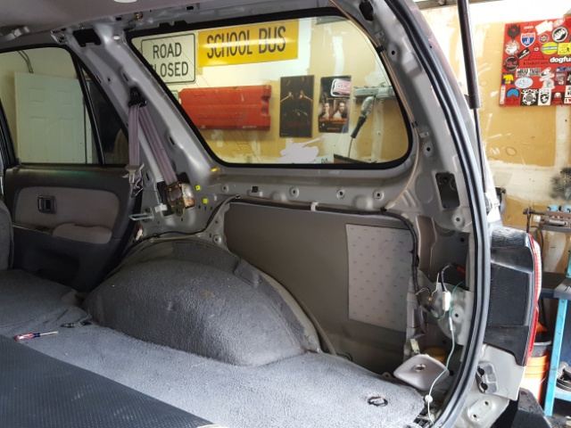

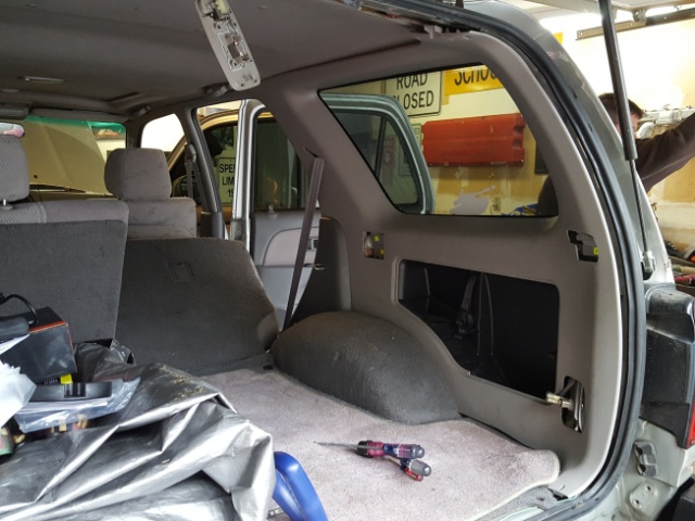

ARB Twin Compressor mounted in the cargo cubby hole.
I had been meaning to do this for a while. I have had a twin ARB compressor sitting around waiting for me to mount it up. Well, today's the day.
I will throw a bunch of pics in here to assist others contemplating doing something similar.
Why mount in cargo area?
This compressor can be mounted in the engine bay, (passenger side). But even then, it's a tight fit, you will need to move items, (year specific). Other potentiall drawbacks to engine bay mounting are hotter, dirtier air, potential to get wet and suck in water. These units have a fairly good reputation for being able to handle some abuse.
Drawbacks to mounting in rear cargo: lose some potential rear cargo space. Air compressor is louder when mounted in side. Having to run positive and negative power cables as well as control cables from the back to the front of the vehicle. Routing the cables is not as fun as it might sound. You will need to pick up some supplies.
The manual calls for 8 gauge power cables. We went with 6 gauge for power cables, (25 feet each) and I believe 18 gauge for the 4 different primary control wires, (40 foot rolls). Add some butt connectors, battery cable lugs and heat shrink. All told about $130 extra to have enough cable to mount in the rear.
