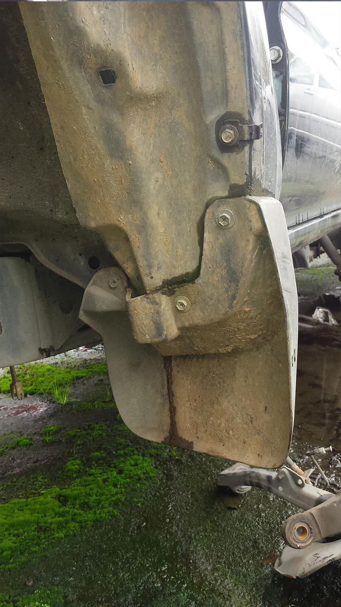

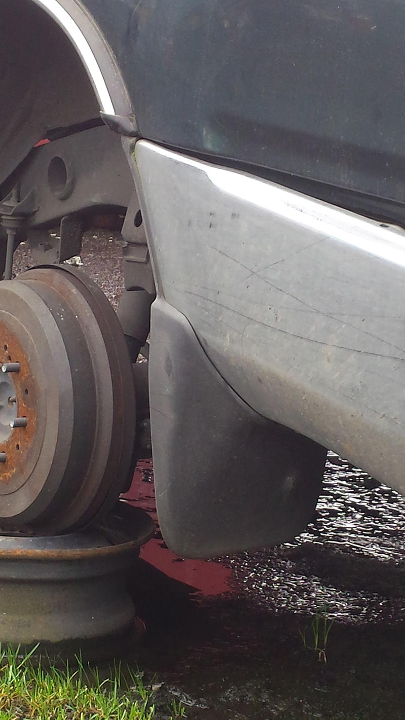

Too much IMO but you can negotiate I'm sure. Wants $20 each. I didn't inspect them too closely for damage. Here's a quick snapshot. Grabbed my LCAs...yay.

Thanks for checking and taking time to ask and take some pictures. That might be a little too close to what what Camelback sells them for new. I think I will go with Camelback on this one, but thanks for looking out man!

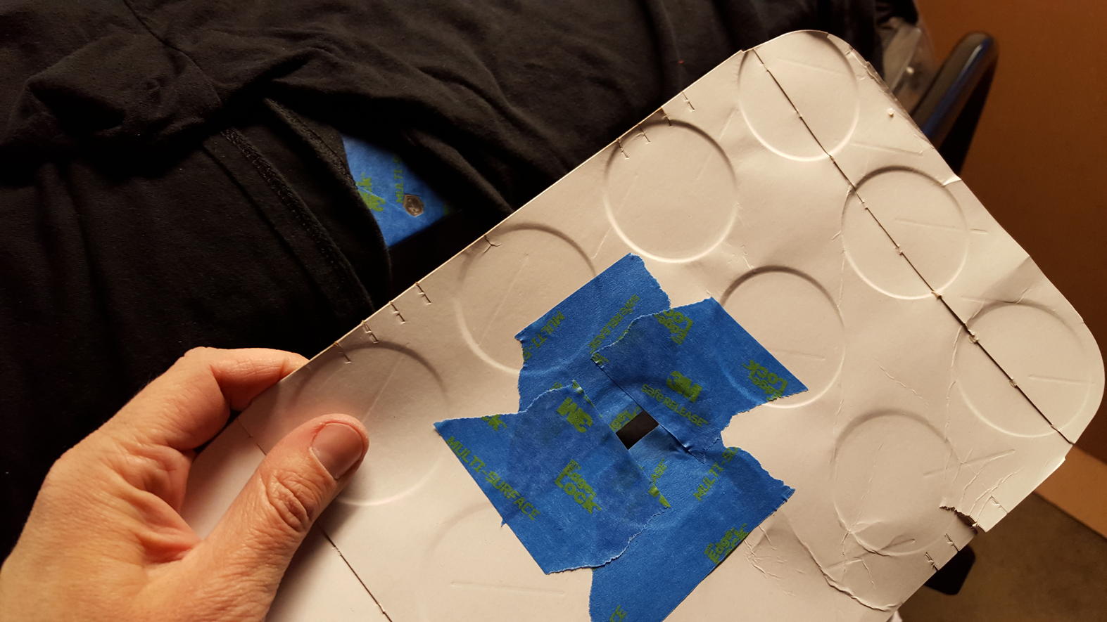

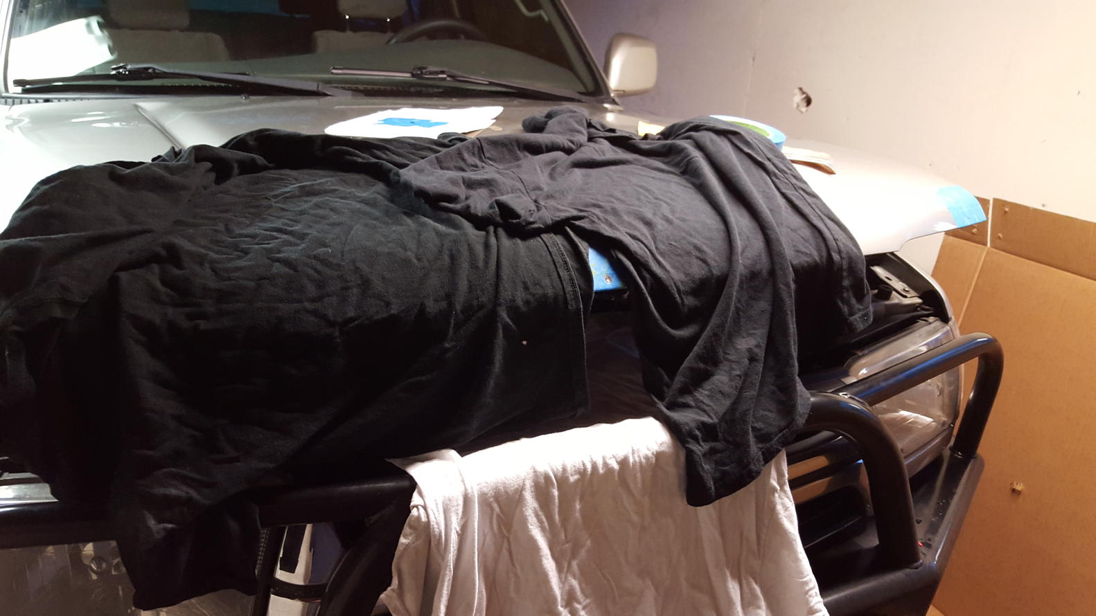

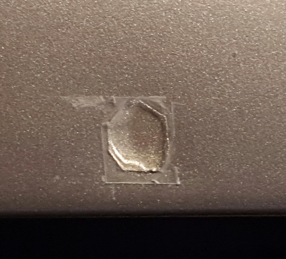

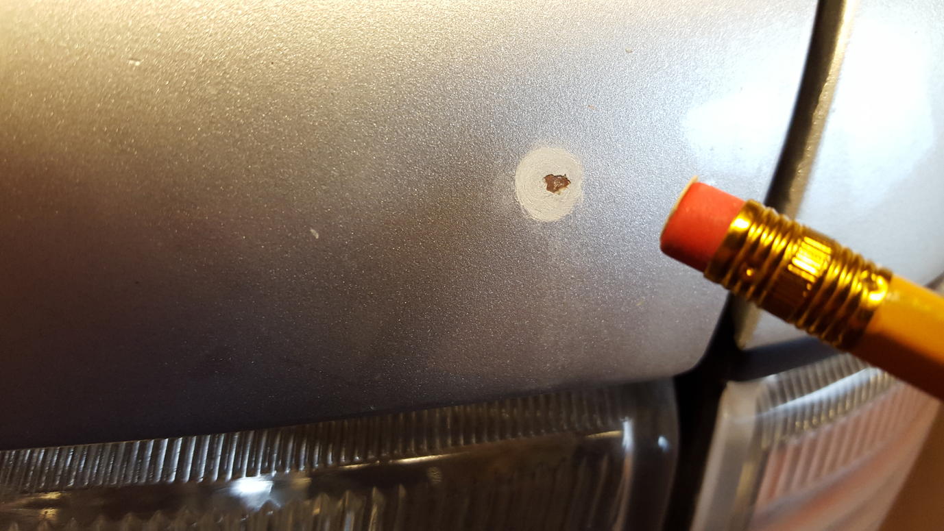

So, after arming myself with just enough knowledge via youtube, and several trips to the hardware store and O'Reilly Auto Parts for close-enough provisions, I set myself to the task of doing a bit of rust removal, priming and touch up.
I am keeping my expectations low on this one. The way I figure it is, even if it isn't pretty, it has to be better than rust. That and most, well really all, if things proceed as planed, are not visible.
The goal it twofold. I want to touch up some damage to protect from further rust, and (the main goal) put my hood mounted stone guard back on. I have had to remove it after I mounted my Shrockworks front bumper because it left no clearance to get your fingers in to activate the hood release.
So after taking off the guard, I realized how much I liked the look, and probably function of the guard. I noticed I had a few healthy, and rusty, dents in various places. Most were tiny, one about the size of a breathmint. 5 on the hood and one on the driver's side roof.
I saw a video where the guy suggested using a hole punch to punch some sandpaper. Then use crazy glue to put the little circles of sandpaper on top of the eraser for a pencil. This let's you sand as small and area as possible. Then a few steps that I cut out, I added priming the surface, to followup with color matching Toyota touch up paint.
The weather has been a bit of a pill raining off and on so I am trying to adapt and overcome within the cramped, low light quarters of my garage.

Any updates on your rust repair? I have a couple small rust spots emerging on the rear passenger door.
Hahahaha... Well. They are... "repaired", although Not super pretty. But to be fair, that was not my intended goal. I did want to get rid of the rust and throw some primer, paint, and clear coat down. In that regard, it was a success. But if someone did this for me, I might ask, (in my Family Guy Stewie voice) "What the hell man!?!?"
I will attempt to clean it up a little once I have more than seven hours where it is not raining. It's not too bad, but I should have done more of everything. More primer, more touch up paint, more, clear coat in order to bring the repaired surface up to the rest of the paint. I wasn't too worried about it as I plan to get my stone protector back on, and my roof is not really seen. I will see if I have some current pictures. Keep in mind at least one of these repairs, the impact damage actually dented the hood.
I have a few other areas that I will be working on soon. My rocker panel has a pretty healthy ding and chip in it from the PO. At minimum, I can live with a bit ugly as long as it is not rust. After all, I could pay someone else to do it right if I want, or get good enough with some trial and error to be able to call it good.
