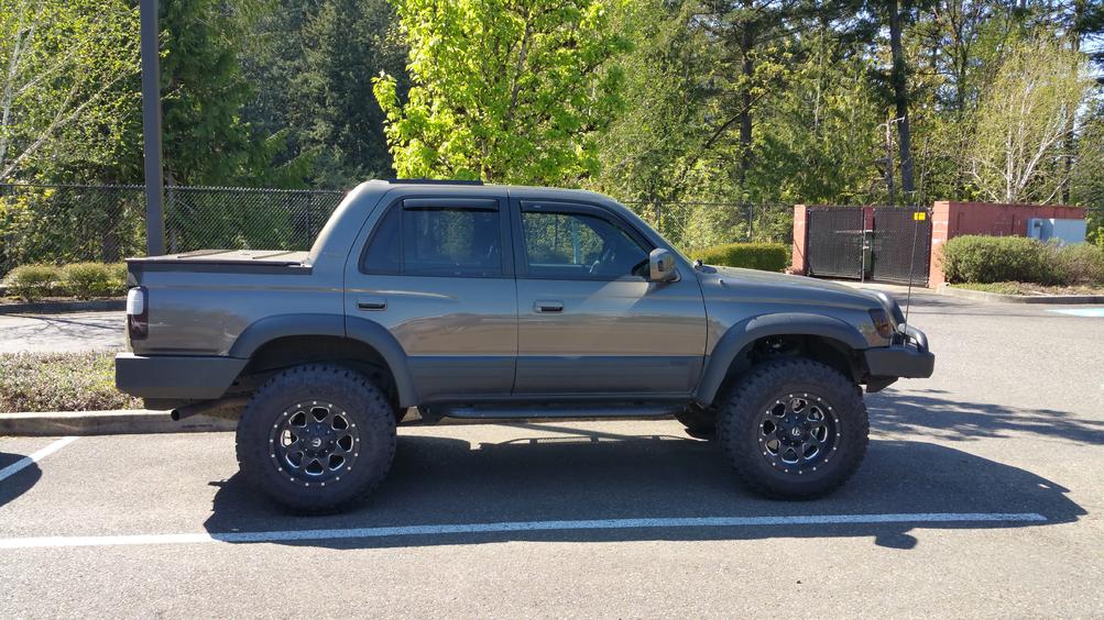

Superior Off Road in Gresham. They've done great for me and I physically can't do anything. I installed my reservior transmission cooler and worked on installing new 5.29's in my father's rig and by the end of the day I couldn't walk.. Been in bed for the last 3 days straight and finally able to start move again really slowly. Back to the lift, hehe, If your interested in getting it done from them send me a PM and ill help ya out on a deal.
Pictures -
This weekend I have to replace my differential fluid, but i'll have to get my Dad to help or maybe my 6yr old son to do it....If you want closer pictures let me know and I'll snap some tomorrow.

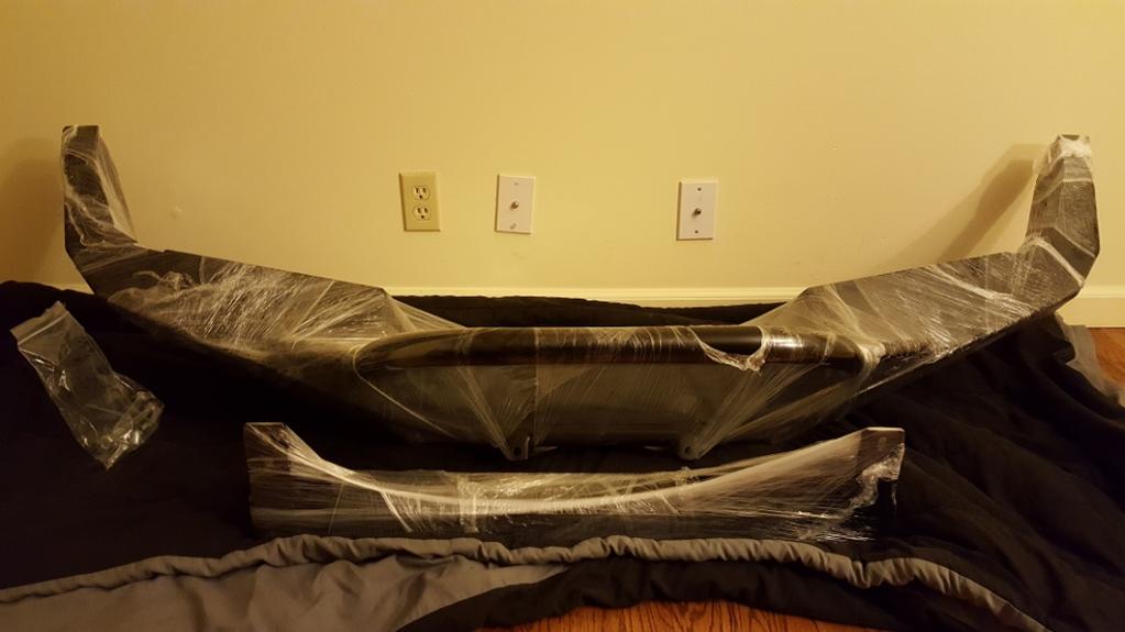

So the FedEx guy dropped this off this morning. Getting some area PC pricing at the moment. Been looking forward to this sine March.

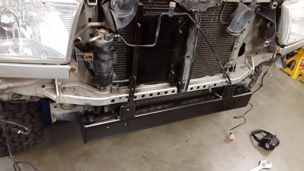

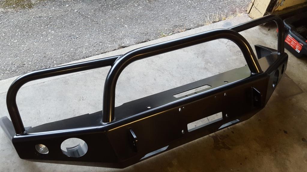

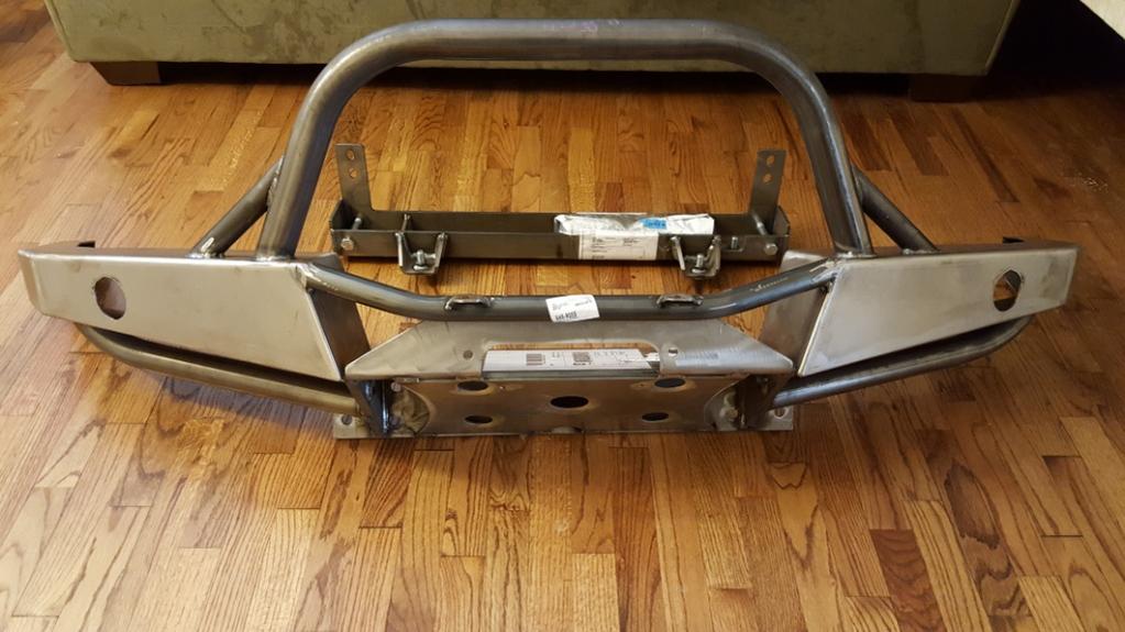

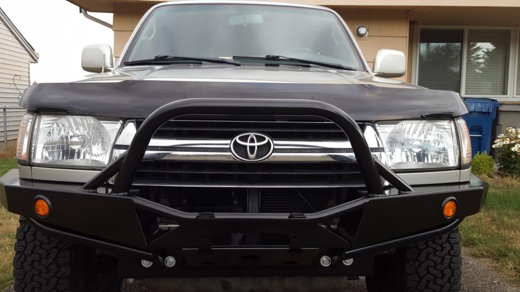

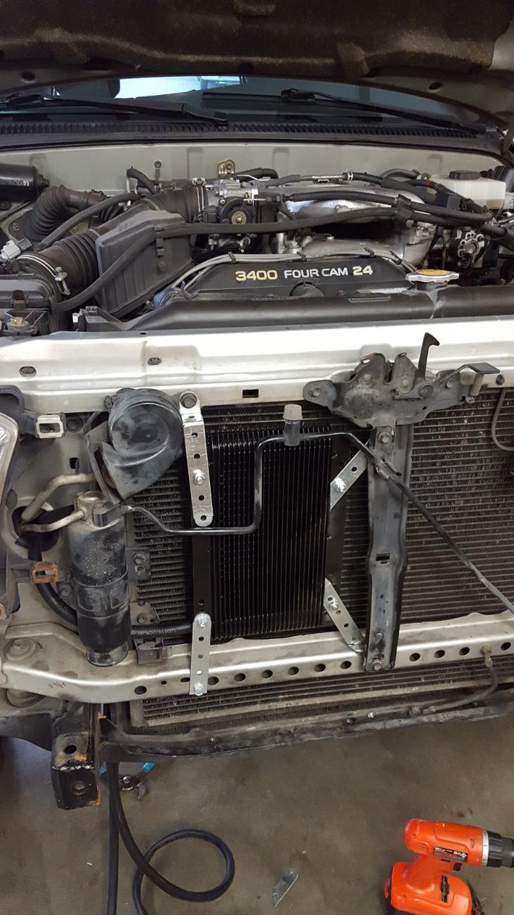

Process AOR front bumper and B&M 70264 trans cooler installed.
Ahh... it's taken a minute, but I feel like I am moving forward. My friend and I knocked out a bumper swap. Shrockworks off, Addicted Offroad on. Trans cooler installed. Goodbye pink milkshake. Oh, and stone/bug deflector mounted back up. I will also be getting around to putting the Shrockworks bumper up for sale at some point. Anyway, it feels good to move forward a bit. I have been pretty busy playing shows with my band so I haven't been able to catch up. We did play a gig in Port Angeles last night. Besides being a ton of fun, I forgot how pretty it is out there on the Peninsula. I need to head out there more often.

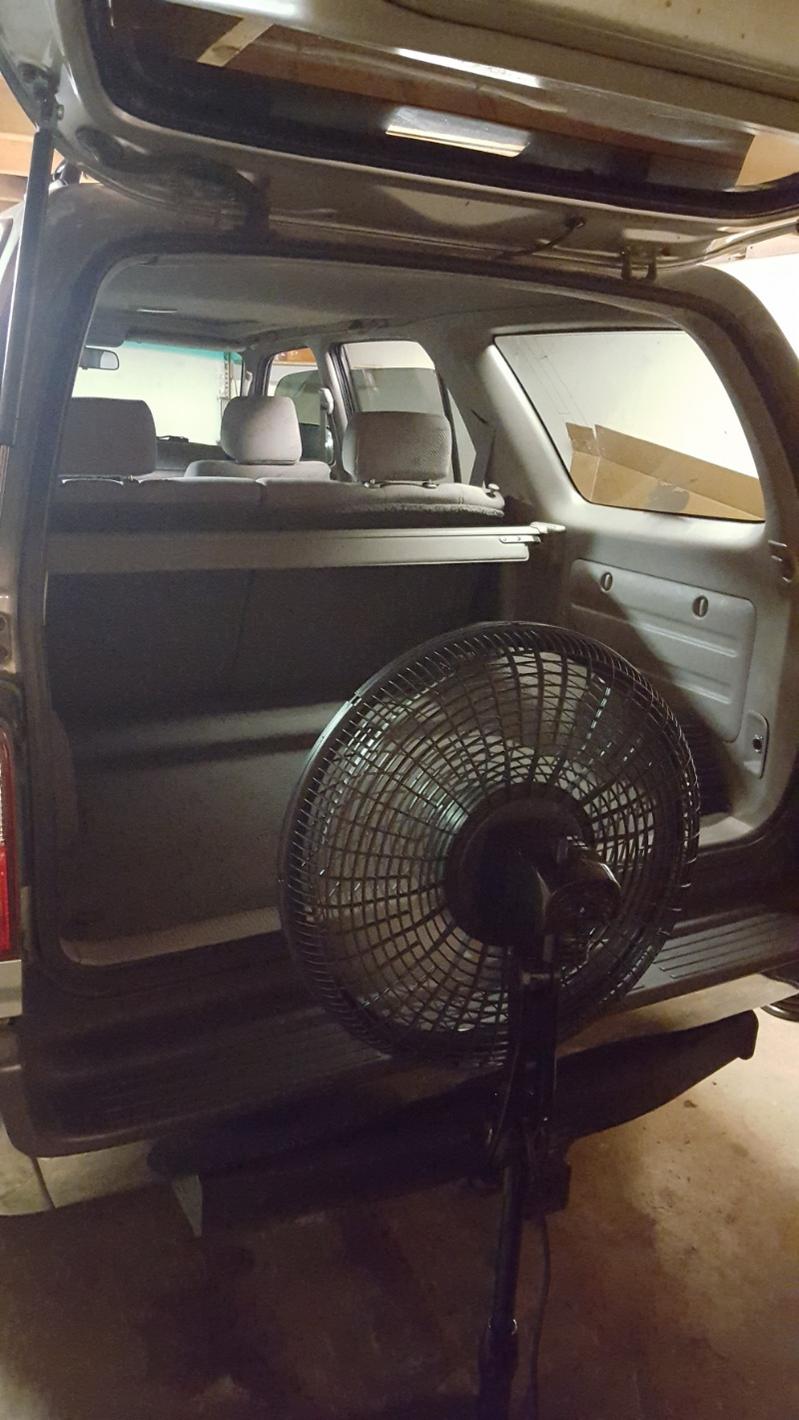

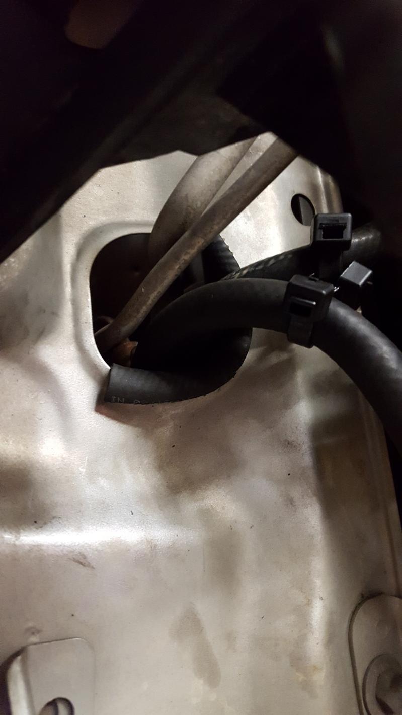

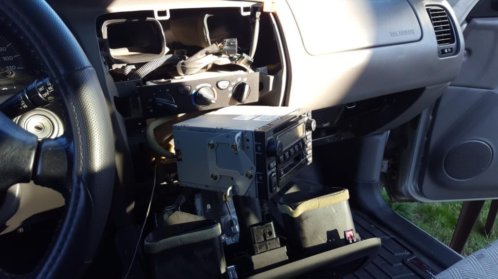

So after a little weekend mishap with a leaky cooler, I realized that I needed to get in there and see if there was any water under the carpet and pad. The first night I wasn't able to address it, nor did I realize how much water had spilled. Now I ripped it all out. It is dry, but the pad smells like ass. I figure that I can just get some replacement pad and cut to size.
But for the rear carpet that was removed that will most likely be a different story. It seems to be complicated by the composite material that is the seat backings. The carpet wraps around it. I feel like if it didn't do that I could just wash it and let it dry. So I will have to research that a bit.
I also found a cheap-o electrical mod that the PO did to hook up trailer lights.there was one thing wire that had a piece of the insulation exposed to bare wire. It looks like this was run from the cigarette lighter socket on the right, under the rear plastic cover guard, to the little grille on the left. Way to go... for now I put some electrical tape around the exposed bit and called it good.

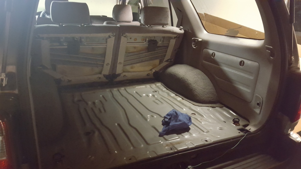

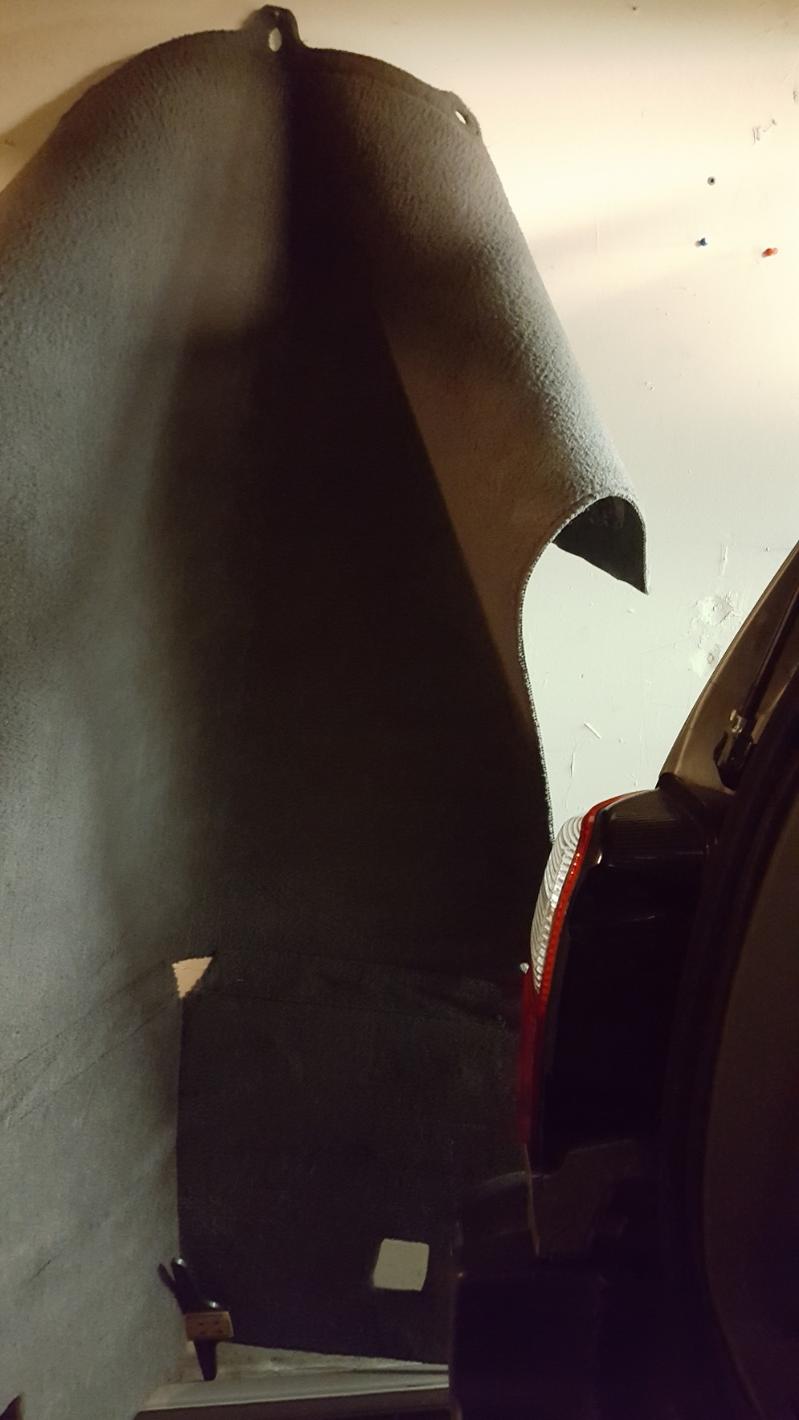

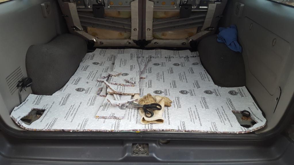

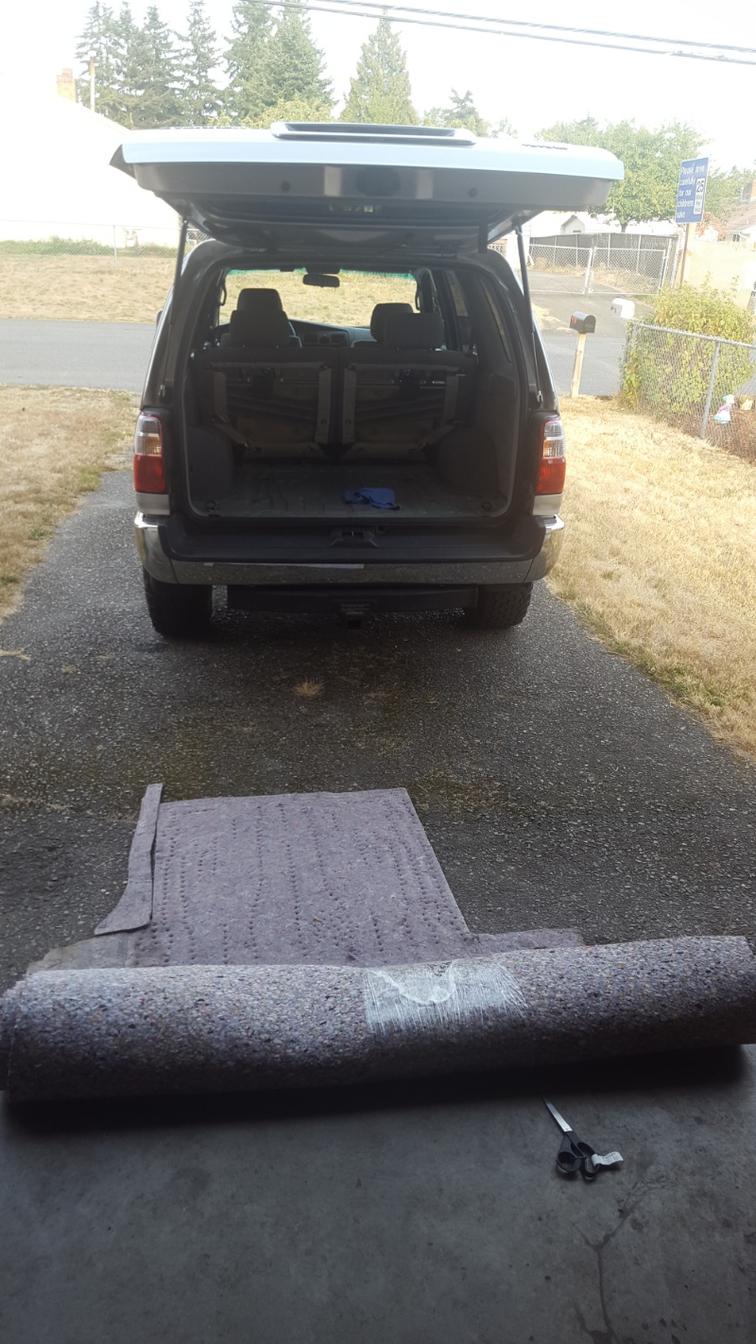

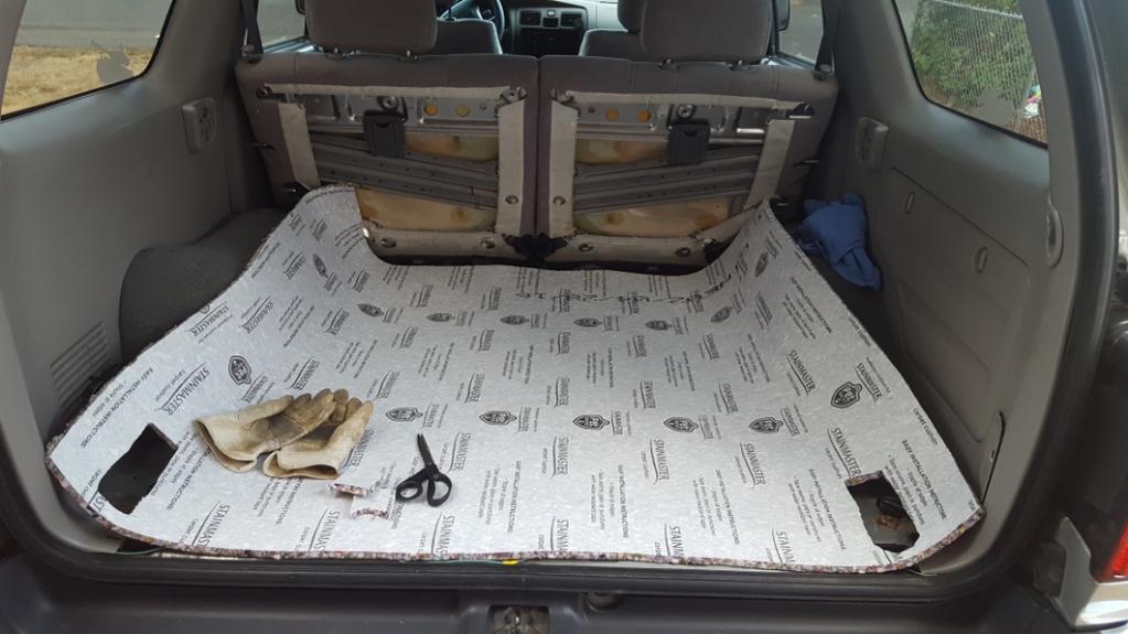

Ok.. so I decided to take up the cargo carpet and see how the padding looked. Not good is the answer to that question. Not so much look, but smell. I don't think this was all my recent mishap with water from my cooler, but the padding had a pungent stench that smelled like wet dog, cigarettes, and mildew.
So out it all came. I have a bit more to do, but I did go to Lowe's and pick up some stain master padding. Basically it's like normal padding, but it has a moisture barrier. I figured a little extra protection never hurt. So I cut it down and sized it a bit larger than the old standard padding . I want to scrub down the rubber mat that goes under the padding. So that's all fairly straightforward.
Now... I just need to be able to clean the rear cargo carpet itself. It is not as bad as the padding, but it is no bed of roses either. LOL. I was going to bring some cleaner to a car wash place and scrub it down, pressure washer it, and let it dry in the sun. But, I am also thinking about borrowing a Rug Doctor type carpet cleaner. The issue I see that complicates cleaning is the board backing that is attached that goes behind the rear seats. Otherwise I'd be tempted to find a large washing machine to shove it all in. But I think I will end up having to take care not to get that portion wet.
More fun to follow.

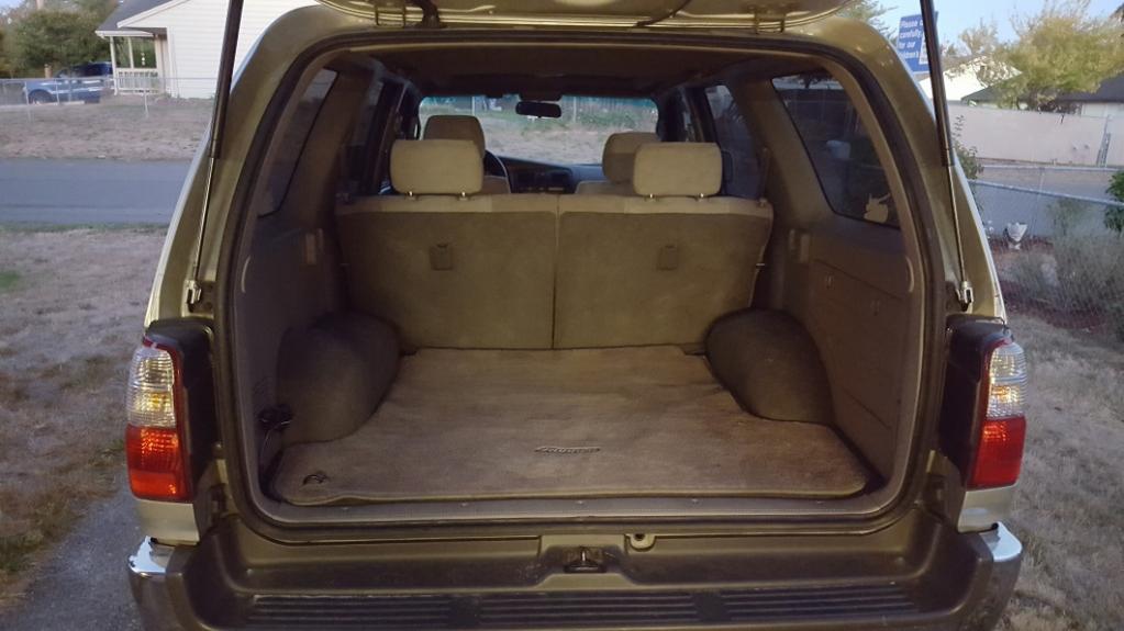

I also reinstalled my rear cargo carpet the other day after getting rid of the smell.

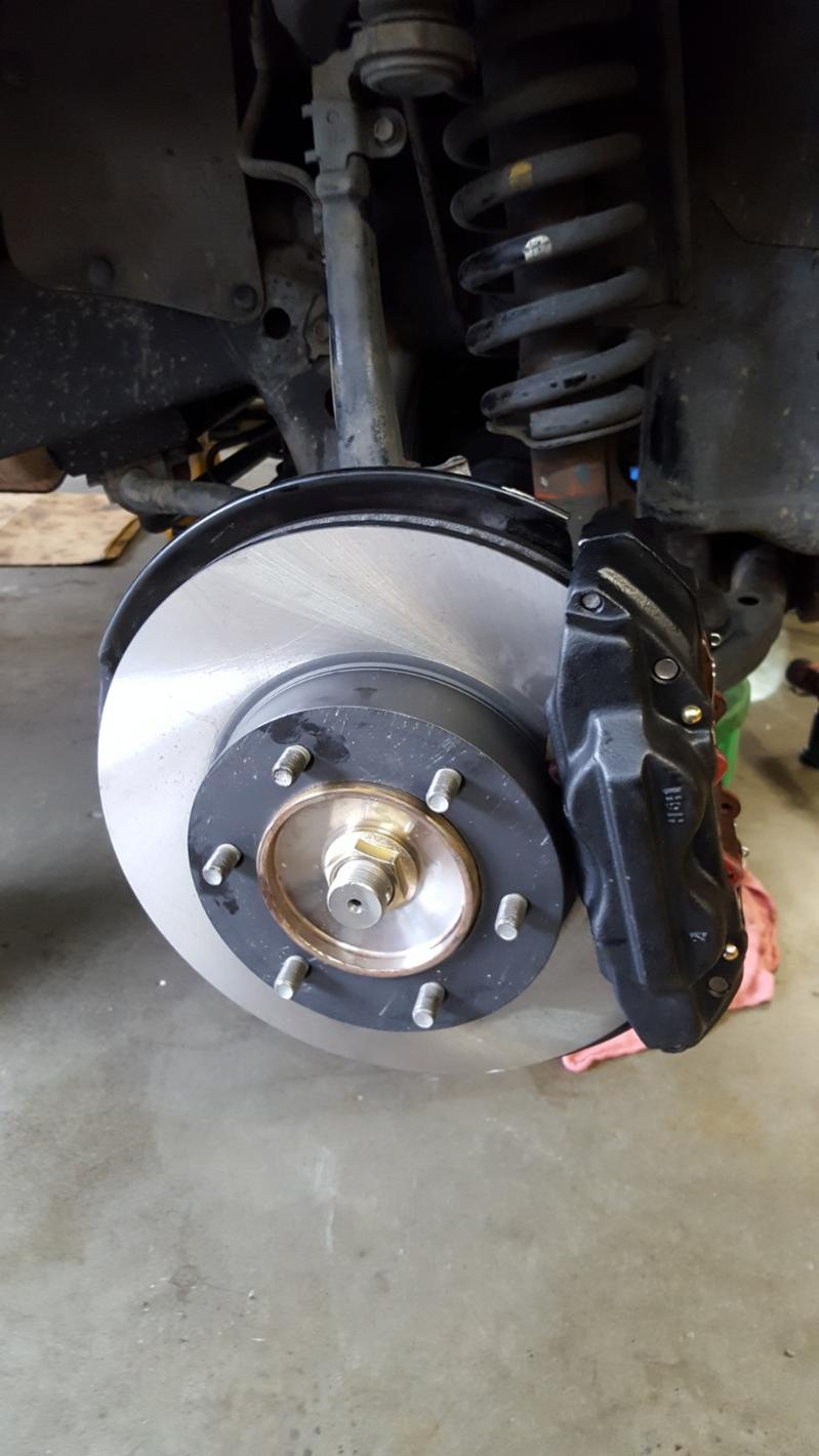

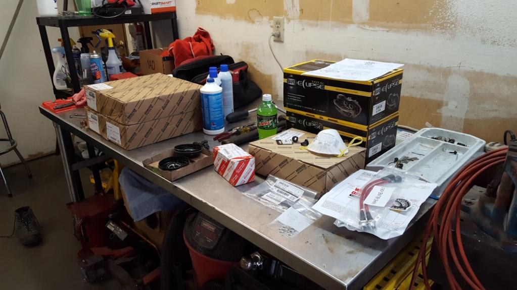

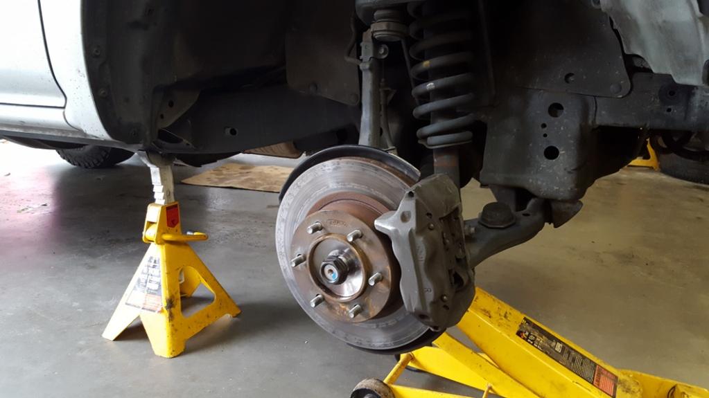

Update time...
With the help of my friend I managed to knock out my TBU using OEM rotors and pads to go along with Napa Eclipse calipers. I also swapped out my old front brake lines with braided SS brake lines from Wheelers as well as throwing in some new Napa CVs. I changed the front differential fluid to Valvoline 75-90 full synthetic.
I took advantage of Napa's fit it in the bag for 20% off on the calipers, CVs, and fluids. Oh! And a 36mm axle nut socket.

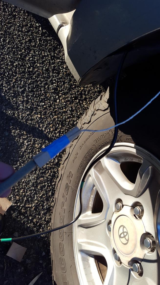

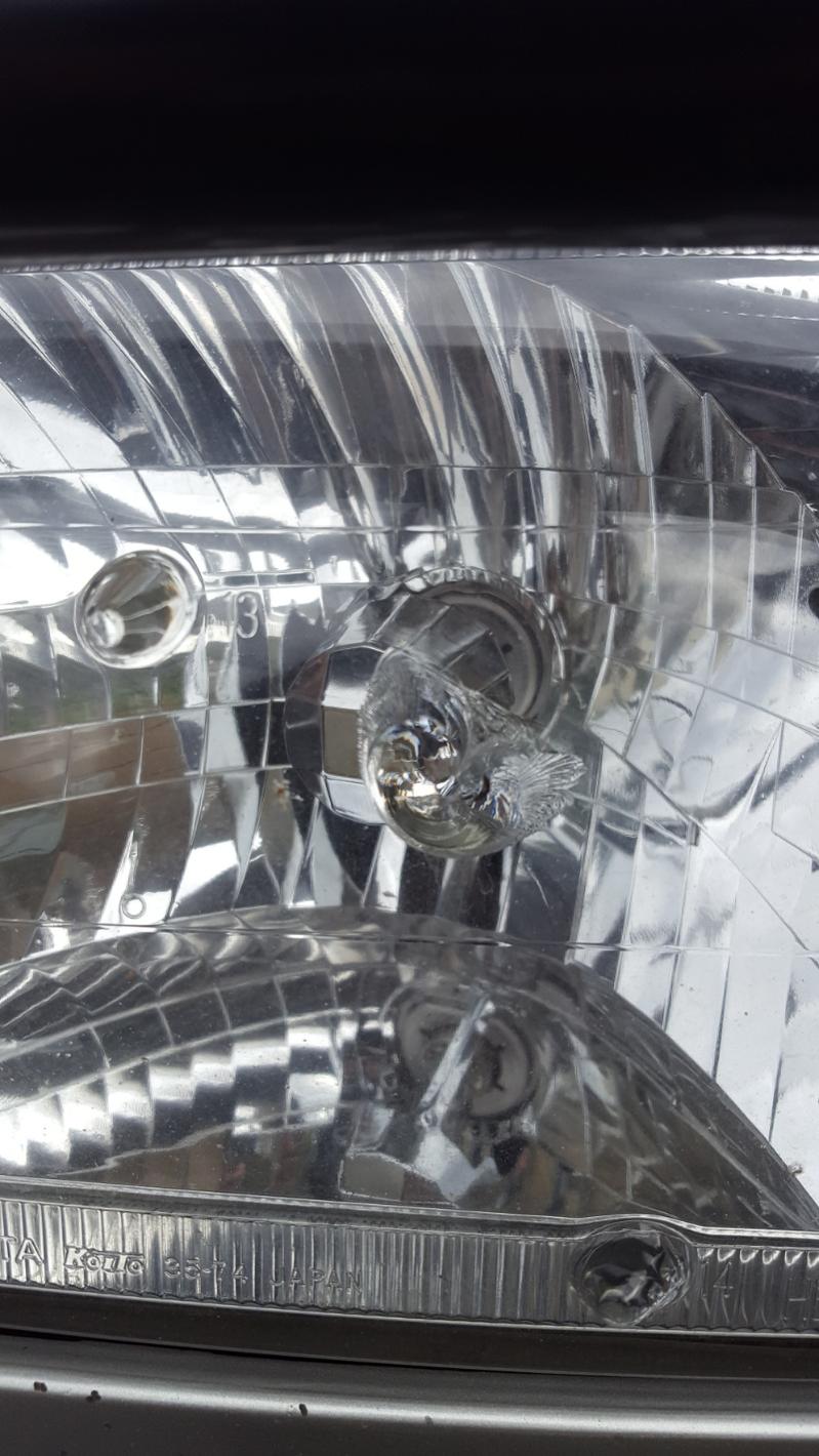

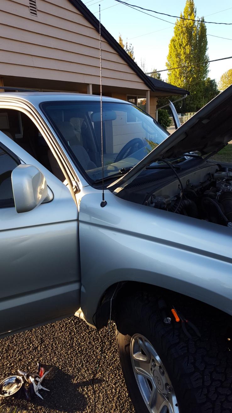

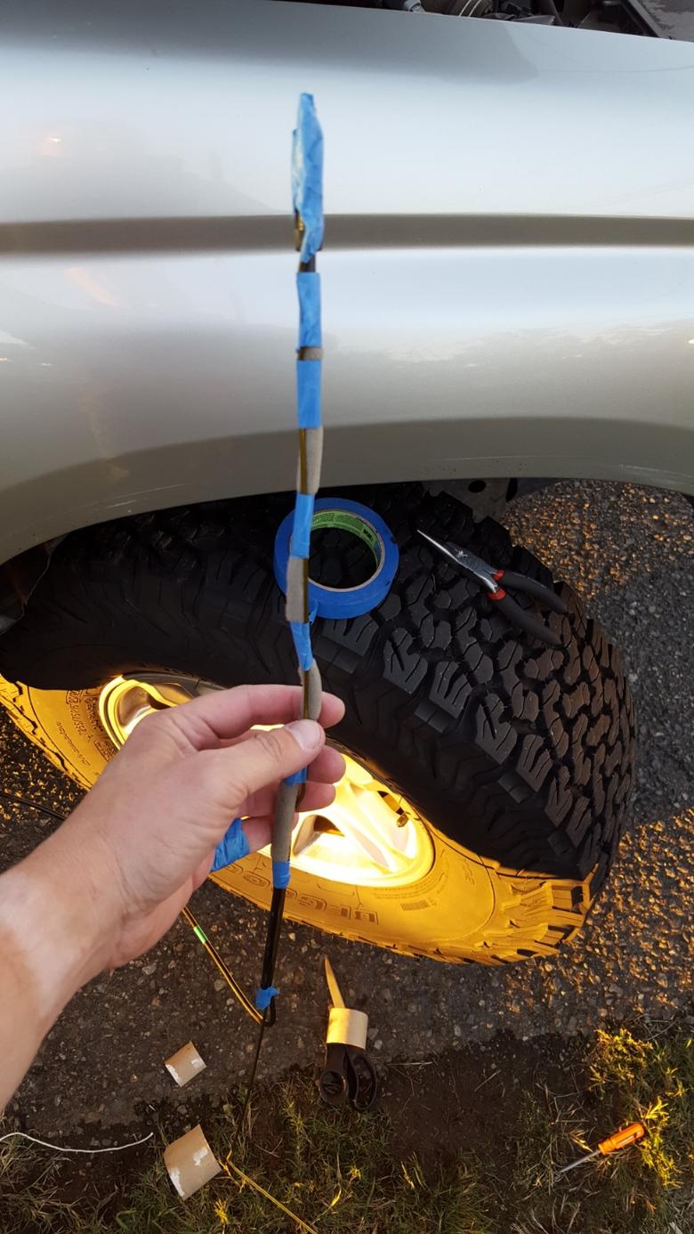

I gave the Tacoma whip mod another shot and went down in flames. I was successful at removing the dumb broke-ass mechanical mast and assembly. I got the whip mounted. Then I ran into problems. I read about the PITA that is guiding the new antenna wire back to the back of the unit. So I read something about someone who tied a string to the end of the old jack before they pulled it out to the fender. Ha! No problem right? Sounded smart as hell. It started off well. I even rigged up a little cardboard splint out of a TP roll to keep the lead straight coming back through.
Well.. somewhere along the way the jack took a left turn at Albuquerque and the string got severed. Fan f****** tastic. I tried using a coat hanger to attempt to guide it blind to somewhere I can reach it and guide it through. No dice so far. I will try again this weekend.
I might start some How NOT to videos.
