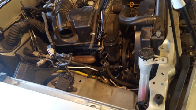

Big shout out to [MENTION=124101]Chim[/MENTION] for the hook up on a non cracked air filter intake box, and a non rusted trailer hitch! Man, he has a beautiful 4runner! But now I feel like I want to upgrade to 285s and get a rear swing out... So... thanks for that. lolololololololo. It was cool to connect with someone cool from the forum.

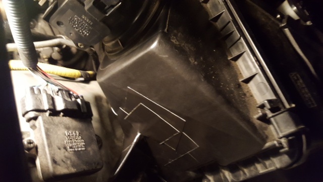

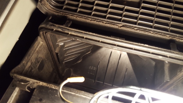

A few weeks ago I noticed that I had cracked my air box somehow and it was bugging the crap out of me. I only noticed that it was broken when I was changing air filters. I temporarily fixed it with duct tape. But that kind of fix does not set my mind at ease.
So today I had time and enough weather compliance to swap themy out and clean the MAF while I was at it. Now I can breathe easy and obsess over when the next big tire sale is. Usually Discount Tire Direct on ebay runs a October and March sale ($100 off per $400 worth of tires) so you can get $200 off per set of 4 if you are a jedi. But so far, these aren't the sales I am looking for **waves hand**
I think I will save my fuel filter for tomorrow.
