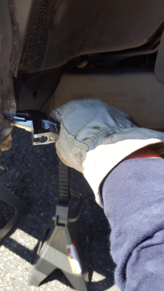

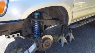

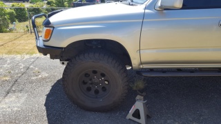

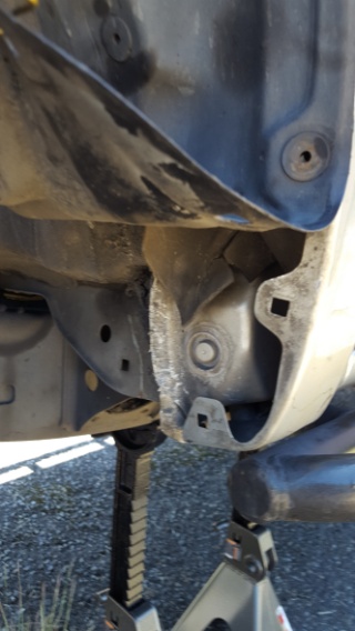

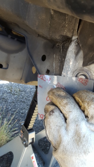

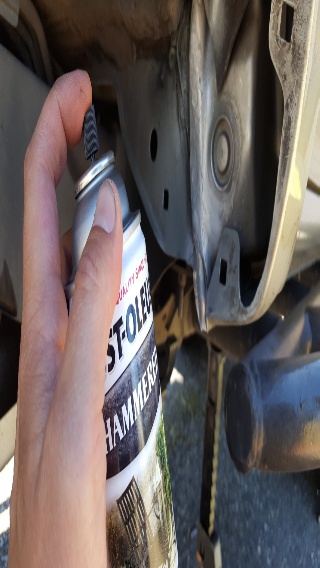

Pinch weld fun.

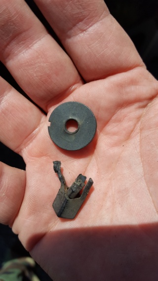

Worked on my pinch welds using Unners write up as my spirit animal. I got the welds bent, then pounded, sanded, primed, and painted. I used a heat gun to try to mold the wheel liner to give more clearance.
I learned a small handle 2.5 lbs. Hammer was a bit light for pounding. I learned that those dumb plastic retainers break, and are evil. And I think I still need to fuss with the liner because I need to secure it out of the way better and get some more retainers to lock it out of the way.
I'll be that guy and ask. Do they rub still? 33's are in my future too.
Ha! For me, yes. I think this will be easily remedied once I get a proper alignment using my SPC Light Racing UCAs vs. Just a simple Firestone alignment.
Excellent! I have SPC UCAs waiting on the parts shelf. Looking forward to an update on how those arms and an alignment help with rub.
Right on. These SPCs offer a lot of adjustability, so they should be able to bring the wheels forward enough to clear just fine. A lot of others have run this set up, [MENTION=112927]Big Fish[/MENTION] All Day runs SPC Lucas I believe as well as similar wheels with the larger 295 KO2s.. Actually... I think he has a .5" or 1" BL... But still, it should be fine.
