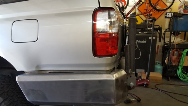

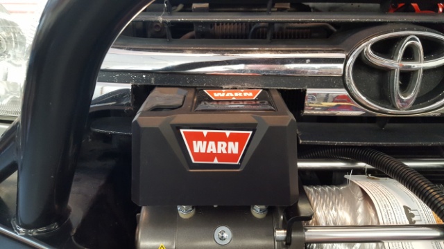

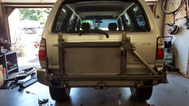

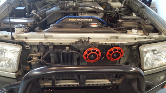

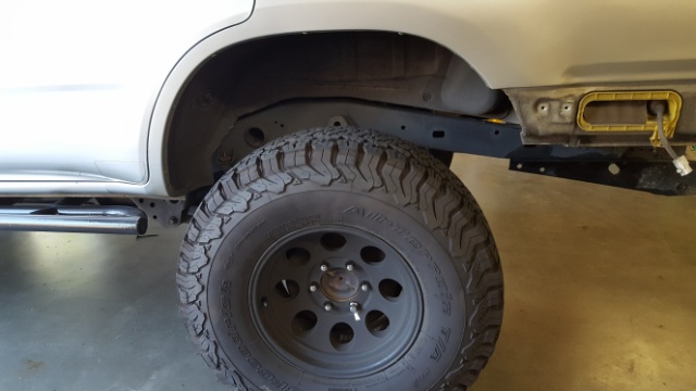

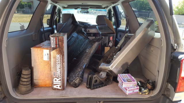

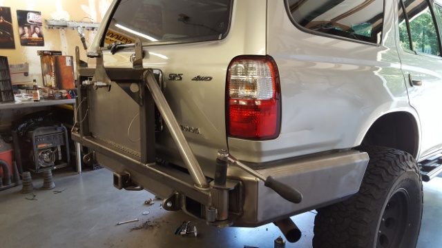

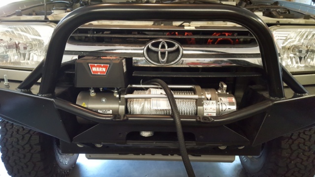

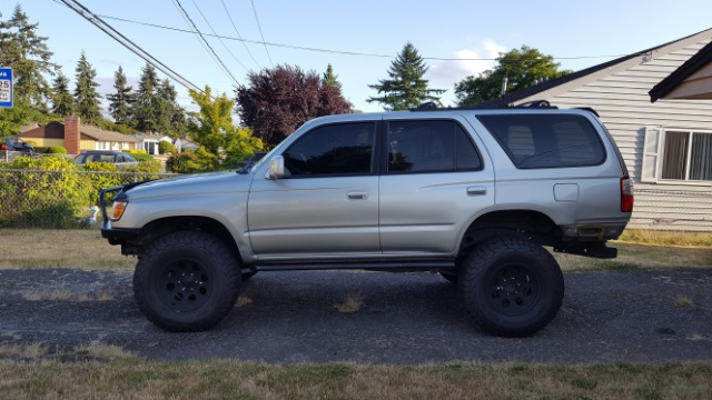

Update 07/15/17. Whoohoo!!
So, I loaded up my truck full of parts and headed over to my buddy's place to see what all we could get done.
-4X Innovations rear swing out test fit, done!
-Sonoran Steel solid rear body mounts, installed!
-OME 861 rear springs with cones, installed!
-Hella Supertone horns, installed!
-Warn m8000 winch, installed!
-Fuel filter, changed(OEM)!
Bumper will be dropped off for powder coating Monday morning. I still have a few things to do for next time. I was going to add a Blue Sea fuse box to clean up my electrical needs. I still need to mount my ARB twin air compressor, (probably rear cargo storage, 99% sure), as well as mount my PIAA crystal ion fog lights up front.
I want to if the added weight up front and the weight of the rear bumper changes my overall height. I may crank up the front coils a bit. Once that is done, I want to find a REAL alignment shop that can incorporate my SPC Light Racing UCAs into the mix to ensure better wheel travel clearance and kick the tire rub to the curb.
Well... that's about it for now.
Oh... That 4X Innovations bumper was NOT fun loading up by myself this morning. Maybe I should have had a V8 today.

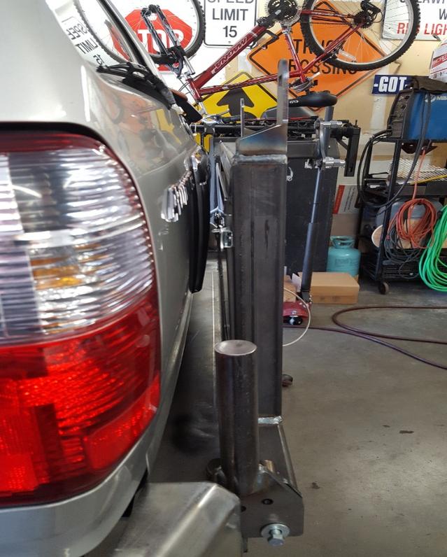

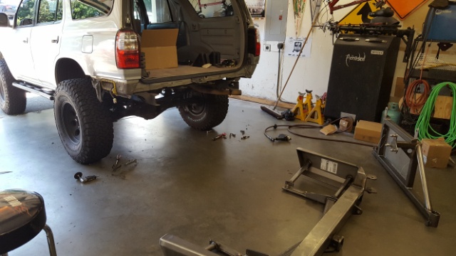

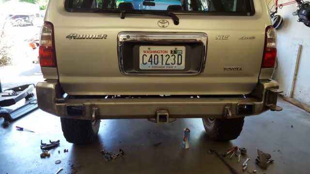

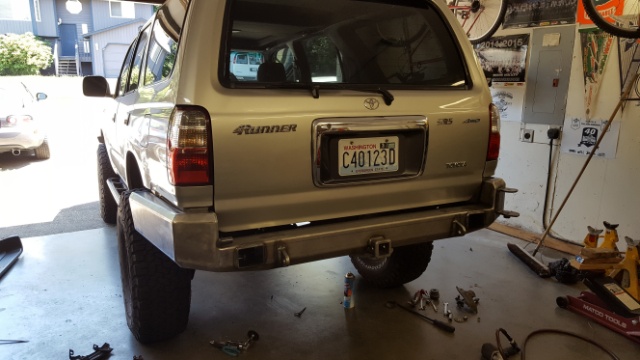

More install pics.
The only damage I saw to the bumper was one of the small butterfly latches got bent in shipping, as well as the table hinge got a tiny bit tweaked. The hinge got tapped back in place, but I may call 4X and see about getting a new butterfly table latch. This thing will be all kinds of bad ass!

Glad the test fit went well. What color are you going with the powdercoat?
I was gonna do my body mounts today but it was 104 in my garage. I passed. It's on tomorrows list along with the bump stops.
Can you get the 861's hub to fender height for me once the bumper and tire go on please.
I actually had to remove my drivers side factory horn to make the trans cooler and fan fit. It's sounds even wimpier now. Luckily, my middle finger still works. lol
You sprung for the Warn. Nice man. I'm a cheap ass and went Engo.
How many miles on that filter? Mine had 230,000 and was still working when I swapped it. The filter material actually didn't look to bad considering.
I word of advice on the blue sea box. I went with the 12+ 12- box figuring know way in hell would I ever use it all. So far I'm using 9 of 12. Get the 12 gang box. lol
Rigs coming along really well. Congrats on getting that all knocked out today.

Yeah, I am glad it worked out too. It was super nice out today. It was kind of a shame to be in a garage, but, the work isn't going to do itself.
104 is WAY to hot for me these days, lol.. I will be happy to get you some measurements once I get the bumper back and installed. So far the 861s feel fine. I have the bumper inside, but they feel smooth to me. I have the same amount if filling I left the house with tonight.
I think one of my horns had stopped working so these are JUST what the doctor ordered. I am looking forward to bringing some Prius driver's back into the real world with those Hellas. I feel a bit safer now. They make me laugh at how stupid loud they are. And that's saying a lot as I play drums in a loud band. LOL.
The only reason I ended up with a Warn was because there was pretty good black Friday sale and no sales tax.i could have stuck with my Superwinch and been happy, but it arrived all torn up and then there was a sweet sale on the Warn.
The filter, as far as I know had 215K on it. I think I am idling lower now for some reason, about 500 rpms.
For the Blue Sea fuse box, I have a 12, but I need to grab a few more items to do it right. Working on it.
And thanks for the kind words. It is coming together, slowly but surely. It looks a bit like a stink bug at the moment, but I dig it.

As for sent instructions, I didn't get actual bumper instructions, only the swing out and whatnot. But the bumper itself is fairly straightforward.
