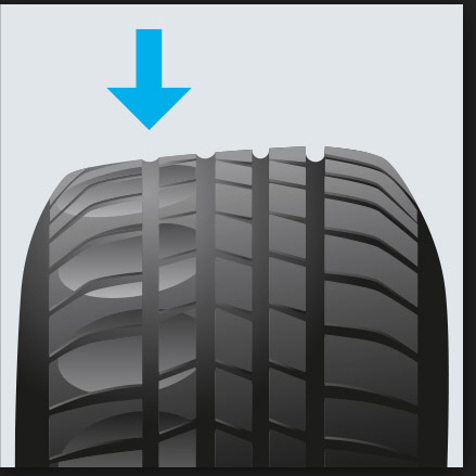

A lot! What tires? Miles? Have you felt the inner tread? More info will help.
I have no idea how many miles are on the tires. Goodyear assurance cs tripletred all-season 265/65Z R17
The front left inner tread is definitely lower than the other four... what should I bee looking at exactly?
Run your hand across the inner tread, going to other the tread. You will feel if it is "cupping" may need an alignment! Also can rotate the tires, will hear more noise wherever you put that tire.
Google will help with explanations
