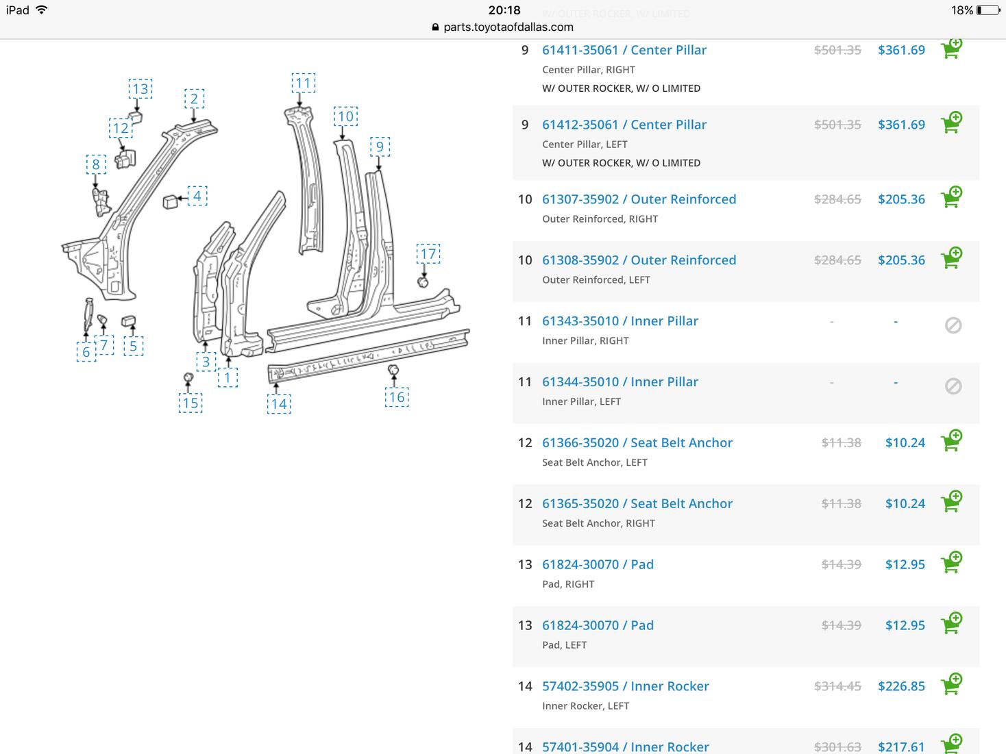

Part #9 on the diagram needs replacing, part #14 will likely need replacing as well. Just eye balling it, you have at least $5-$6000 in damage to repair on your truck to fix it properly including paint and everything.
