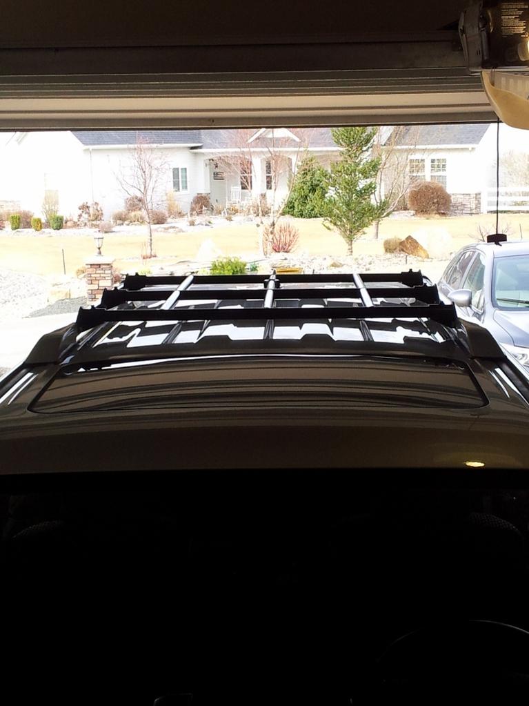

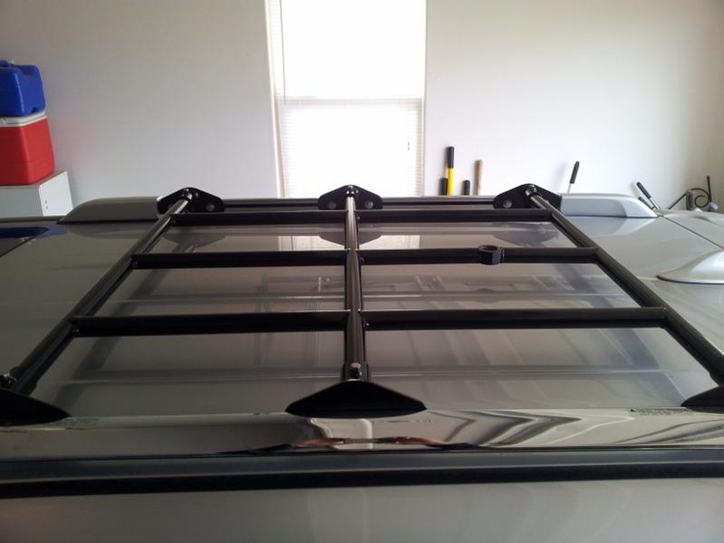

Rocky road adventure rack, INSTALLED, two people would make it easier, (I know this has been stated) not really sure how much easier maybe 30%. The included instructions are guide to look at then probably forget about, used the roof rack delete thread from this forum on how to take off the rails and the advice in this thread on going front to back (instructions say back to front, shark fin in the way:wtf:), by following these it took me about 1.5 hours by myself. The worst is the torx screws holding the rails to the roof mounts, you need a ratcheting right angle t30 torx driver that is less than an inch tall, not even sure if such a thing is made. Will post pics later.
As promised Pictures, my wife graciously gave me alittle more 4Runner time.:bash:

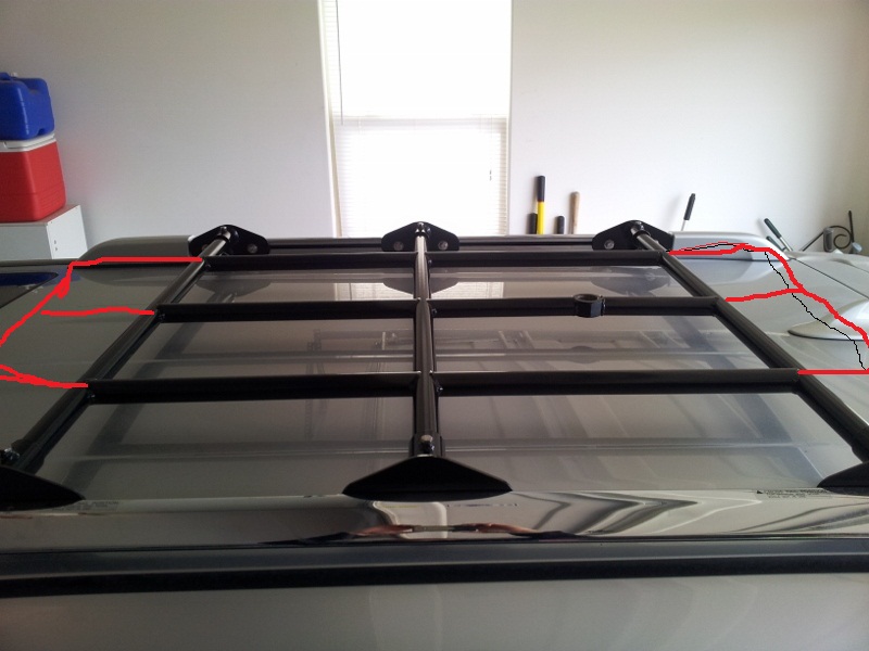

In thinking about it, looking at and now having it. This rack would be even better if they had bumped out the front and back to the exact length of the roof rails, so about 8inches forward and 6inches back. Really would not have been that hard but would be worth like and extra $50 bucks easy to me. I did some really bad doodiling to show.
Rouge1, I like your idea. Here is a possible fix, (since you already own the one you have). Order the optional "light bar" (two of them) See if they (RR) will make them for you without the light mounts, then bring your already existing rack to a local welder, have them tack weld the light bar (instead of using the u-bolt mounts) to the front and rear cross bars of the existing rack. (The areas which you indicated.) You could have them weld it at a slightly higher angle from the existing crossbars, especially the back one in order to be above the "shark fin" antenna. You will then have pretty much what you are looking for....not as strong, but most of the weight should be centered over the existing rack anyways. The additions will be for overlap large items and tie downs.....I think you had a good idea there.
