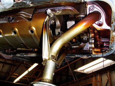

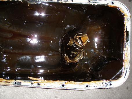

Caution: Disturbing photos
First picture is exactly what the oil pan looked like when it was lowered. :sobbing:
Second picture is where the parts blew a hole in the shield between the block and oil pan.
I was considering buying a new block if the cylinder head assembly was undamaged. No such luck...took it apart tonight...toast. Metal fragments went all through the engine. With so much damage, I still can't believe the trunk ran with no noises, just shaking. Ironically, I guess it shows how tough these truck can be despite running on only 5 cylinders with metal pieces floating everywhere.
To make it even more unbelievable, the engine was immaculate inside. Previous owner certainly kept up the regular oil changes.
