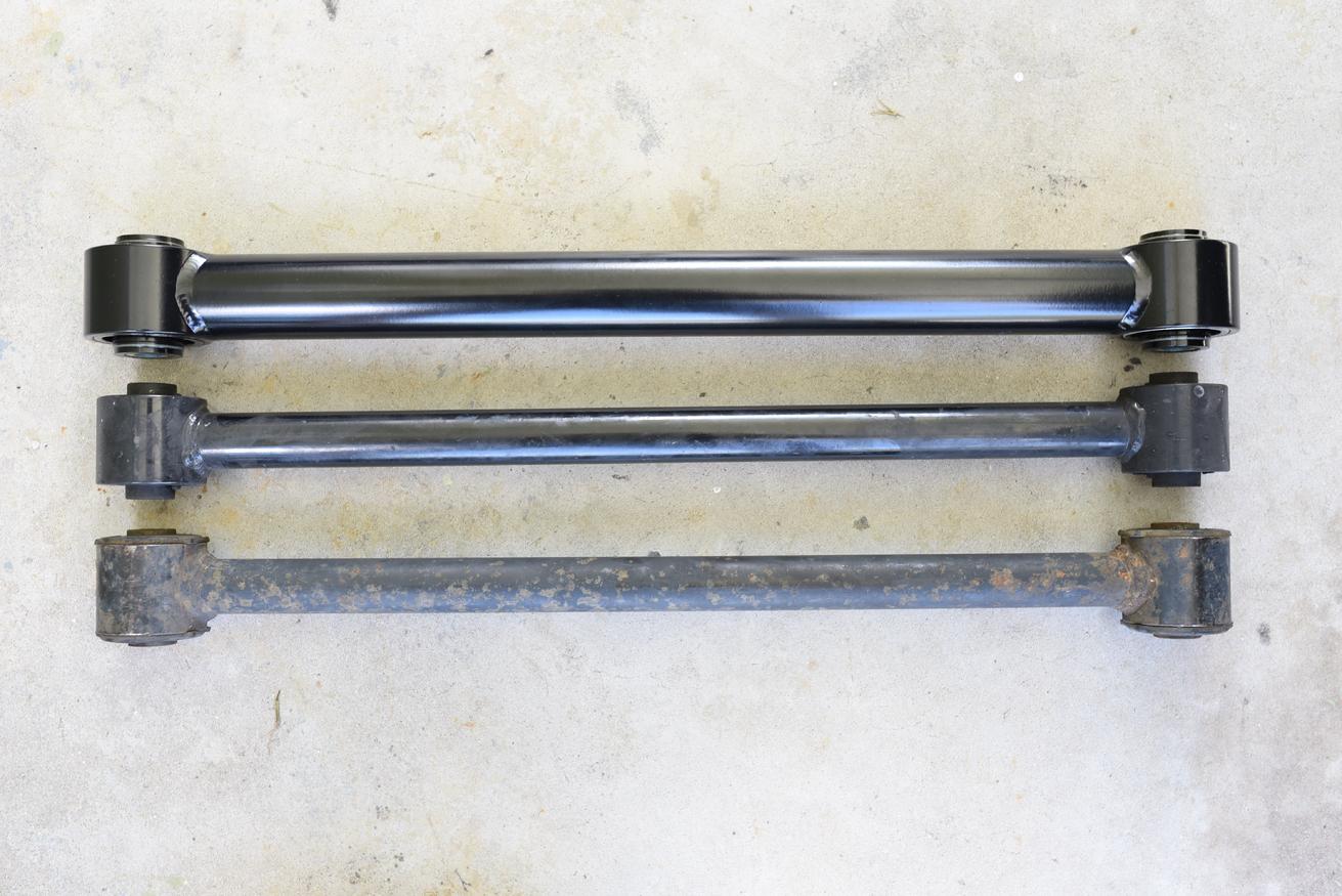

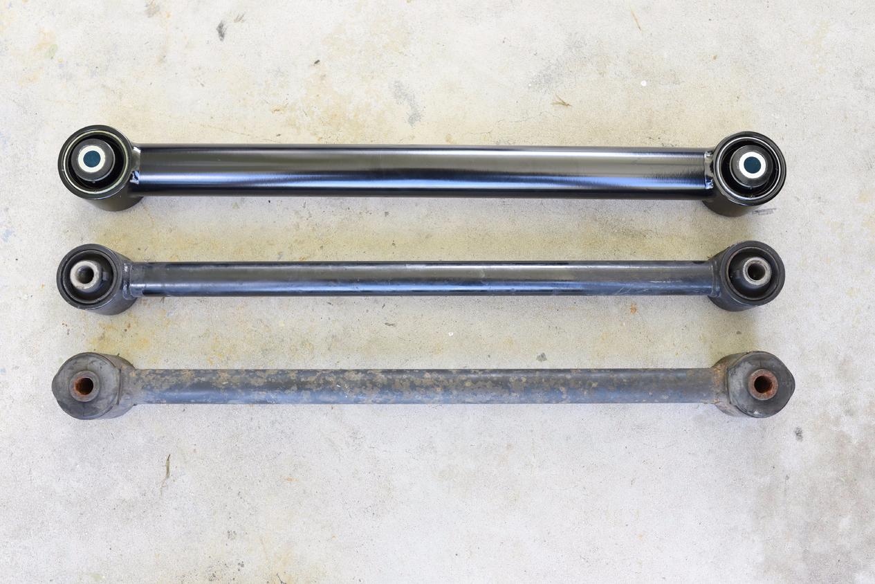

I have attached a few pic's of the LCA's for comparison purposes. The lower bar that looks to have some surface rust is my factory '96 arms. The middle arms are the Febest which I picked up on Amazon a little over a year ago. And of course, the massive ones at the top are the Rokmen Trail Series. They are very nice units that are tig welded and powder-coated. Much larger in size than the factory units and the bushing is larger than the factory as well. The bushing itself has a similar design to the latest factory bushing.
