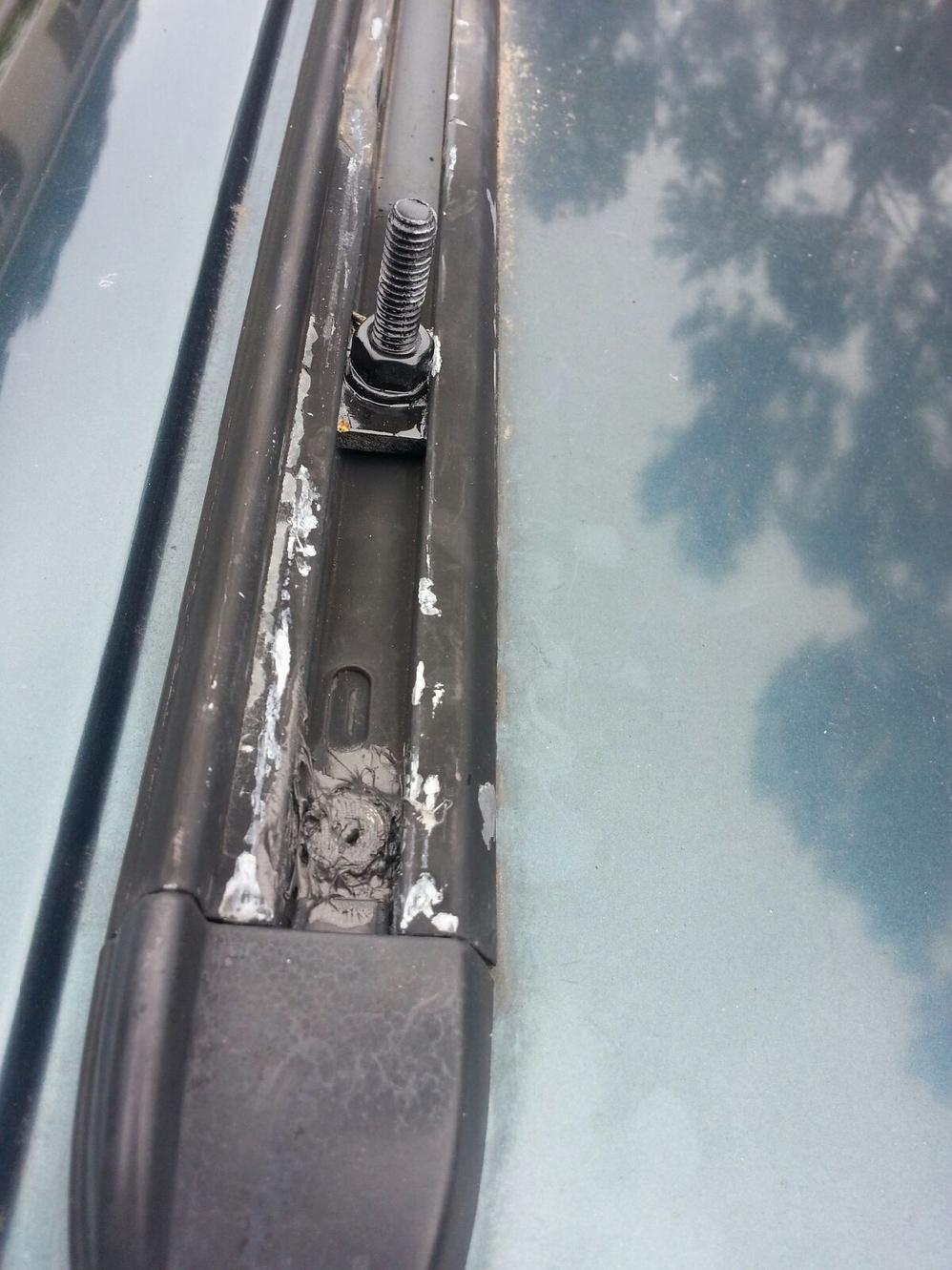

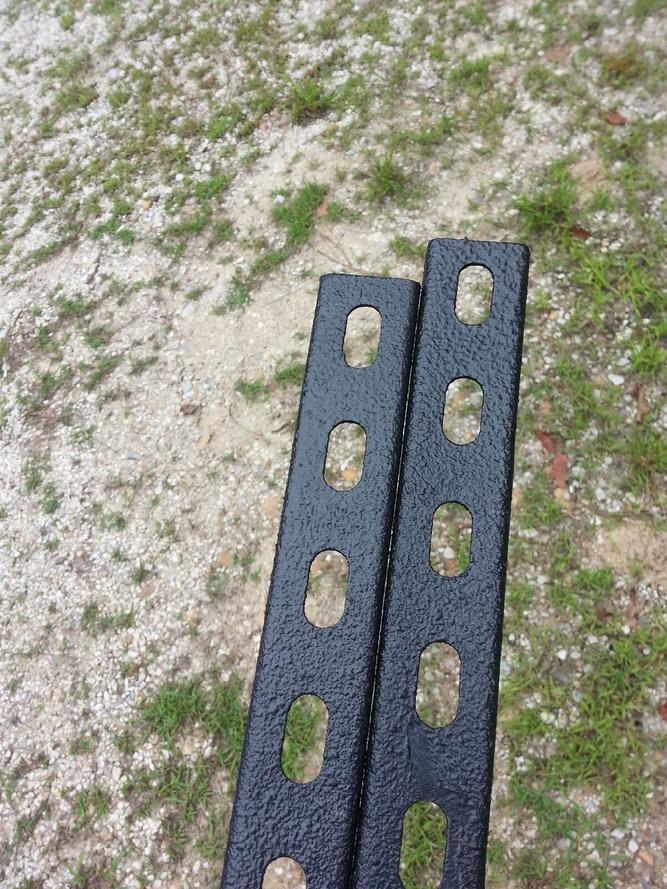

Ive been working on my Rola rack off and on for a couple months. I chose not to buy the extension but make my own from electrical conduit. I chopped the front end off the rola rack with a sawzall. It will leave a gap above your sunroof so you could access things on the rack if need be or just an unhindered view. However, I did it for none of the reasons listed above. I was looking for a custom length because one extension is slightly too short and two extensions are too long.
To bring it tighter to the roof I removed the factory crossbars and made some bolts that fit in the track. From the same section in home depot beside the conduit I used metal framing channel and cut it to length for the crossbars. It will lay across the edges of the factory roofrack tracks with about 1mm clearance in the center of the roof. I opted to use spacers I made from some thick rubber I had on hand just to clear the roof better. I also thought about putting a slight bend in the crossbars and will if the rubber spacers don't work as planned.

I mounted my Curt rack my own way, right to the stock tracks, NOT on the upper cross beams. The Curt rack was the right width to line up, for the most part, with the stock tracks.
I simply removed the cross beams completely (have to remove front or rear end piece of track, then slide out), then removed the rubber finger bolts from the lower sliding cross pieces (that sit flush on the roof).
Then I drilled the holes where I wanted, 6 total. I had to drill at a slight angle to get them where the bolt would come down into the cleats because the Curt was *just* not quite the exact same width as the tracks. I used zinc bolts from ACE, I think the longest metric they had (M6 bolts sound right?), 1.5 or 2" in length. I think they're a 10 or 12MM head, hell I can't remember. Anyway it took some doing to get them to thread into the cleats, but the finished product is the rack sits just a few MM above the roof.
I mounted the rack so the lower sliding cross pieces helped to suspend it off the sheet metal, but I also put some split vinyl tubing over the bottom tubes of the rack so that if it does flex down and touch metal, it won't scratch anything.

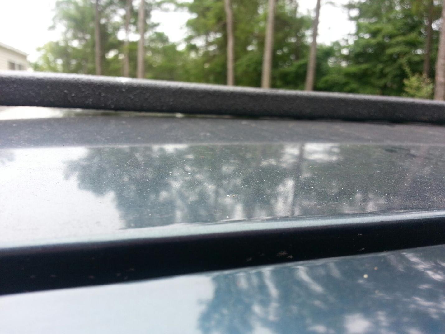

You can see the very small gap with the cross bar laid on the top edges
of the track due to the curvature of the roof. There is about 1/2" gap
from the roof to the bottom of the cross bar where it meets the track.
