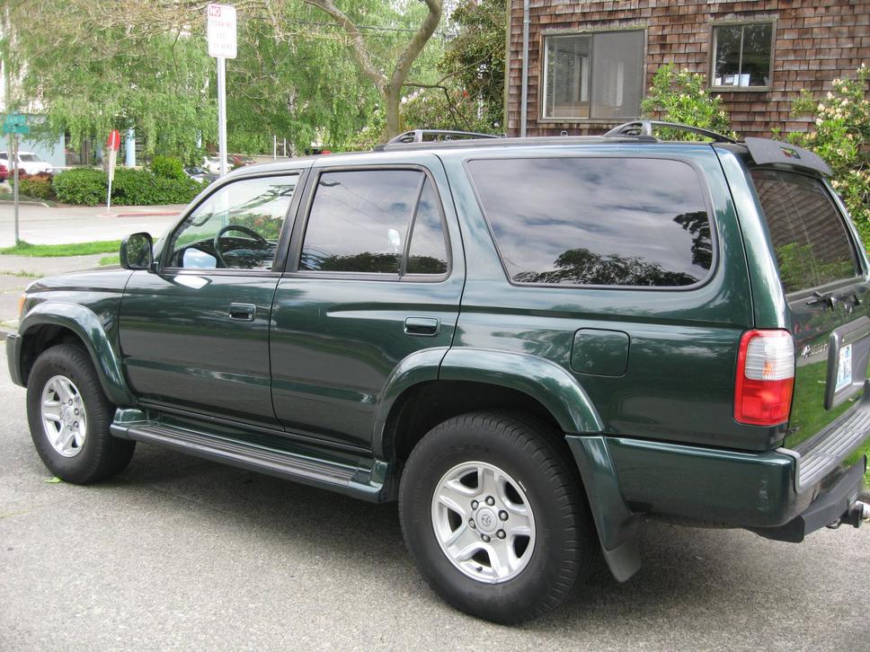

On my 2000 4Runner I have the stock roof rack that runs halfway the length of my roof. I've tried on various cargo boxes made by Yakima or Thule. The problem I have is that when I open my rear hatch, the stock rear spoiler thing tends to hit the back of the cargo box.

You had no rear hatch interference? Do you have a factory roof rack? Also do you have the factory rear spoiler thing on your rear hatch? I've attached a picture of my 4runner. Let me know if your setup was like mine.

Guys I'm considering buy a SkyBox 16 from a local guy here. Can someone with my kind of setup (see the picture in this thread) let me know if they also are using the SkyBox 16 without any rear hatch interference? Thanks guys.
