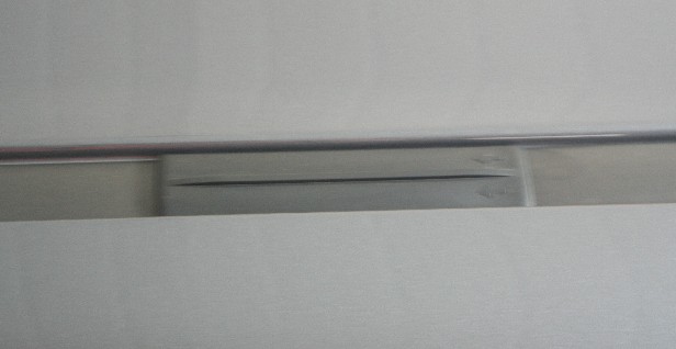

The diagram on the Partznet site looks like it might just be small front and back inserts instead of a long single piece. I looked at mine. Sure enough, there is an ~5" long rectangular insert the width of the channel. All 4 look identical. Should be a dirt cheap thing to do, especially if you can get them from a dealer who is throwing them away after putting a rack on an SR5.
Here's an upclose (fuzzy) pic of the insert:
The Toyota part number is as follows: 755 963 5030 at $8.00 each. I asked one of the services guys if they had any that were left over after a recent install but fortunatley they did not so I could pay$32 for them. Thanks for everyones help.
