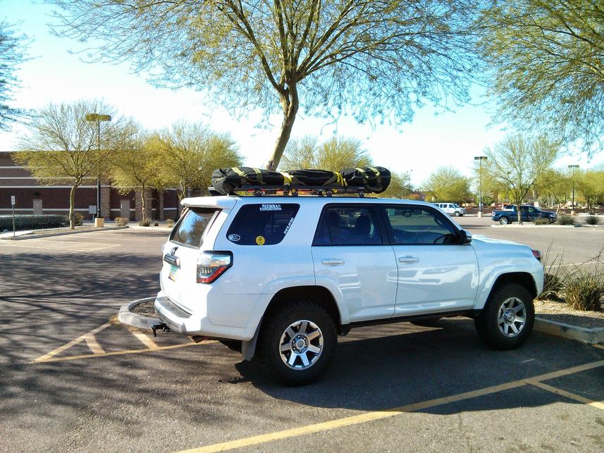

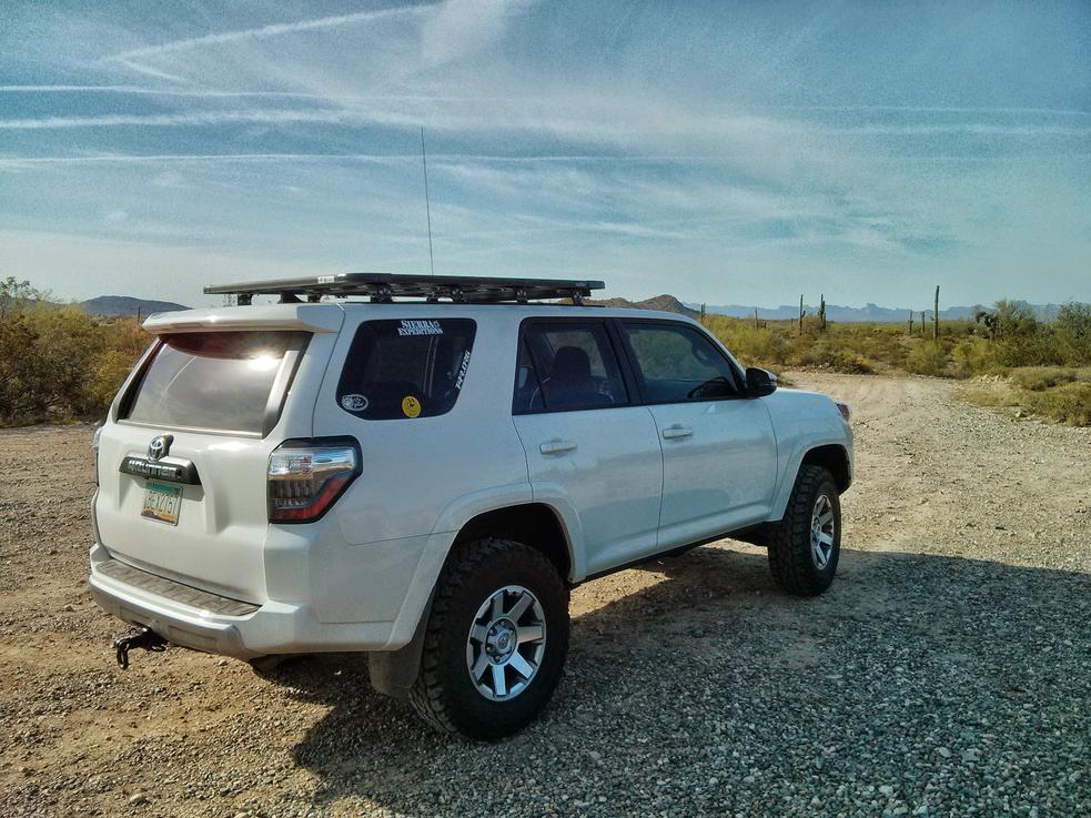

I get around 15-16mpgs when traveling up North from the Phoenix to the Grand Canyon; that's loaded down with camping gear and my OZtent on top; normal/mixed driving I'm getting around 18mpg; the K9 is fairly light and low profile so not much resistance.

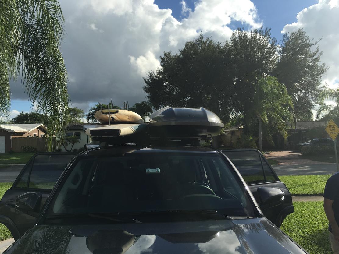

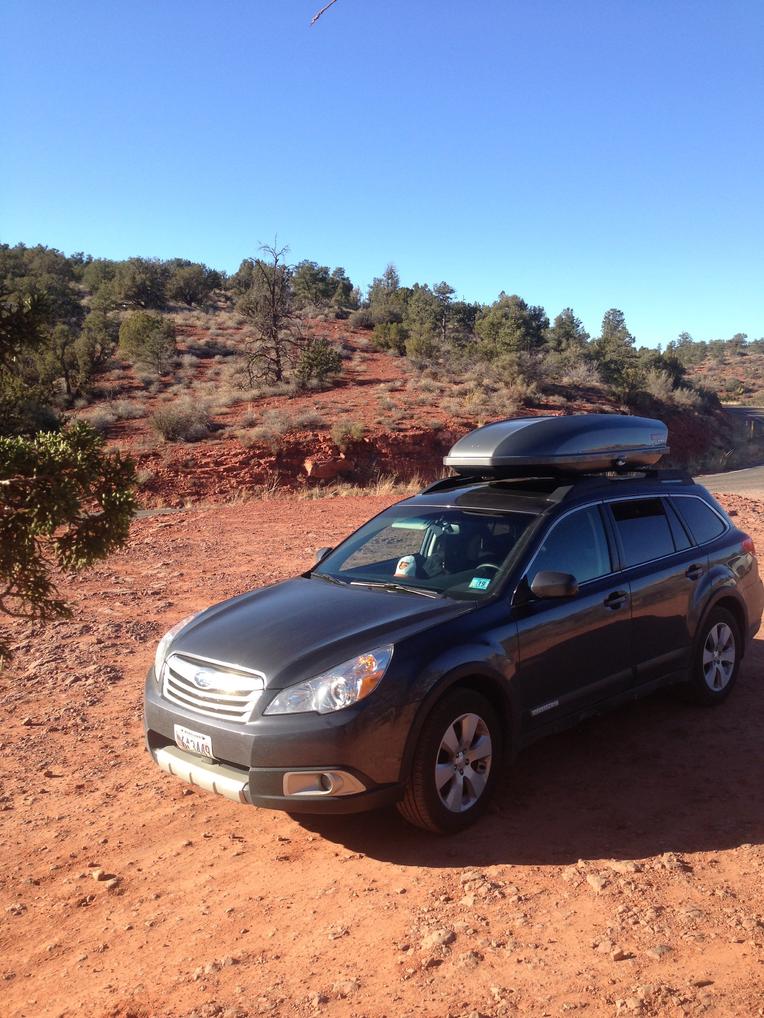

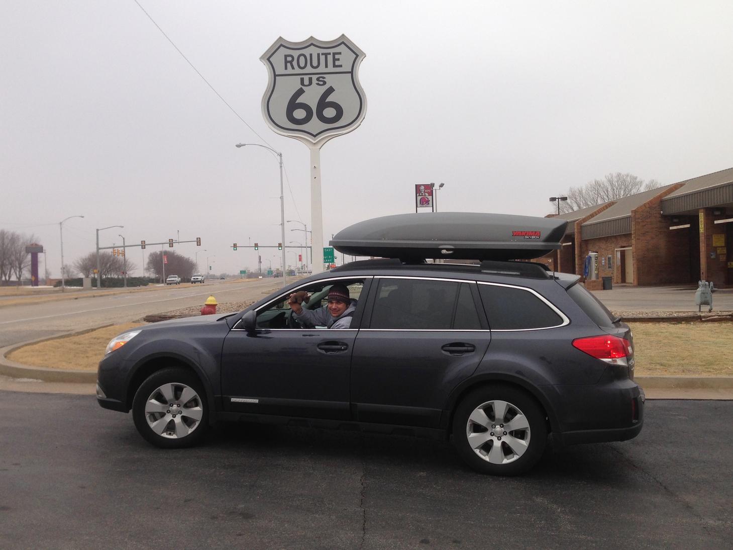

The other thing about a rooftop carrier is that they are lockable and fairly aerodynamic, so you can keep your gear stored up there when you are in more urban areas. I have a yakima skybox 16 with thule aerobars to elevate it above the "shark fin" on the back of the truck and allow for the rear hatch to fully open (the factory bars sit too close to the roof). I originally got it for my Outback for ski trips (to keep skis and snowboards out of the elements and locked on our trips) but was easily converted to the 4Runner. Drove from Miami to Maryland in December and averaged 18.5 mpg with the cruise control set between 70 and 75mph most of the way. I have also drove cross-country twice with it on my Outback and worked great.

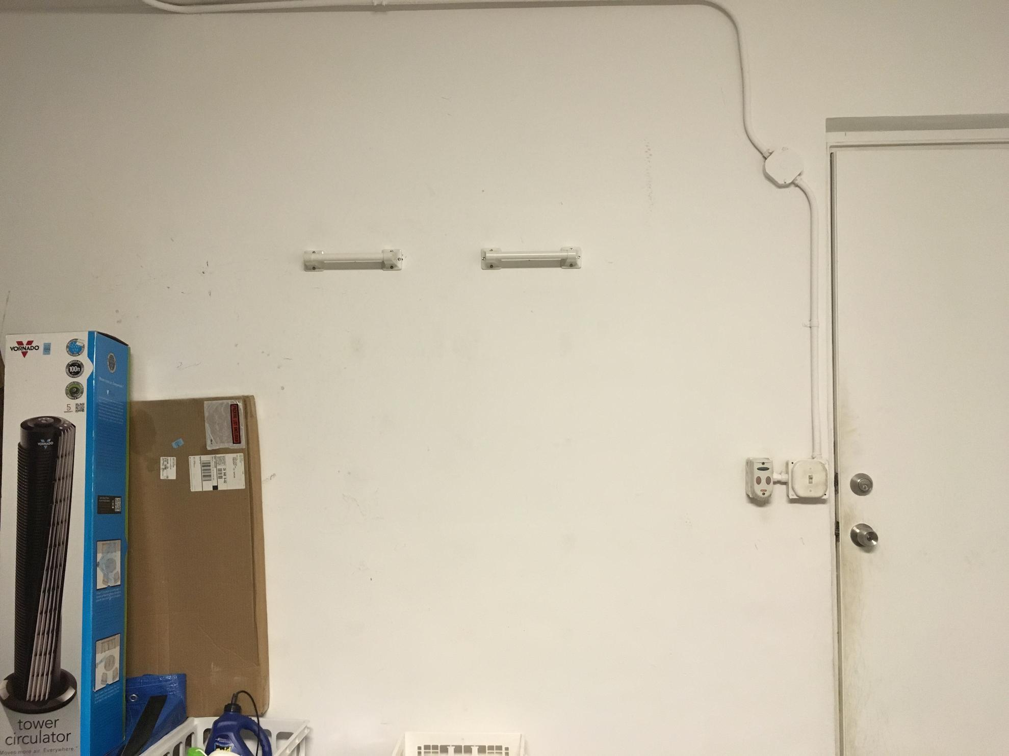

I had the same issue. Ended up buying two bathroom handicap (250 lb loadbearing with anchors) handles from Home Depot and hang it on the garage wall from the roof rack attachment hooks. I don't have a picture with it up on the wall as its on my car now but I can send you one when I put it back up next week. Here are the handles FWIW.

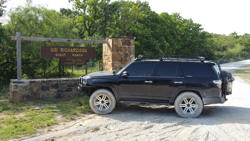

I am also running drabbits

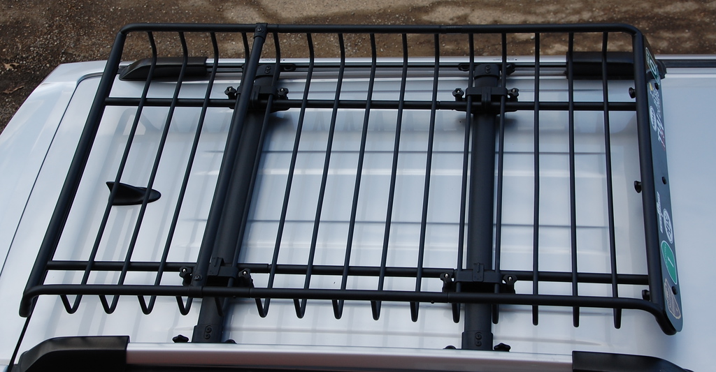

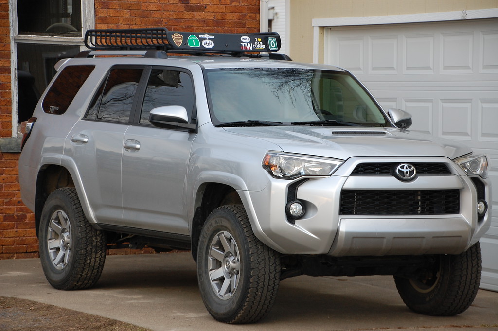

If you are not set on a Gobi but just generally inquiring, the it sounds like one of the lighter and cheaper basket / racks that is more easily removable might be the ticket for your needs? I have a Yakima basket which, once set up for the first time, can be put on and taken off by one person and takes about 5 minutes to tighten down with no tools.
I paid $300 for it, the middle extension, and the locking mounts on CL.
The Yak still fits (with 1/4" to spare!) in my garage (2.5" lift and 285s), but I take it off when not in use just to keep it from rusting, and I hang it from the garage rafters using 4 bicycle hooks. If 10 months out of 12 you aren't going to be using it anyway, no point in leaving it on all the time, and no point in buying a high dollar unit whose construction pretty much necessitates leaving it on all the time.
Downsides, it's not full length like some racks, it's not as cool as a Gobi or whatever, and it can't support a RTT (which I don't care for anyway, so no loss for me).
Upsides, cheap, easy to install, lifetime warranty, easy to find on the used market, hauls your specified load (100 lbs of boxes) just fine, no obvious MPG change (empty), elevated sides make it easier to secure gear.

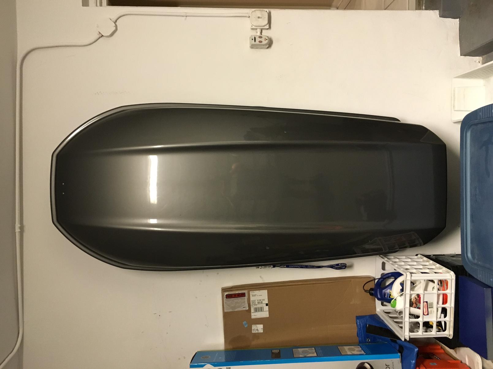

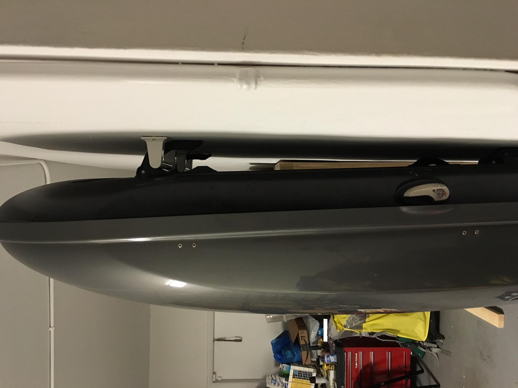

I know you probably already decided to go another route but I mentioned I would post pics of how I hang my skybox in the garage with $30 worth of handicap bathroom handles (with anchors rated to 250lbs).
Sorry for the sideways pictures, haven't learned how to rotate after uploading.
