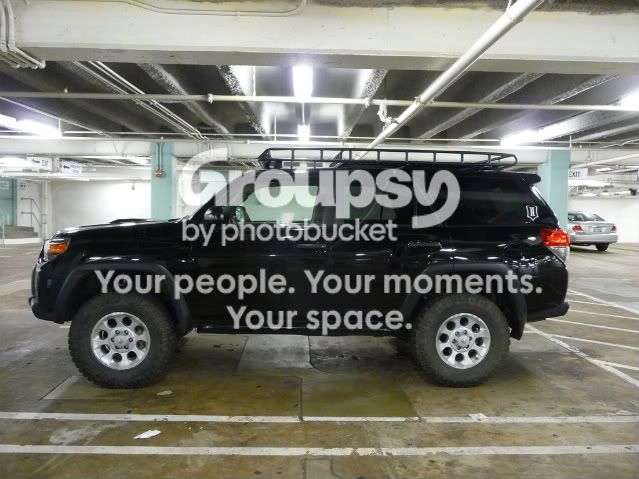

I've been thinking about a RTT but I need to stop since there's no way I could fit in my parking garage with one. The ones I'd consider are the ARB or Columbus. I know people who have them and get a lot of use out of them without any issues. The person with the Columbus actually has it mounted on her FJ with the Baja flat utility rack...

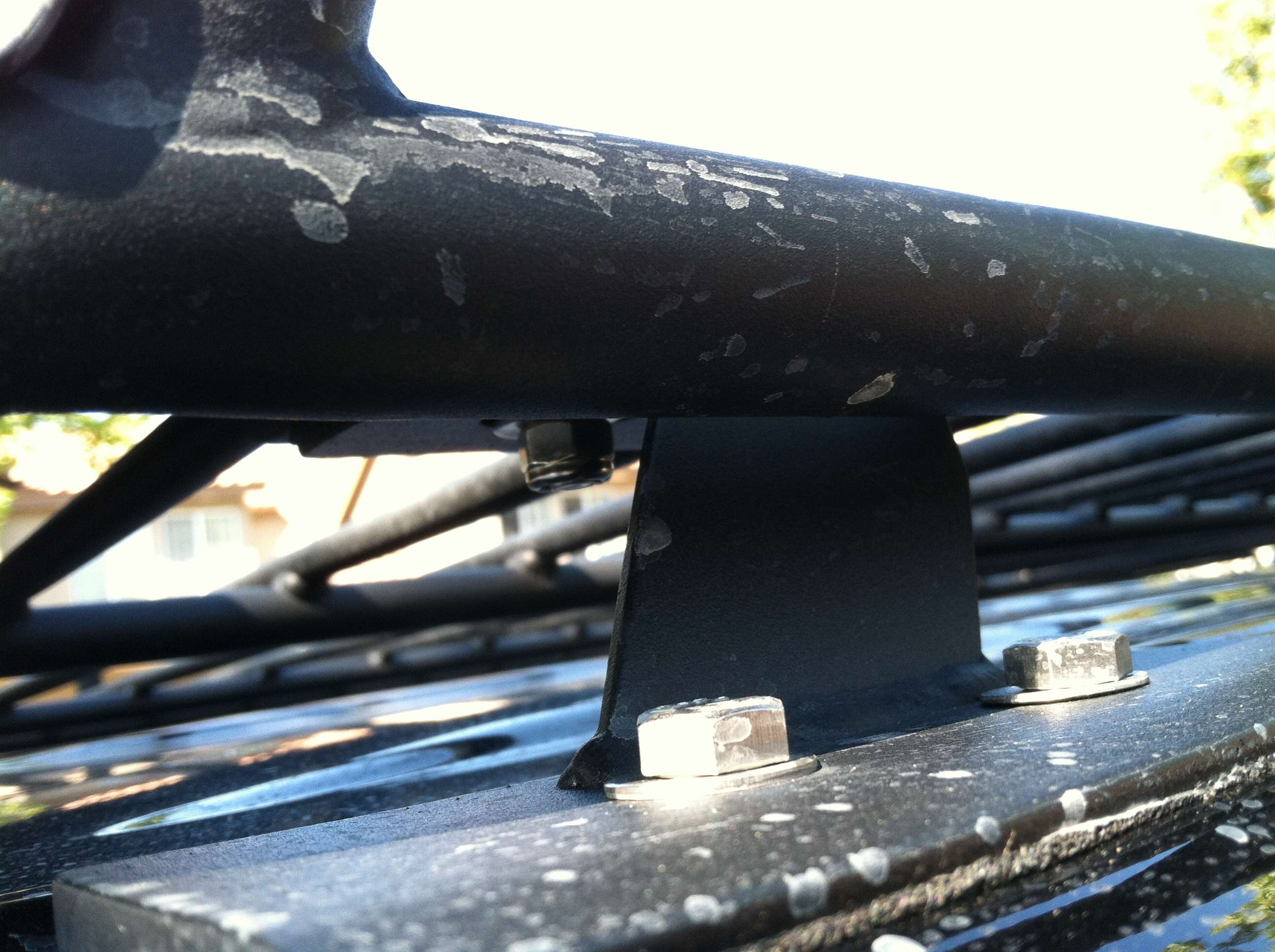

You will not have to drill for the Baja Rack. I installed mine in about 30 minutes. You will have to have a star key to remove the factory rack.
There are two bolts at each attachment point (4 per side). You simply unbolt and remove the factory rack and bolt on the Baja Rack. You will bolt the pillars on first, then put the rack on the vehicle and bolt it to the pillars. The bolts on the pillars to the truck, and on the rack are simple 1/2'' standard bolts.
It is really no problem at all.
RiDE on the forum sells the GOBI. There is literally nothing to the install. I started snapping photos when installing my flat BajaRack, and thought this is stupid and unnecessary. You pop off the factory rail ends, take out two bolts on each end, and pull it off. Put the new rack mounts on the roof, put the 16 bolts back in, set the rack on and bolt it down to the mounts. Done. Takes all of an hour at most.
As for the rack selections, I am partial to the BajaRack full length utility rack. Maintains a low profile, holds a ton of stuff, and I like the floor style better than the GOBI. Only downside is that the GOBI ladder contacts it when opening the hatch. Given the choice again, I would chose the same setup.

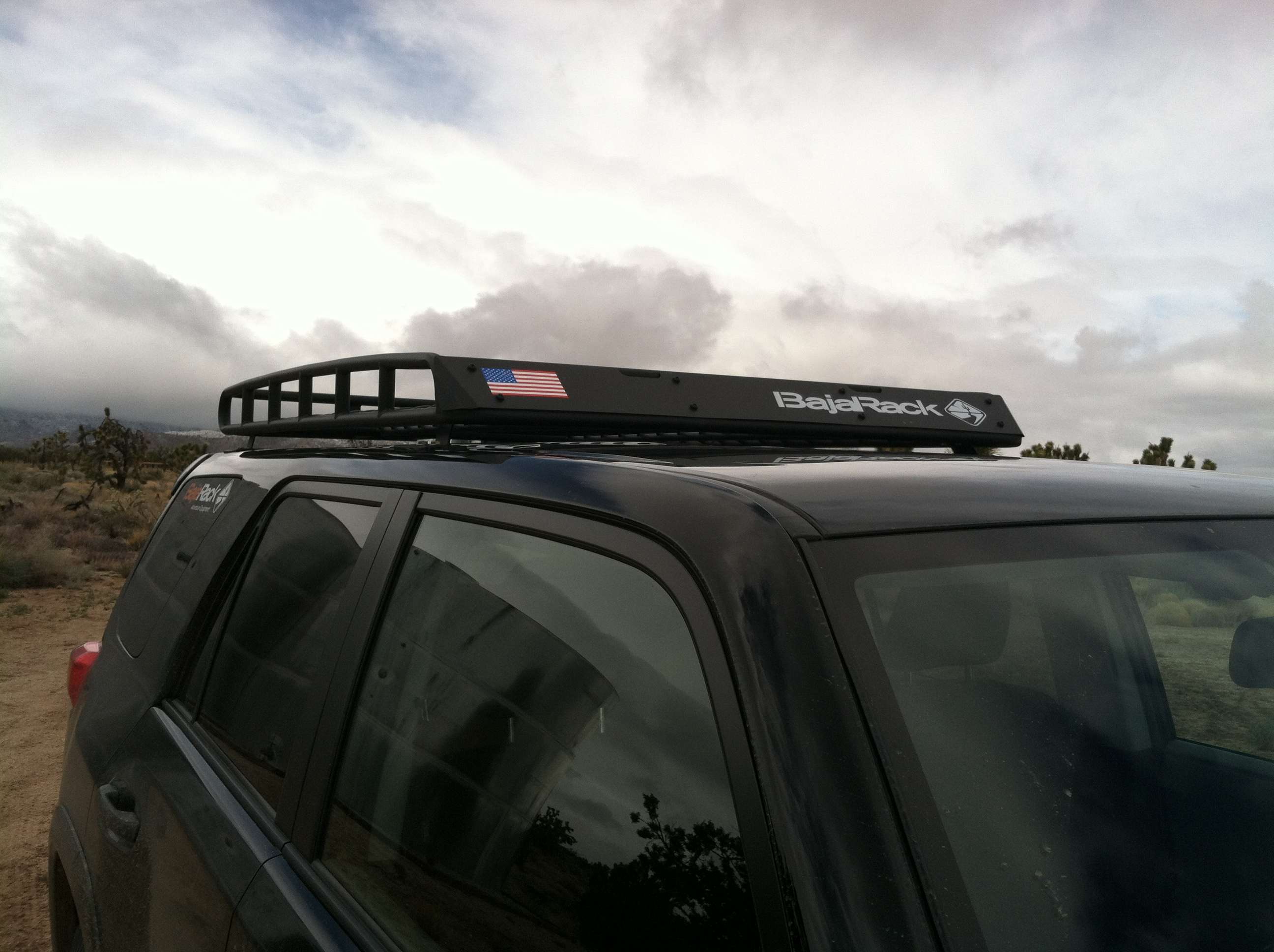

They are stuck with heavy duty 3M adhesive tape. Since you can't put anything all the way up front because of the sun roof opening, the long rack is best used for an awning, or if you want to mount lights up there.
If you want to use a roof top tent, then go with the utility rack.
BTW, you will notice that the Baja Rack fairing does not touch the top of the vehicle like the Gobi. Proper precautions need to be made with the Gobi so you don't scratch up the roof of your car from the fairing moving about when driving, and body flex.
It says on their website, "no drilling" with the short rack, but it does not say that with the long rack. If there is no drilling, what are the front legs supported by on the long rack?
The front legs are bolted to the rack itself then merely sit on the roof with the Baja (there is some foam attached to the bottom of the "feet" to keep from scratching up the paint). It is not made to support any weight up there aside from lights or a canoe or something that distributes the weight throughout the rack.
