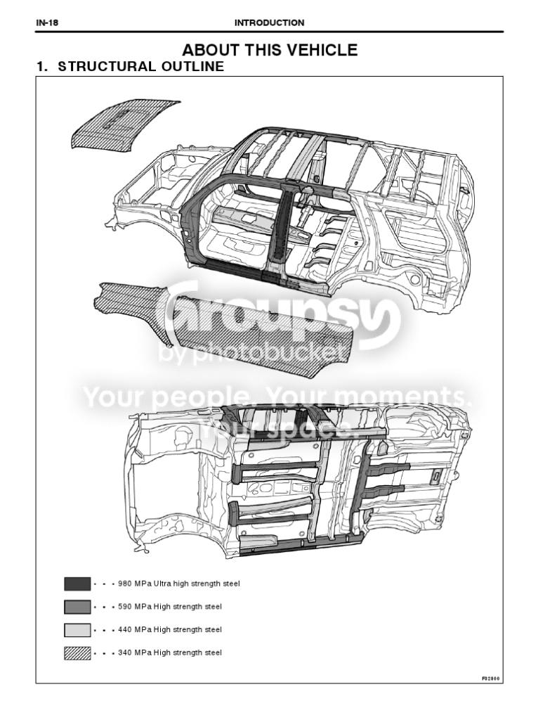

I believe both racks can come with bars the full length if there is not a sunroof. However, remember that you cannot put much weight on the front that is not also distributed to the rear without risking damage to your roof.
When you look at the high strength steel used in the front "A" pillars ,I see no reason why the front part of the roof wouldn't support the same as the back.Actually looks like it's made of stronger steel to protect the driver/pass's .

From the Collision Repair Manual thanks to Nashman69g

My worry would not be the structure, more so the sheet metal. I would certainly hope that the structure should hold at least my weight as that is what is protecting your head in a rollover :jaw drop:

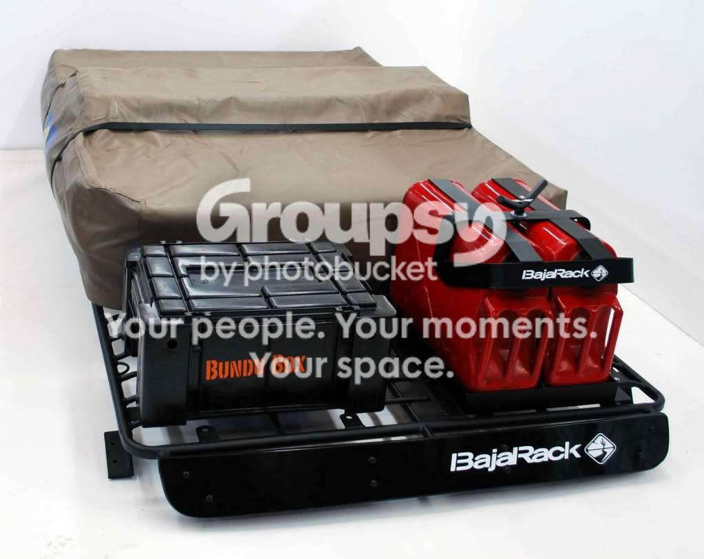

Jerry cans up front ,you mean like this.......
BR-TYFJ-UT-1-0-acc6.jpg~original
Yup, that's one of the pics John sent me when I was inquiring about the rack. Once I get the RTT mounted I'll see if there's room for the can holder as is or if it'll need an insert.
