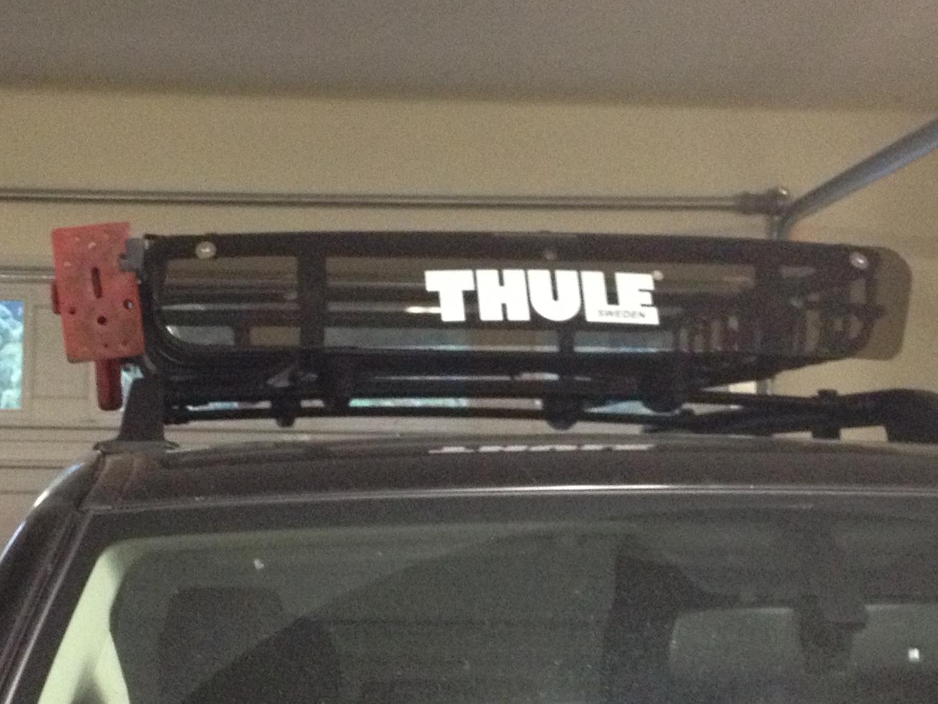

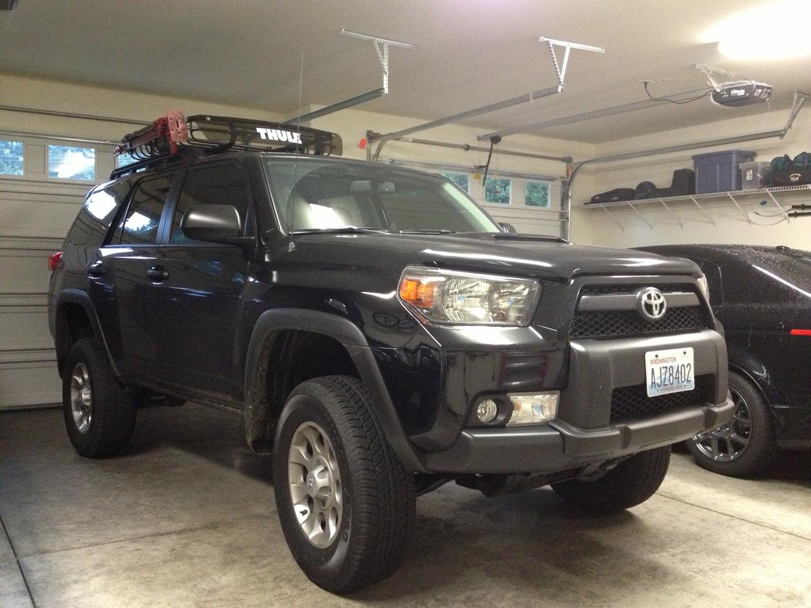

Here are some garage cell phone pics. Sorry, the weather is crappy here.

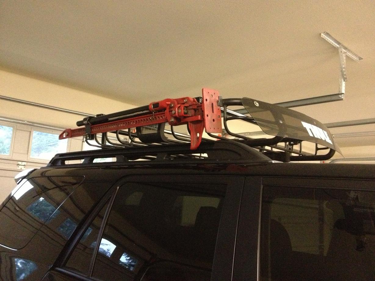

Could you shoot one image showing the distance between the rack and the high lift? So from the passenger's side front tire looking down to the rear of the truck.
Here you go. This shows the proximity to the side rail also.
Yeah thats close... I bet you anything that the "claw" of the jack is coming into contact with the rack whilst driving. I have one more request for an image and that a birds eye view of the jack a rack with the most attention towards the space between the rack and the jack. That should help me finalize MY opinion and recommend something to help eliminate the clink/clank/clunk. :D

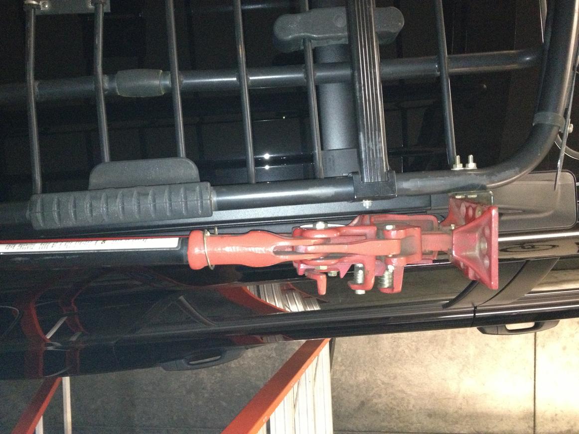

Taken from an 8ft ladder as high as I can hold it in my 9ft garage, lol.
This clank/clunk could quite well be the actual mechanism of the high lift jack moving across. In fact, I bet my bottom dollar that's what the sound you're experiencing is. The claw of the jack is hitting the base of the jack. Go out to your garage and try and move the jack via the handle and see how much movement/travel you get out of it? Does it move much?
