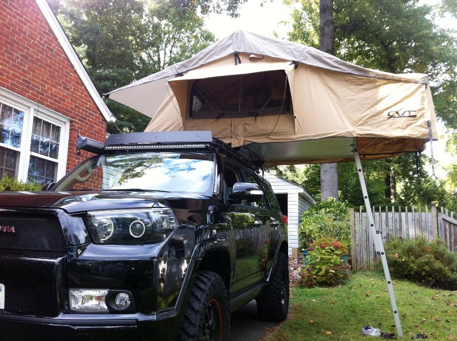

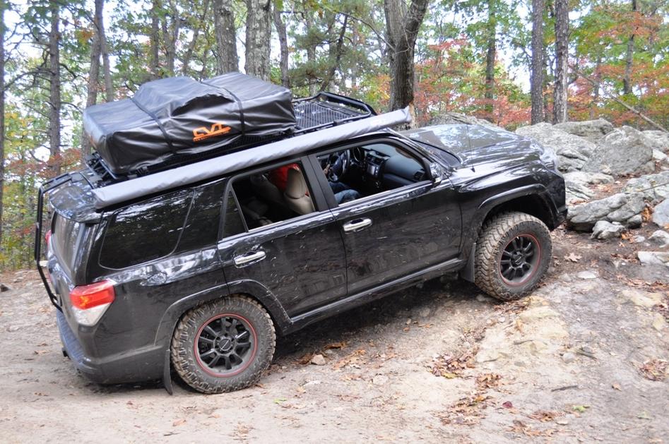

2011 LE Gobi stealth with removed cross bars and no vertical bars on front. Yakima grab rails attached to RTT so it can be removed without unbolting from rails.

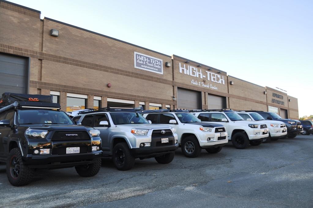

Loaded up to go to the first [MENTION=65614]Antman[/MENTION] camp out 2012

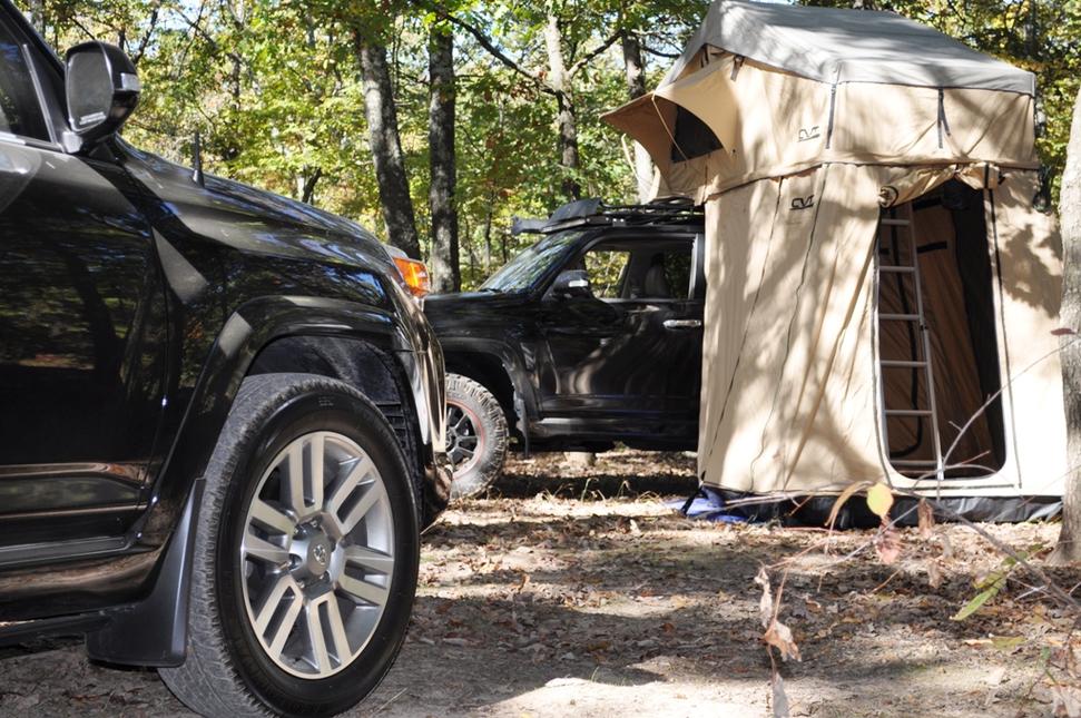

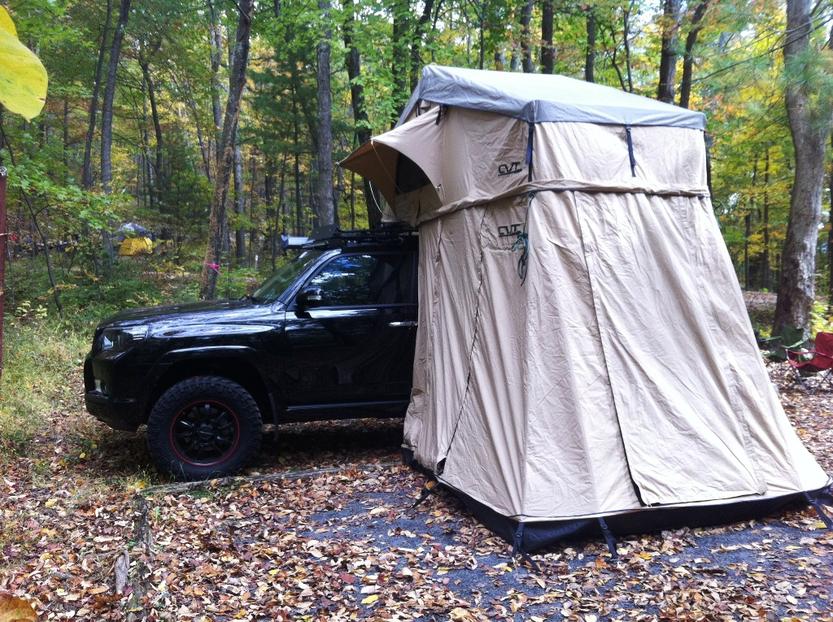

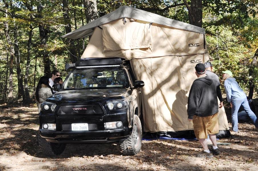

Deployed at camp

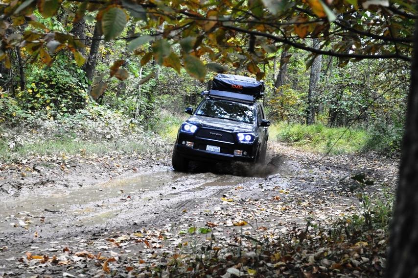

Getting a feel for center of gravity changes

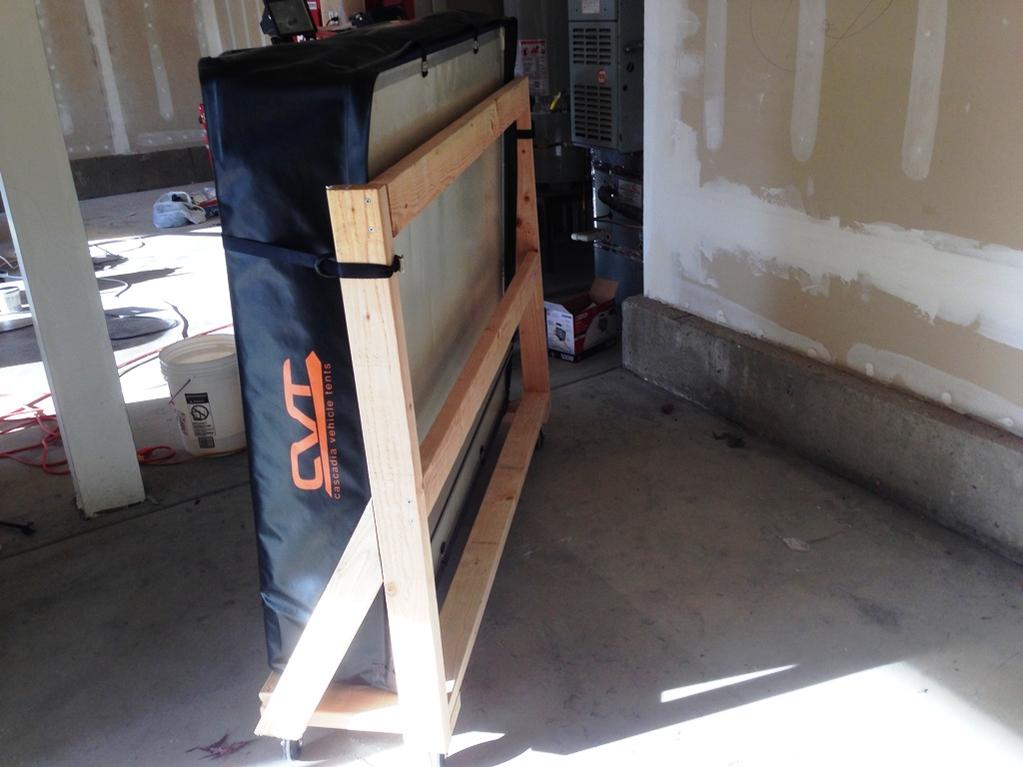

Finding a way to keep it in the garage and movable. Built a dolly so I could roll it around.

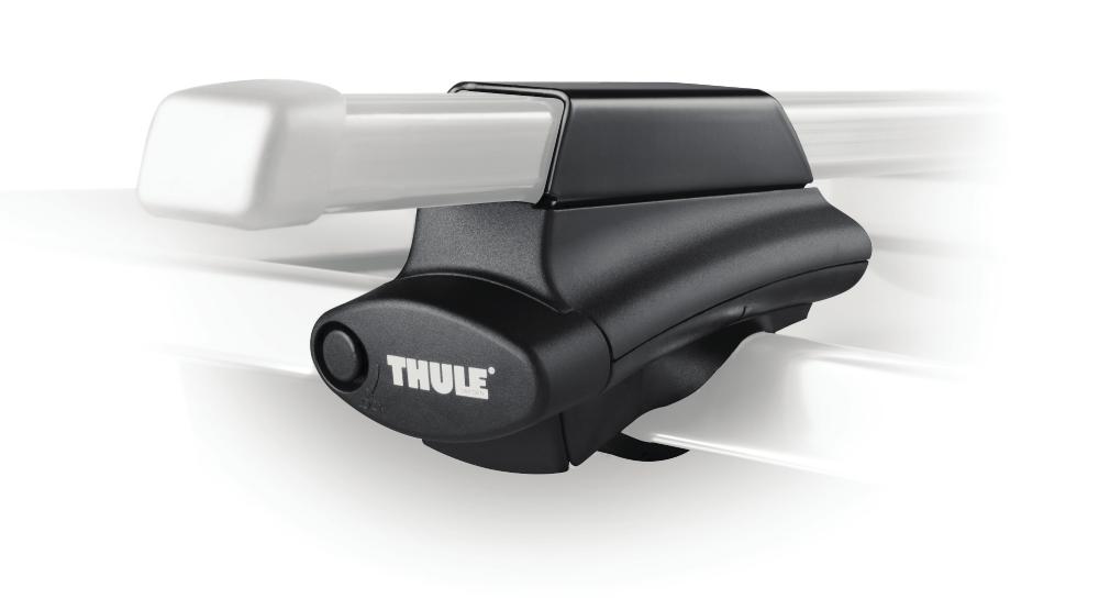

Sorry, I have Yakima on the brain as I'm trying to replace my bike carrier with a different one. I'm actually using the Thule system because of the square bars for the RTT. It doesn't matter which way you go, but I liked the idea of a 'flat' square bar for the RTT to attach to.
This is called the Thule 450 Crossroad. I'm using it to attach directly to the top bars (front to back) of the Gobi stealth. Then I usually leave these attached to the RTT so that it ubolts really easy.
You can see a little more here

Very cool and those disconnect without any bolts? They look like they lock too.
I can vouch for these too. I use them for my kayak racks. Just use a single hex key bolt to mount them and yes, they have cylinder locks which adds a little security. You unlock the end cap and then it pulls off, exposing the bolt. The end cap has the hex key built into it so no worry about losing the tool.

Exactly what Hokie said. If you click the link under the picture you'll see the what it looks like without the lock/cover.
