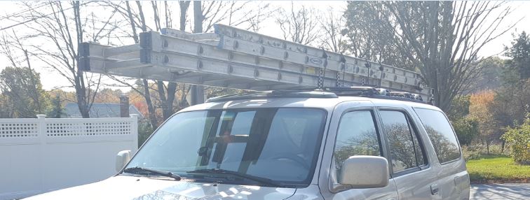

I'd certainly have no problem running up to Alaska with four 32 inch wheels on my roof. I run heavy large loads on the roof all the time running 1,000 miles per week with no roof damage. Its easy to rig up a platform out of wood, ratchet strap the load good. For extra security you can add 2 extra cross rails like mine, grab cheap at junk yard.
