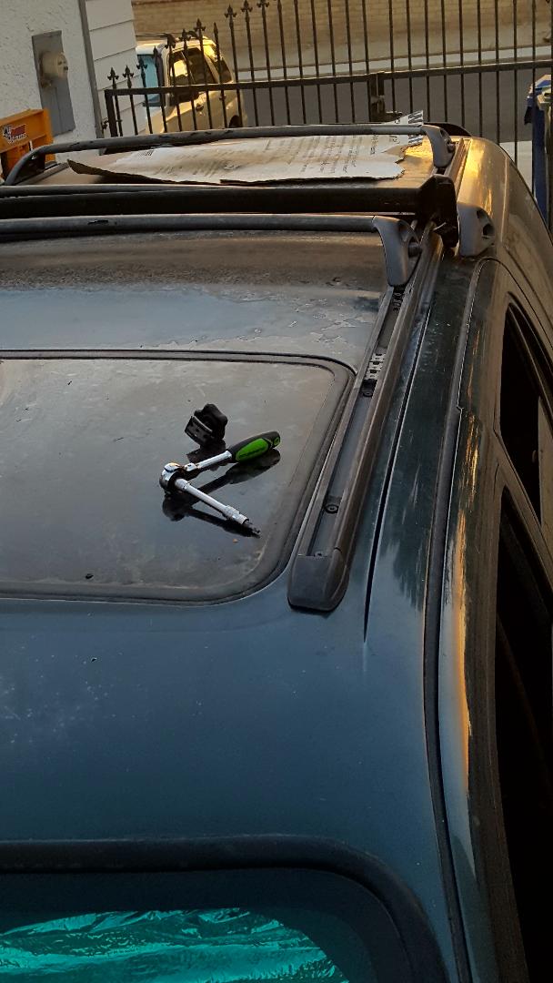

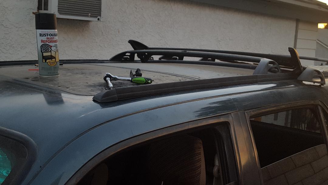

Simply extend your stock roof rack
You could even bend a 90 degree Al rail to look good from the outside, or easily extend it and distribute the weight with a stock rail rivnut/ nutsert tool
this is the option I am looking at, but I asked questions on another thread related to this where you showed and talked about this ( and quoted you) and you did not reply
so in still trying to figure it out
I looked into extending the roof rack. Bought the rivnuts and cut the pieces n everything. Then I backed out of the idea when I realized how flimsy that metal is. I wouldnt trust it to hold any weight from bouncing. I made my full length roof rack which I am going to secure up front by heating up a black rail of plastic so it conforms to the roof line. Then stick it to the roof with a complete layer of 3m double sided tape. This will spread out the bouncing loads much better.
