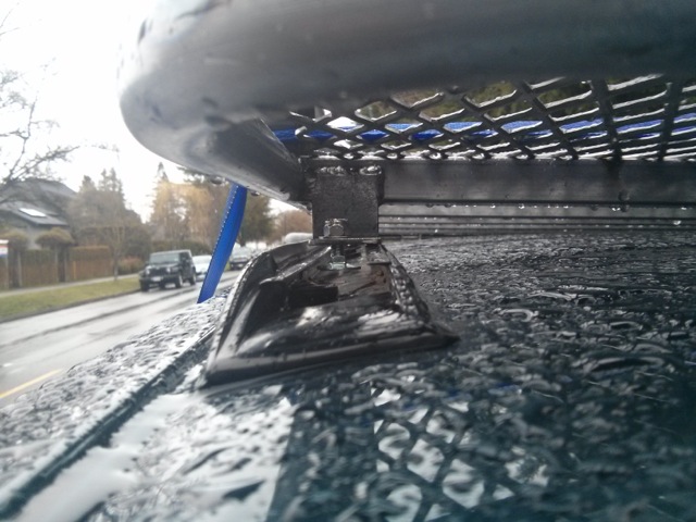

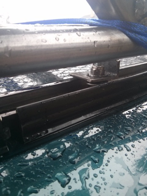

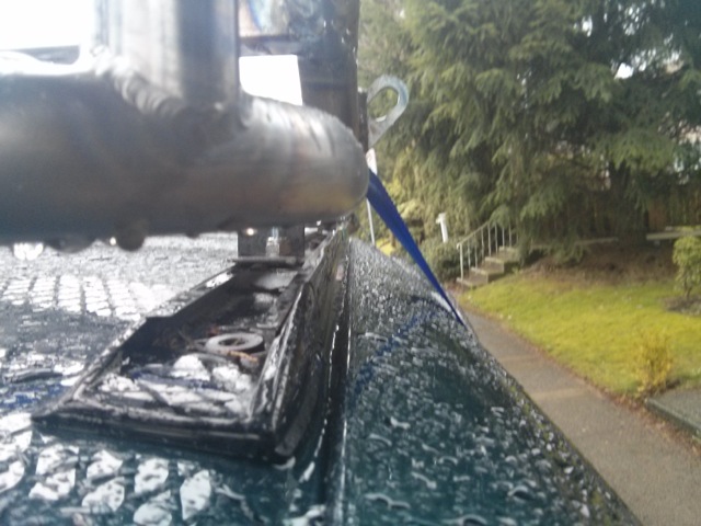

Interesting... maybe I should take the roof rails off. I have a Hilux Surf and my rails are actually totally different than the NA 4Runners... as I discovered when I tried to mount the Whitson rack. I don't have those end point clips at all and my rails are wider. I'll try looking underneath to see if there is anything.
I guess you have to drop the headliner for this then?
can you please post photos of your rails...?
Not the best pics. I took these on Saturday when I picked up my Whitson rack - which is when I learned that the rails are completely different. Much wider tracks.
I'm going to have to get new mounts fabbed up or source some NA rails to get this rack to fit.
