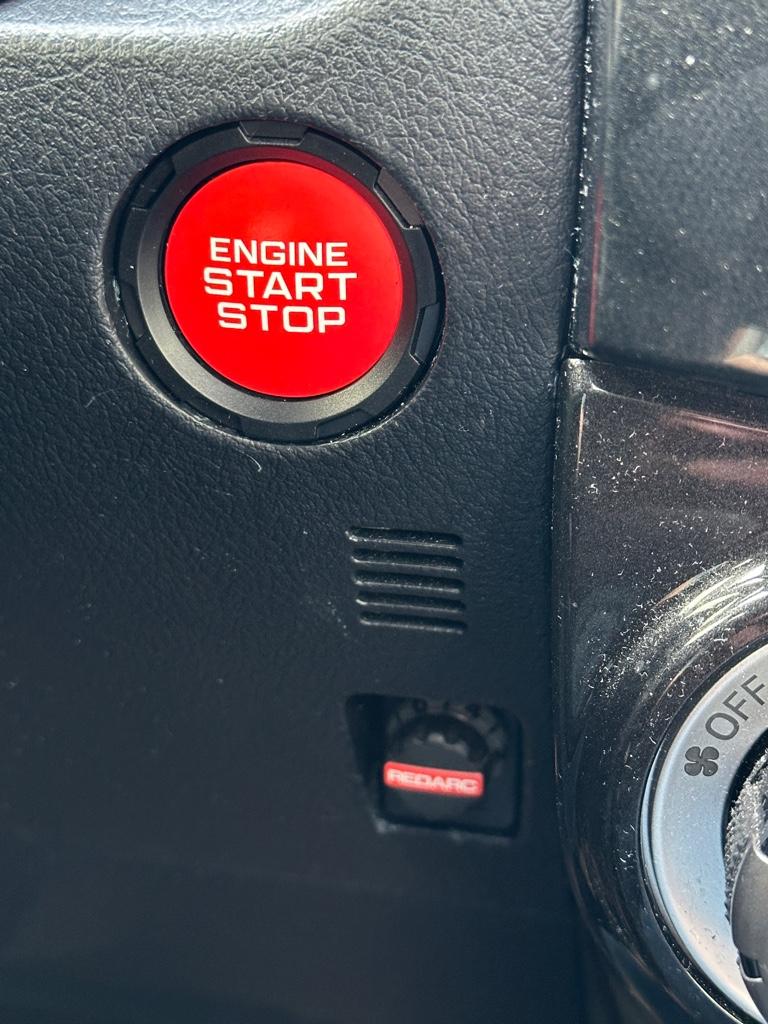

The recess for the one under the Start button seems like it would make it hard to get your fingers on it.
I might do the one on the left, but I think I prefer to be able to adjust it with my right hand. I might be over thinking this. My old controller ramps up the force based on time instead of inertia and I always have to dial it off when I pull into my gravel parking lot at the hunting property. I also thought about if I need to activate if manually for some reason; I usually drive with my left hand so my right hand would just be able to reach down and tap the control without me having to switch hands on the steering wheel and lean forward.
It may appear that way, but the knob is easily operated. It’s also out of the way to it isn’t accidentally bumped or changed.

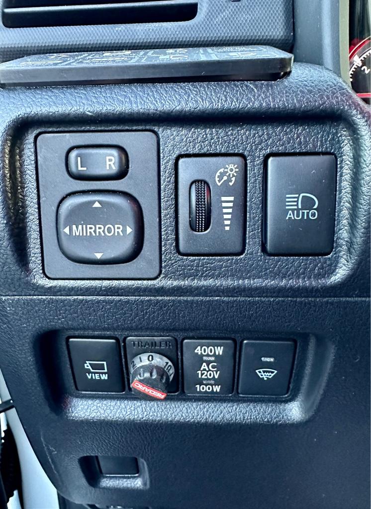

Installation Complete
Reporting back:
There is plenty of room under the center console to mount the control knob. I only had to lift up the center console and slide it to the side a bit. I didn't have to unplug anything. I also didn't have to remove any other trim or panels in the car.
I mounted mine with what might appear to be reverse orientation, in that the numbers and letters are upside down when viewed from the driver's seat, but that gave me better visibility to status light.

I've towed the trailer 10 times now, including two trips of over 360 miles each. I'm very happy with everything and haven't bumped the knob once by accident.
