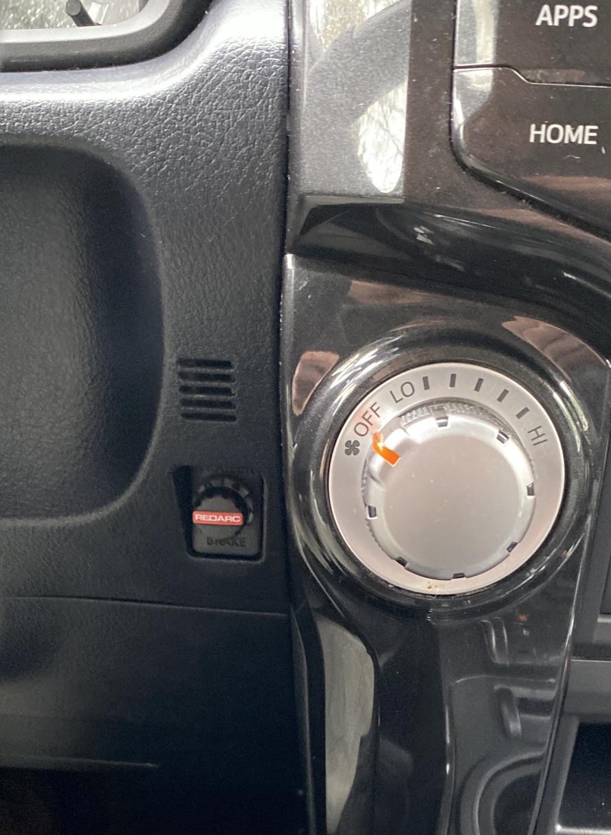

I just installed my Redarc brake controller. Thanks to this thread it was very easy!! Just wanted to provide some info.
I bought the Tow Pro Elite V3 controller, the TPSI-002 switch insert which fits perfectly in the 4Runner, and the TPH-021 Redarc wiring harness. This is the single harness that plugs into the factory 4Runner brake controller plug and then directly into the brake controller. No additional adapters needed.
I installed the controller where everyone else seems to; behind the panel on the drivers side center console using Velcro and zip ties. The adapter is long enough to run from that location, but the ground wire may not reach to the location near the door some have used. I put the ground on the metal mount for the OBDII harness. There is a hole there to use a screw, washers and a nut.
I installed the switch/knob at the “party mode” spot. This works best for me. I haven’t tested the switch yet because I don’t have a trailer with brakes. (I’ll be using RVShare to rent trailers for a bit.) I’ll try and remember to come and update this after I’ve tested it.
To me, this was the only real option. I didn’t want anything large and obtrusive and I didn’t want to fool with a Bluetooth option. Bluetooth may be easier on the front end with an install but using it is much more of a pain...
