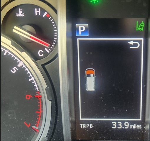

Awesome. Any idea if it solves the false ABS warnings you get if you perform a trailer brake override command for more than 5 seconds?
What happens is the brake controller backfeeds the trailer’s and truck’s brake lights during the override function (all brake controllers do this). But the truck’s computers see the brake lights on without the brake pedal physically engaged so it flags an issue.
Some folks claim a couple diodes and/or relay may be needed in order for a brake controller to only engage the trailer’s lights during override.
As a test, hold down the override button without pushing the brake pedal. In about 5-7 seconds ABS and other lights will come on. They go off after turning off engine and restarting.

So... I haven't had this issue, and I've done "drag brake" turns with my 4Runner accelerating and the trailer brakes locked up.
Now, I need to go hook up my trailer and try it all again to see if this happens. Also, does this happen in 2WD or 4WD(lo/hi)?

Well, looks like that would do it as long as the backfeed source (for the non-fancy new harness folks) occurs on the trailer side. If the brake controller instead feeds back thru it’s trigger wire (from brake pedal) this probably wouldn’t solve it since truck brake lights would still illuminate without the pedal pushed defying the computers logic. Another diode on the feed/trigger line to brake controller would solve that potentially. And that’s probably what the new harness has inside right? That’s why brake lights don’t work during manual override with the new harness from the looks of it.
The other issue is using the brake blue wire to fire a relay. That line is a varied voltage based on brake controller setting and even manual override only goes up to your specified brake setting to my knowledge. So if the relay doesn’t fire below let’s say 6 volts and the controller is set to roughly 50% of max output, there may not be enough voltage at the blue line to actually get the relay to operate. Maybe I dont know. Looks like someone has to test it out. I could totally be wrong.
That seems terrible. Did you write to RedArc by chance?
It’s not a Redarc issue. The Redarc (or any brake controller) is supposed to illuminate brake lights when manually engaging override function.
the issue is that the brake pedal on the 4Runner has multiple sensors and feeds multiple systems. So basically, the truck’s computers see the brake lights illuminated but the computer doesn’t verify the brake pedal is the source, or in another way, sees the brake pedal ISNT being pushed yet the lights are on.

Hi, I just installed the Redarc Tow Pro Elite using the TPH-021 harness and I'm now seeing a warning on the dash of my 2022 4Runner. I've double checked and can't find anything that got disconnected during the install. I also tried disconnecting the Redarc and I still get the warning light. Adding to the challenge is that I don't see any information or description about this warning indicator anywhere in the manual and can't find it on the web. This is a 2022 4Runner. Any ideas / suggestions?
Thanks, Christian
Thanks, Christian
Unplug the brake controller and see if it goes away. If it doesn’t, then correlation does not equal causation
