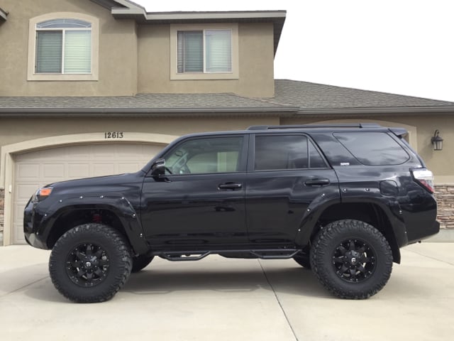

Roozter's '16 SR5P Stealth Runner

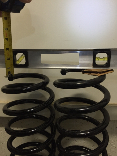

Swapped out the Toytec HD coils for the regular duty Toytec coils today. Looks a lot better now.

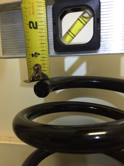

For anyone that is interested I measured the HD coil next to the regular coil. Looks like 7/8" taller on the HD coils and you can see that it is thicker also. Tell you what, the Toytec regular duty coils were way easier to install, that's for sure!
