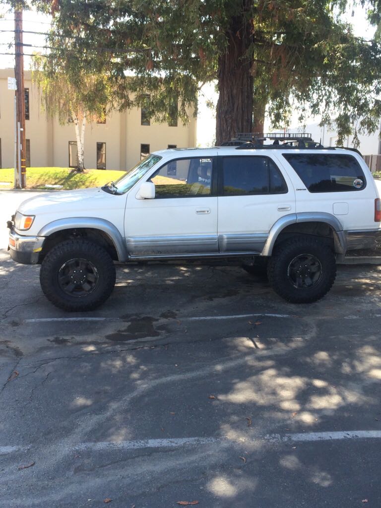

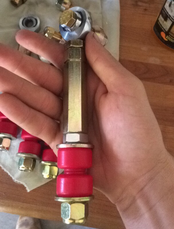

Alright pics are here! Got my SS 1.2 suspension system in along with 285/75/16 Duratracs. finally today I put in 4 of the badass custom sway bar links from a Mr. [MENTION=98153]MStudt[/MENTION] (btw couldn't be happier with them!) next up are the rock sliders and armor and shit that I can't afford yet

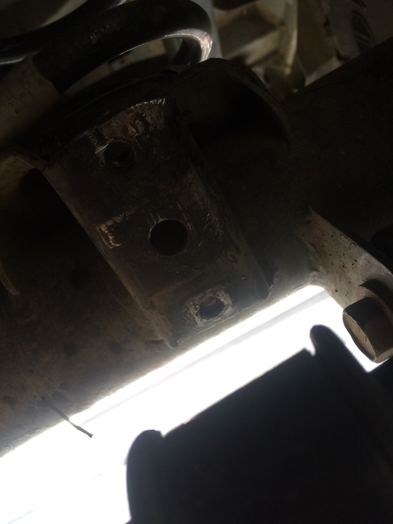

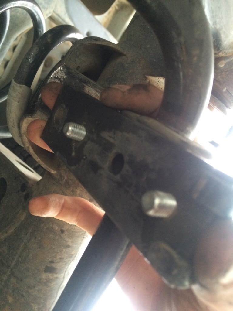

Everything went great except for one thing. The nuts holding the rear sway bar to the axel sheared off! It might be because that the adapter bracket for the lift was slightly lower than the axel and caught on rocks. ImageUploadedByTapatalk1442630804.521585.jpg ImageUploadedByTapatalk1442630887.463059.jpg

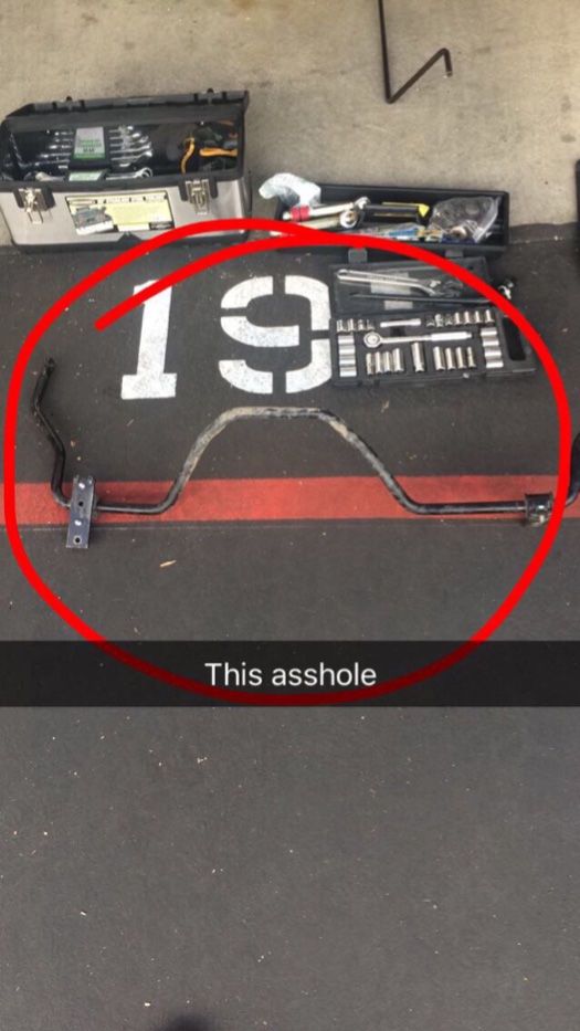

Update on the rear sway bar, I just took that sucker out. Because of the heavier coils from the lift I shouldn't feel that "lean" too much. Especially since my front sway bar is still firmly attached ImageUploadedByTapatalk1443212572.280127.jpg

Oh damn really? I have been driving several days with it just connected to my end links and resting on the diff (ya I know bad to do). So it wasn't bolted to the axle at all and I haven't really noticed that much difference driving at all. I I removed it because the screws sheared off in the mounts on the axle
I know a few guys on the forum run w/o rear sway bars. Do you not have a ton of body roll around corners? As far as removing them for off road, I don think its necessary because you can get your axle to hit the bumpstop with them still installed. They don't really limit travel. I've removed my front bar. More nose dive but honestly worth it.
It sounds to me like the heads broke off and the bolts are still in the holes? Try drilling them out with a tap.

No not very much body around corners or u-turns, I dont drive fast enough to make a huge difference. I do have a tap to remove the bolts but at the moment I'm at school so I need to find a buddy to borrow a cordless drill and tap-handle off of. I do want the sway bar back it but right now it isnt doing anything and just getting in the way so it is temporarily out of commission until I can fix the bolts

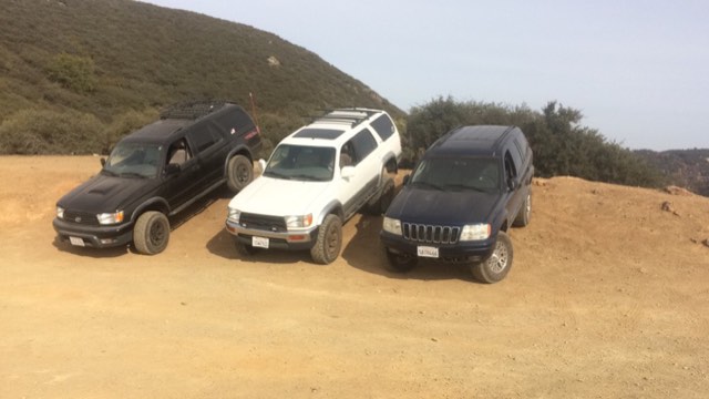

Got the sliders on and they look good! I don't have an up close picture but here is one from wheeling with some buddies this weekend ImageUploadedByTapatalk1445924191.609097.jpg

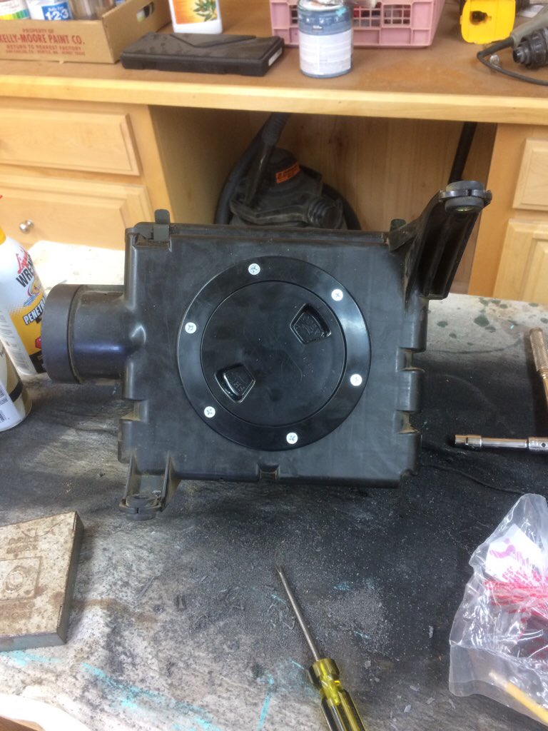

Did my deckplate mod today while I was with [MENTION=113939]JerkyDrewster[/MENTION] helping him put on his new CBI bumper! I commandeered some of his tools but I got it done in about 40 minutes
