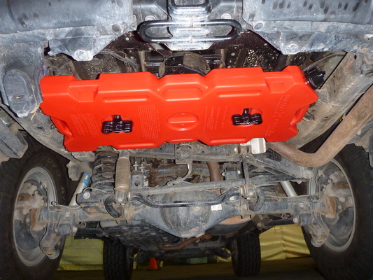

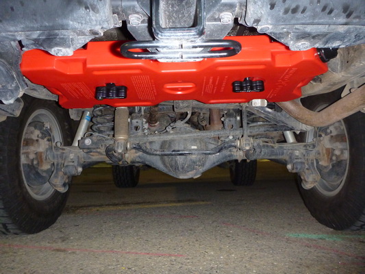

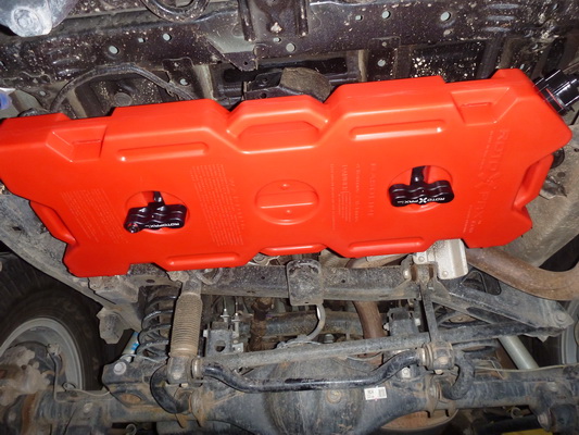

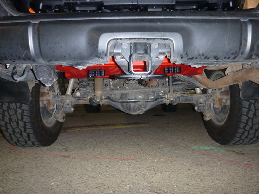

I was concerned about having to vent all the time in the sun so I went under instead. I've just completing the install of a Roto Pax 4 gallon fuel pack in the empty spare wheel well of my Runner. It went in super easy and looks like it was made to fit there, it fits tight across the cross beam that the spare was on. It is tucked out of the way to avoid trail damage and it's invisible unless you look under there (I still put a Roto Lox on it). Yes, you do need to get under there to get it on or off, but I will only use it in emergencies... Let me know if you'd like pics.

Definitely want to see some pics. Is it solid off road?

RotoPax install in spare wheel well
The rack for it is bolted to the frame with 6 bolts, I am confident it will stay put. The only down side is you have to pretty much lay on your back to get it out... It's out of view of a casual glance.
