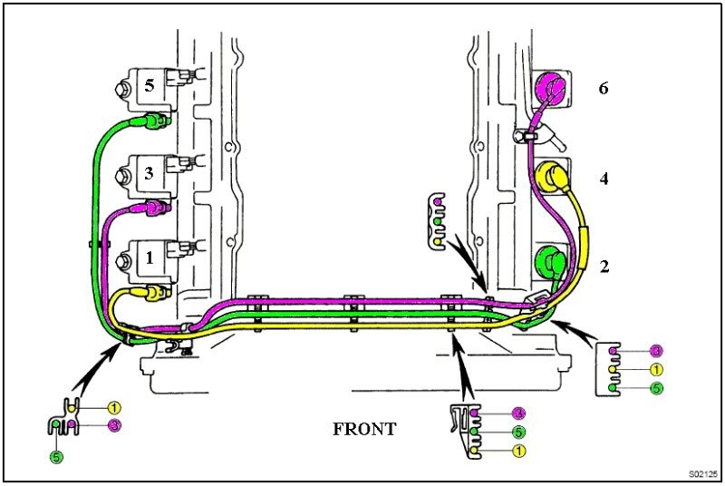

Another possibility is you didn't get the wires routed right.

I guess unplugging the MAF fixing the problem at least point to the fuel and spark being alright. I checked all the wires - they are routed correctly.
