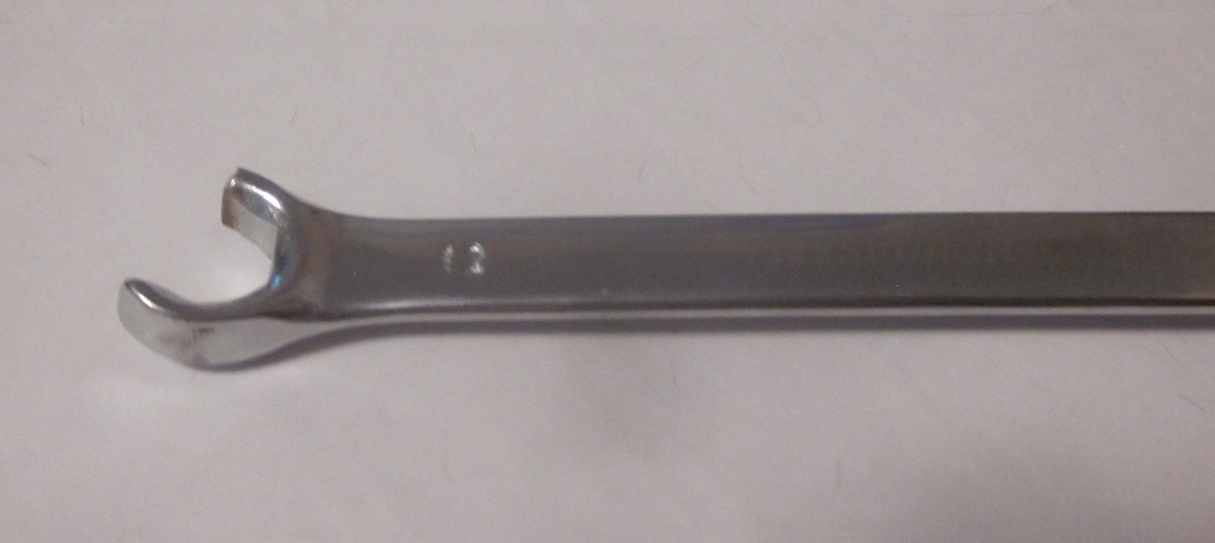

Always use line wrenches on lines.. I did and my still rounded soaked with penetrating oil. Besides once rounded your screwed and it needs replaced with a new flare nut. besides that line isnt that hard to get in. I changed it on my 5 speed with some wiggling and some basic line removal for room.
Mine was never changed until 2017. Hence why mine was rusted on. :-(
my bad, should’ve disclosed that i have some gear wrench flare but wrenches and soaked in PB blast. i ended up cutting the line and doing a repair with a dorman fuel line repair kit from pep boys. worked out fine and should work, lemme know if anyone wants pics

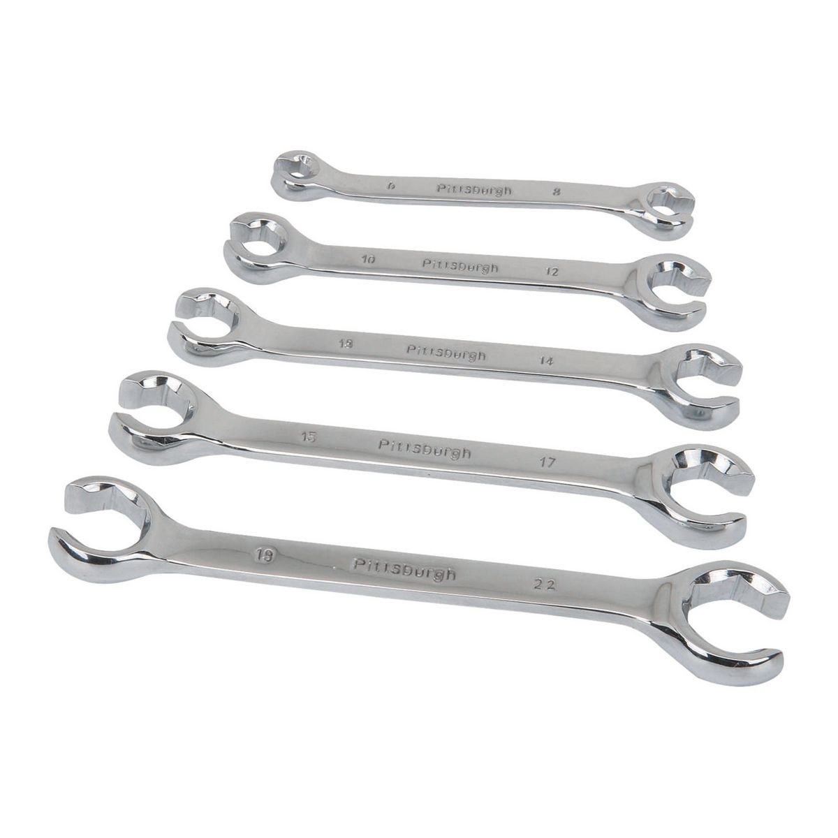

flare wrenches X100
ive twisted wrenches for a long time....but for fuel lines, brake lines...flare wrenches....and of course if dirty/rusty...pb blaster daily. for many days ahead of job... dont use heat/flame :)

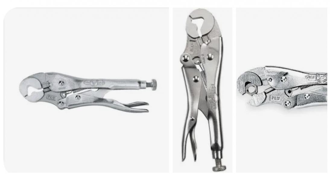

I had success using a three sided locking wrench after the flare nut wrench started to slightly round the filter nut.
These are also worth their weight in gold, used them all the time when I was a machinist. They absolutely blow normal vise grips out of the water when it comes to round stuff
