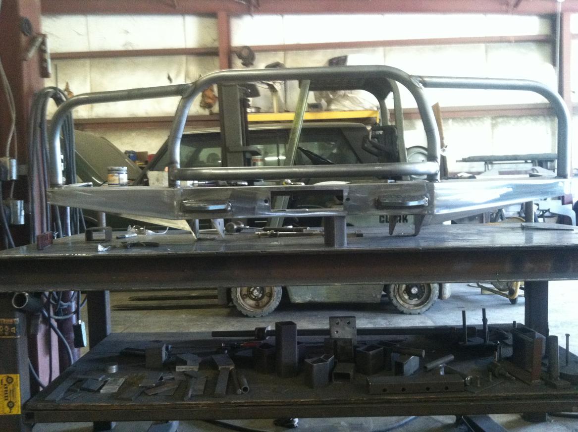

Hey im Ryan from RTE, I'll see if I can get the pictures on here that resembles the bumpers more closely.
This is the Lr3 bumper. If you could imagine the center section of this bumper and the wings from the mid-face bumper above that will be our direction with the Toyota bumpers. Let me know your inputs!

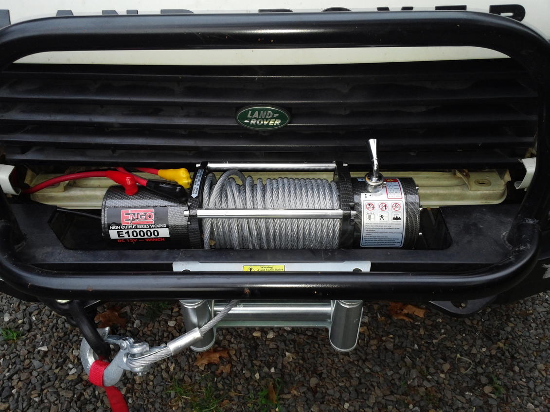

Okay, I am liking that better. Since, you are asking for feedback, let me add a couple more points.
1. Make the winch accessible from the top so we can reach the winch to switch the direction and rewind the line. Toyota bumper makers seem to love to hide and bury the winch inside. It is a royal PITA.
2. Consider building a top access winch bumper that allows people to run built-in solenoid winches.
3. Please consider where someone would the mount the solenoids and control box.
4. Built-in tow hooks would be great.
5. I would also love a place to connect a high lift jack for lifting the front end of the truck.
Yes, yes, yes. Those are my only complaints about the ARB bumper is access to the winch and visibility of the spool when you're dressing the line. I'm not likely to change my front bumper, but if I did those would be the things that make me do it (along with construction, durability, safety, etc.).
I think that with there already being a few bumper options from well-known Toyota fab shops that a new player (to Toyota at least) would need to set themselves apart. A more open winch bumper would be one good way of doing that if you're targeting the off road market. Otherwise you're just focusing on aesthetics.

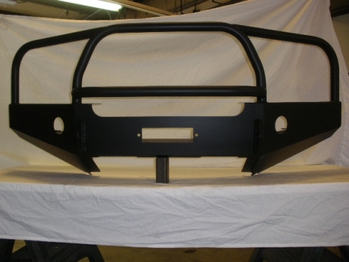

It's open at the top. If you want different recovery points we do that also. Like the Viking recovery points. We also have limb risers if needed.
I am liking your design even more now. You have met all the engineering demands. So, now it time to meet the cosmetic demands of the marketing department. My desire is that it looks like CBIs Tacoma bumper. You meet all that and stay near $1,200 with a quick delivery time and I want one.
