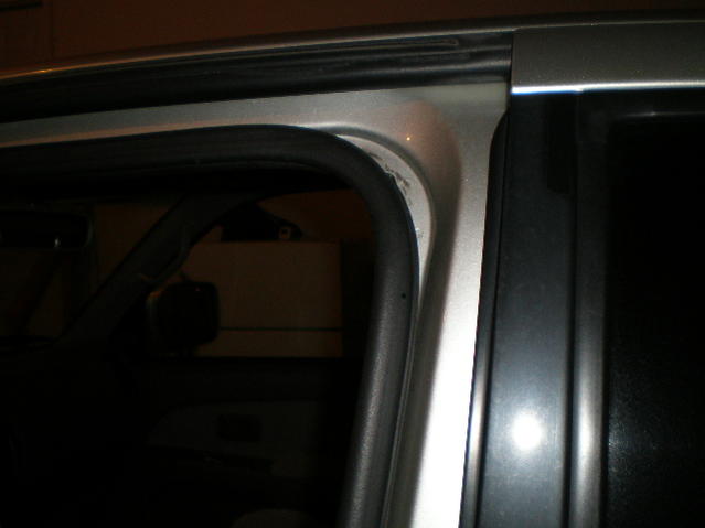

Well now that we have a usable SEARCH and our old pictures are now being posted, I thought I would up-date this thread. My rubber door seal had a bit of a problem. It kept coming off in the upper right corner. It would fall off the seam, just about 1/2 inch, but you could hear the wind noise. I tried moving it around a bit, but nothing worked. I finally used some glue, my glue was called "Goop", not a great name, but it worked. I applied some to the inside and got a stick braced it against the pavement and the seam and let it sit for a hour.
It has been on for about 5 months and seems to be fine. If I would put it in again, I would start at the bottom middle and work my way to the right, anti-clock wise. That way the end would not be at the upper right.
My factory seal is like this also and I just haven't gotten around to fixing it yet. I wondered if this was a common problem or not, so its comforting to know its not specific to my truck only (had me wondering if maybe something had happened during previous ownership that caused this). I think i've got some jb weld out in the garage, that along with your "bracing stick" should do the trick. Great write up btw.
