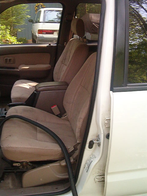

I noticed that the drivers door rubber seal is breaking apart a little. It seems to be one piece and clamped in by the side molding for the car. I wondered if anyone has had the same problem and what they did to fix it?
There are two spots, here is the rubber seal on the side of the door.

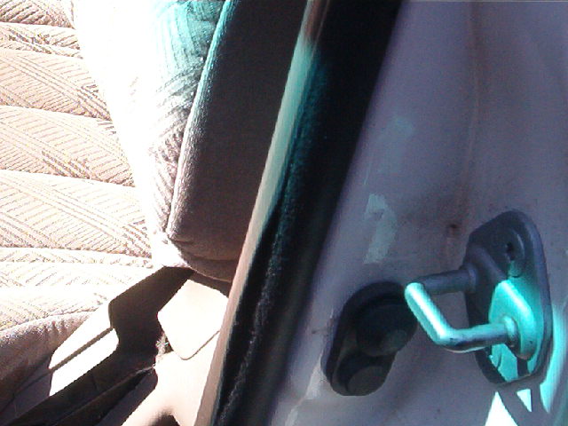

Here is the bottom of the door. Not quite as visible. Also, the paint is coming off the side, I guess from the feet coming in and out of the vehicle.
For now, I am leaving it alone, but I am tempted to replace the whole door seal.

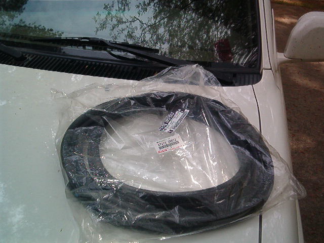

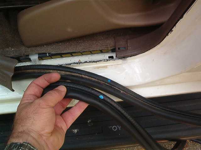

Well, it's been a few months since I posted this thread. I was waiting for a big order for Toyota parts, so I can strecth the shipping cost. Anyway, thanks to Hirox, I just fixed my rubber door seal. The part listed for $122 and I paid around $58. I am guessing around $60 with shipping. I bought oil filters, paint, items for the Previa and the shipping cost was $12 for everything.
Here is a picture of the new seal.

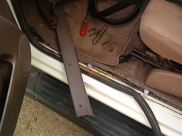

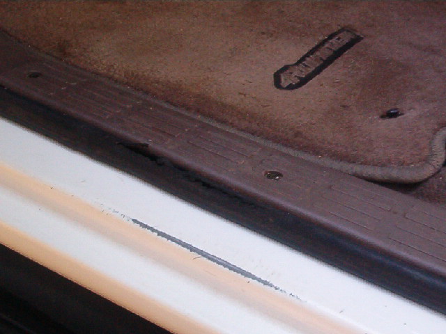

The first thing I did was take off the plastic door plate at the bottom of the door. It was on with 4 screws. The other plastic parts on the side of the door moved away with ease, I did both on the back side and the front side. The front had some wiring under the cover.

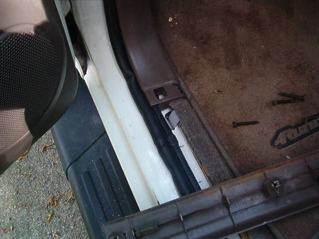

The next thing is Hirox said to put the holes at the bottom, well mine had holes almost everywhere. I found a blue dot on both of the seals and I matched them up. Also, I found a white dot at the top and they matched. The biggest hole was located directly at the bottom. Before I put in the seal, I cleaned out any dirt in the frame area.

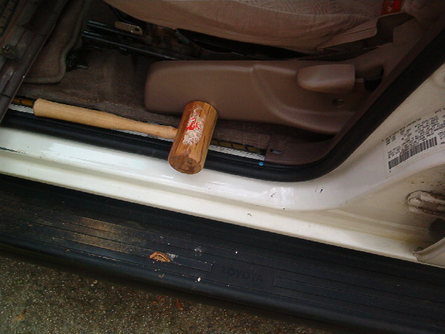

It went in pretty easy, I did push it in really hard and even used a wood mallet to put the seal in tight.

I couldn't get to it until I got home. My order says for describtion ".161 weatherstrip", list is $121.61, my cost was $58.28. The part # is 62312-35013.
I bought it from Mechanicsville Toyota, phone 804-559-8717. They also have a web site at www.magauto.com but I like to call them as they are very helpful.
I bought the drivers side front seal, I am sure the other side is a different number. Also, I am going by the Mechanisville Toyota invoice, I assume the part # is the same as the Toyota number, but I am not positive. I hope this helps.
