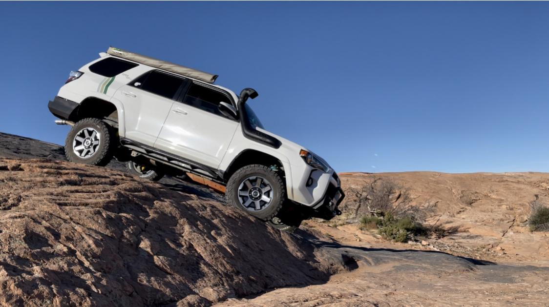

BTW, here's my rig in it's current setup:

Updated first post: The Rubithon wagon run has new requirements. (See first post for all the details and a link) So that’ll be a big “nope” for me this year, unfortunately, at least with the TLCA crew.
Had a great convo with one of the leaders and his info definitely helped me understand the need to have lockers, big lift and mucho tires on these big wagons, and the ability to “cruise” as a large group through the trail to stay on schedule.
I’m tempted to follow the path of their guidelines and go big, but am also wondering just how big i need to go to make it through the trail unscathed and how small i need to stay to keep our truck comparibly reliable and relatively durable compared to stock.
I mean, in the end, these are 4runners, not FJ100’s, fj40’s, fj80’s, fjcruisers, right?
Just thinking out loud, but I think that means that i need to start cutting our teeth on similar trails here in socal, in this particular rig. Big bear, Borrego, Corral canyon, etc, to see where driver skill ends and vehicle mods need to start.
