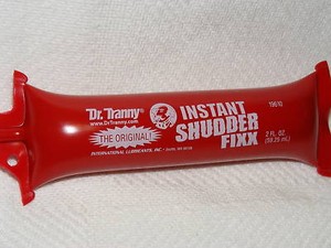

I know I know. I got a hold of a tube of anti shudder (instant shudder fix that everyone raves about (even my mechanic friend)) and contacted the dealer. Told him to do the fluid exchange ($289) and to add the tube. I told him if it works it works, if not, I'll be getting torque converter fixed at a later date AND I won't hold him or the dealer accountable if my tranny instantly explodes. They then agreed to do it no problem. LOL.

Ok, well, got the tranny flushed and filled with the tube of MAGIC. When I went to pick her up, the service manager said, "The tech went for a quick spin and said it wasn't shuddering anymore", "damn".
Took her home (I'm about 45 miles away from work) in mixed highway/stop/go and experienced no "rumble strip" noise. It seemed like she wanted to (maybe it's just me), but nothing. Smooth as silk. Also had the rusted out washer/bolts holding the heat shields replaced. No more rattles!!! I'm very happy to say the least. Having said that, I'm probably jinxed myself....................

Had this in my 03. A local tranny shop did a drain and fill and then added "shudder fix" to the fluid. They told me to drive it 100 miles or so and it would go away.
I drove it about 30 miles and the shudder was one. Torque Converter Shudder is not a new thing, and for me the shop fix cost me $80 with the flush (Rays Transmissions Fort Worth TX). Problem solved and worked all the way up until I pulled the tranny to convert to 4WD.
Dr. Tranny Instant Shudder Fixx 19610 - Free Shipping on Orders Over $99 at Summit Racing
