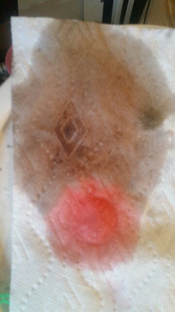

I have T/C shudder at the normal places, mostly on the 35 to 40 mph shift. I did a fluid exchange yesterday at 198300 miles. I was not sure when it was last done or IF it was last done. Will report any troubles. Top is old fluid, bottom new fluid for reference.

Is the TC shudder gone?
Drove to work and back home 30 miles total and is not gone yet. In previous threads they said 50 miles. If it is not gone I am going to add two tubes of Shudder Fixx. I did the exchange to improve the fluid quality. It was unknown when or if it had a fluid exchange.

If anyone is still reading. Fluid alone did not fix my shudder. It is less severe, but not gone. Shudder Fixx is on the way. I bought two tubes and will add one and see if shudder is gone. Will post results.
Since you "freshened" your ATF and (I presume) will be only adding the tube, give it a couple of days for it to cycle through the tranny. I haven't seen a thread where it didn't work.
Post results? I wish I video taped my shudder/rumble to post before and after video, oh well.
Good luck!
Another success for Shudder Fixx. Added tube and gone in 30 miles.
I am glad I freshened the fluid, it needed it. With 198,000 I am not. sure it it had ever been done before. Shudder Fixx did exactly what others have said and worked as advertised.
