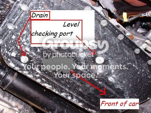

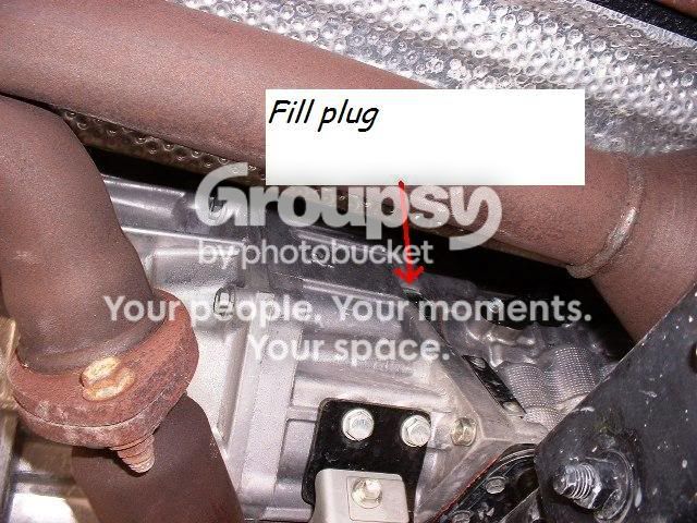

236,000 and having this issue and some harsh shifting. I plan on having a drain and fill done (unfortunate part of living with a gravel driveway and a well pump head right next to it,) but once that's done I'd like to add shudder fixx - are people adding it through the fill plug hole or another way?
Thanks
Is there a drain hole or do you have to drop the pan?
Like I mentioned before, there is a drain hole, but you can drop the pan. Not 100% sure, but dropping the pan will involve removing something else. I'll check back. If you drop the pan (and go through all the trouble, you can replace the "filter" (metal strainer). Also dropping the pan you can get more ATF out. Most use the drain hole.
Photos Courtesy: [MENTION=22558]CJ3Flyr[/MENTION]
DSCF0043.jpg~original
DSCF0045-1.jpg~original

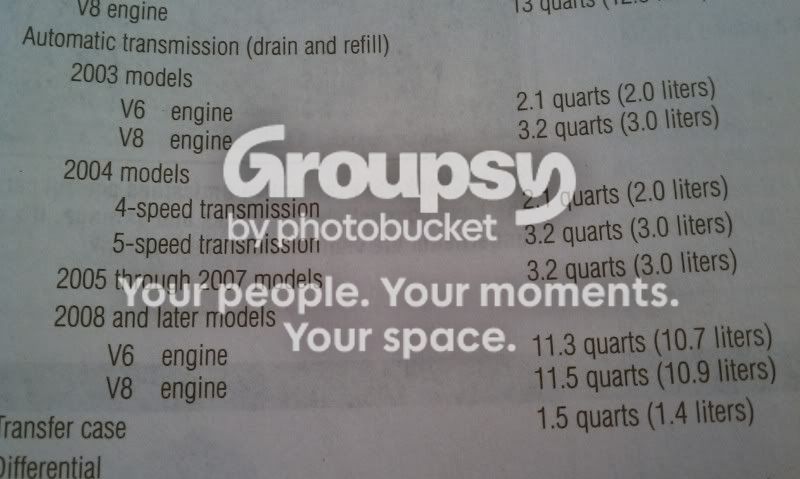

Sorry, how many quarts of new fluid will I need, and what type?
If only draining, I thought I saw 2-3 quarts. If you use the "line method", expect more (12 quarts). See pic:
Photo Courtesy: [MENTION=56345]thirstyturtle[/MENTION]
IMAG0325.jpg~original
