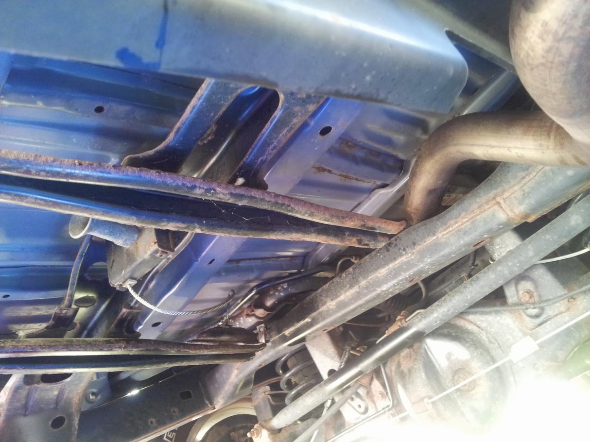

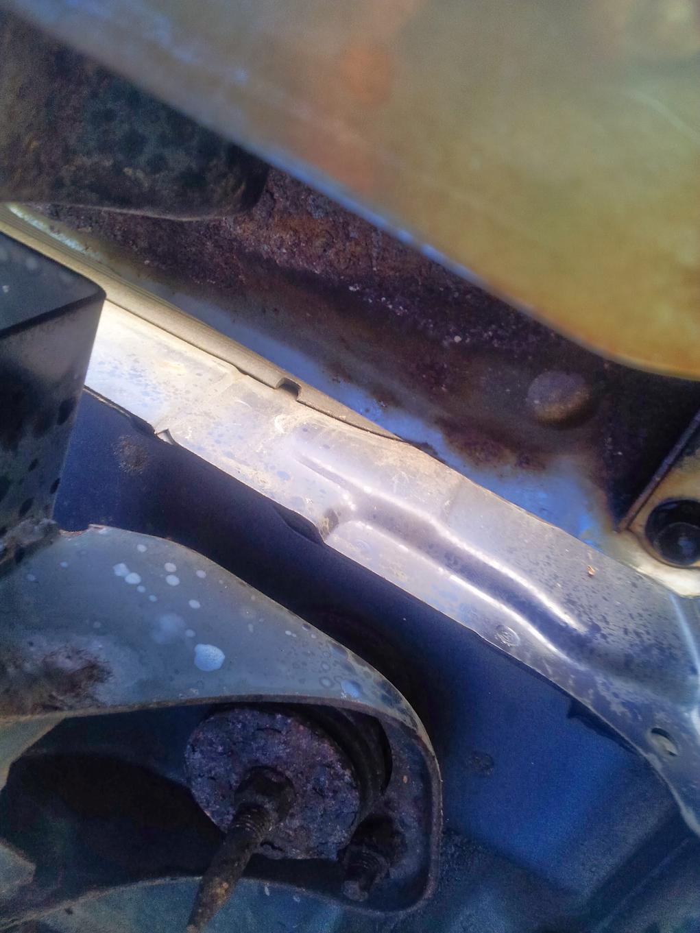

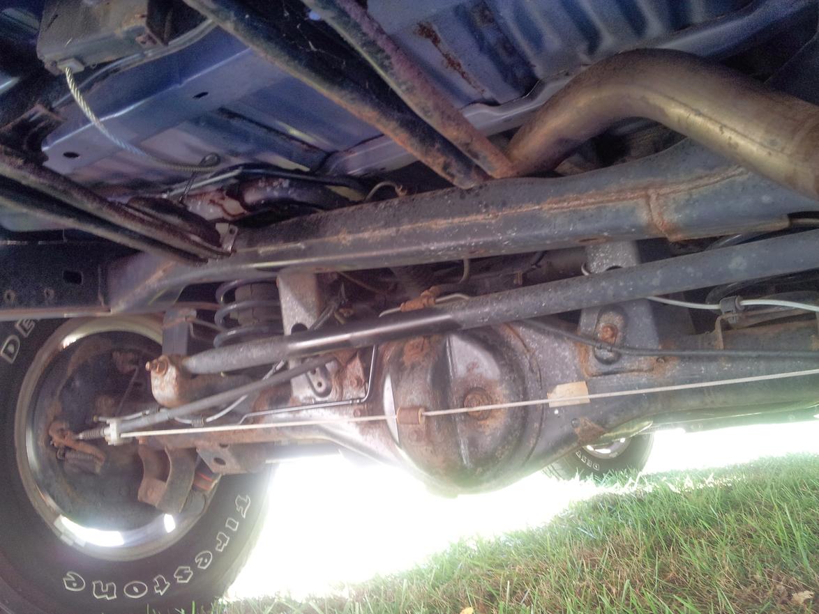

I know it is very little but want to stop it before it spreads. When I decided to replace my rear rusted bumper, it was first time when I was under my truck. :( Bumper was replace in Nov and I bought this truck in Sept last year.
Now, I am waiting for better weather as working in apt parking in winter is hard. For time being I'm spraying PB Plaster. I am planing to use wire brush and eastwood products like Rust Encapsulator, matching spray paint and fluid film.

That doesn't look bad at all , you can clean that right up with a wire wheel and some paint .
Nelsonmd is right por- 15 is a great product but does have to be prepped is steps , with cleaner and metal prep .
And wear gloves , that stuff does NOT come off !
