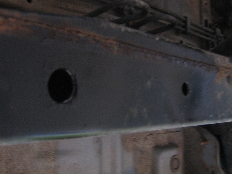

[MENTION=7105]Scramble[/MENTION] you posted a picture before of where you drilled a hole in your frame near the rear control arms but I can't find it with Photobucket. Can you repost it and I can open it directly? Thinking of doing this with mine.
Sure! I'm at work, & those pics are on my home PC, I'll update tonight or tomorrow. I have more pics to update on that thread anyway.

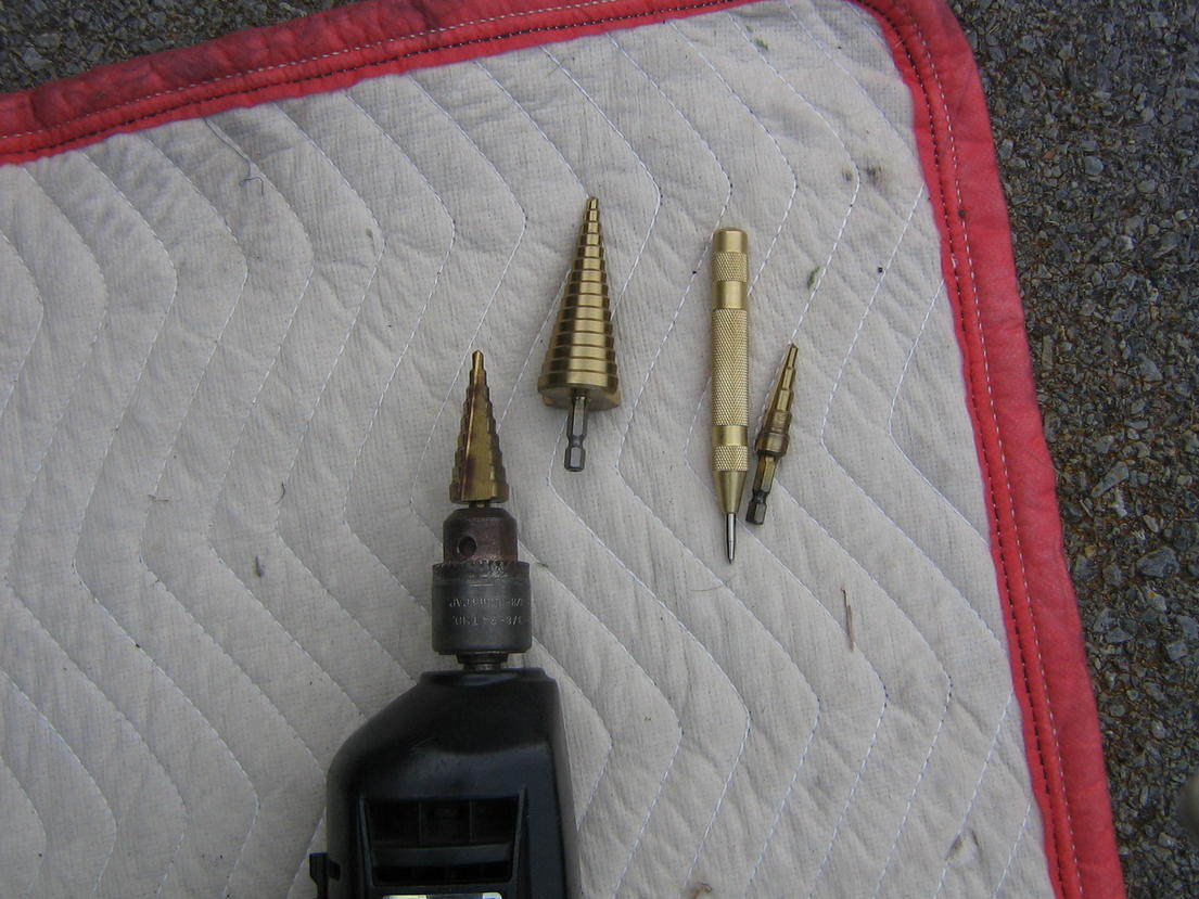

I did one on each side, 2" from the upper control arm bracket weld. I originally used a 1/2" drill bit but didn't think it was big enough so I bought step bits & opened it to 3/4 & hit it with some Black paint. Last weekend I finally got all of the rust chips out & will use the Eastwood internal frame coating along with Eastwood rust converter on the outside as soon as I get a lower humidity day.
