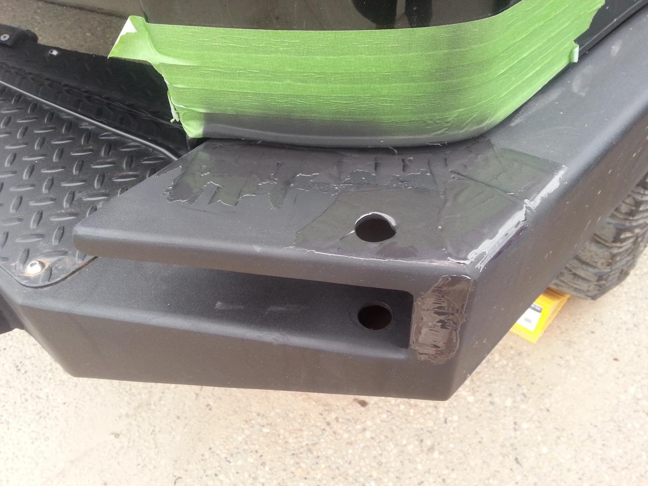

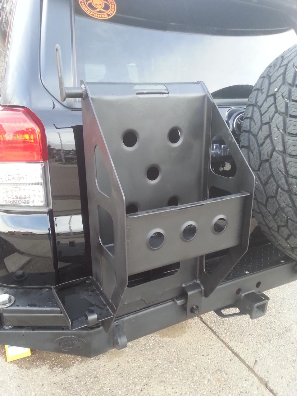

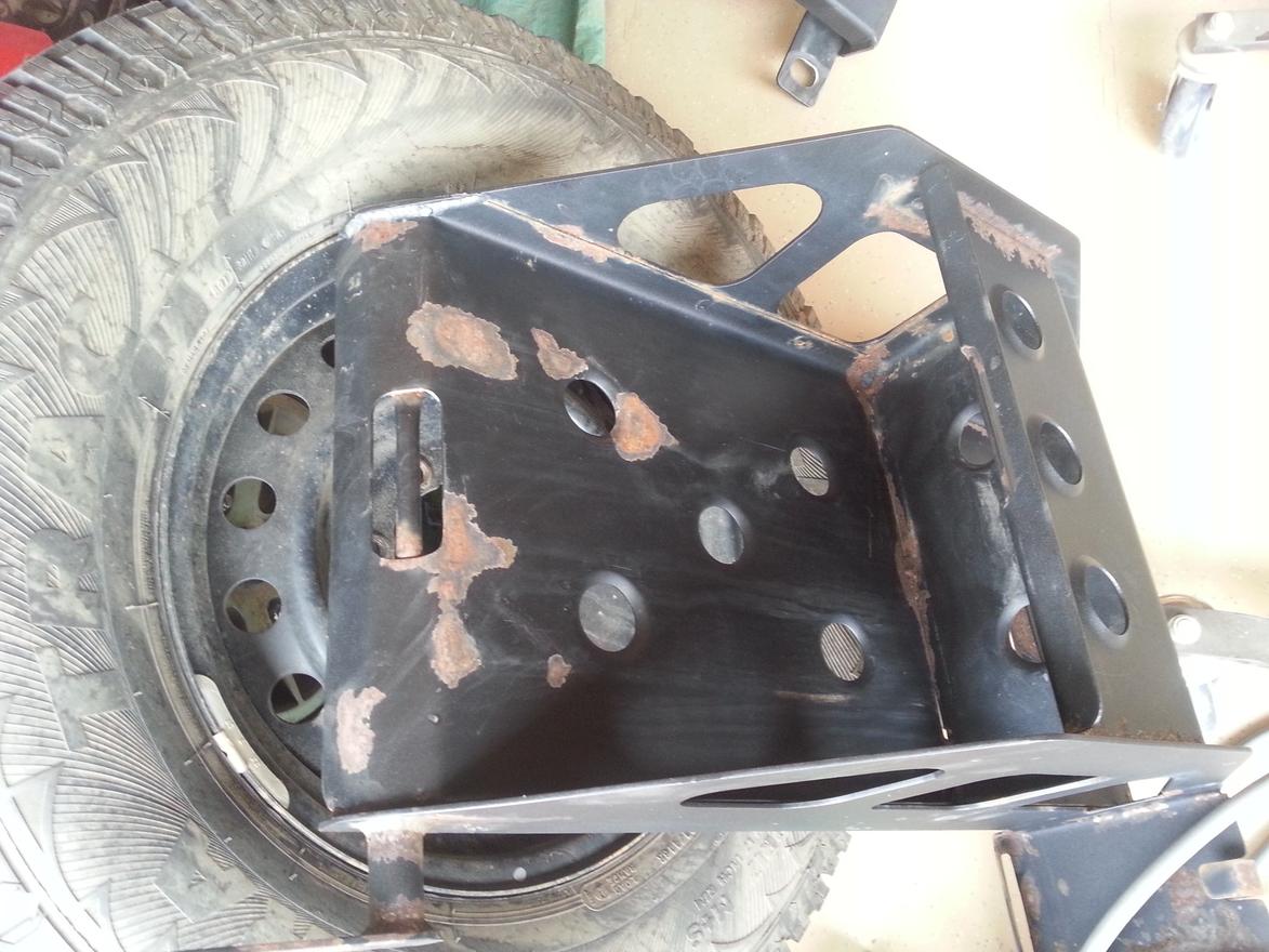

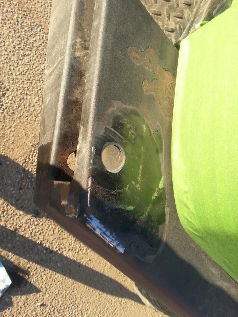

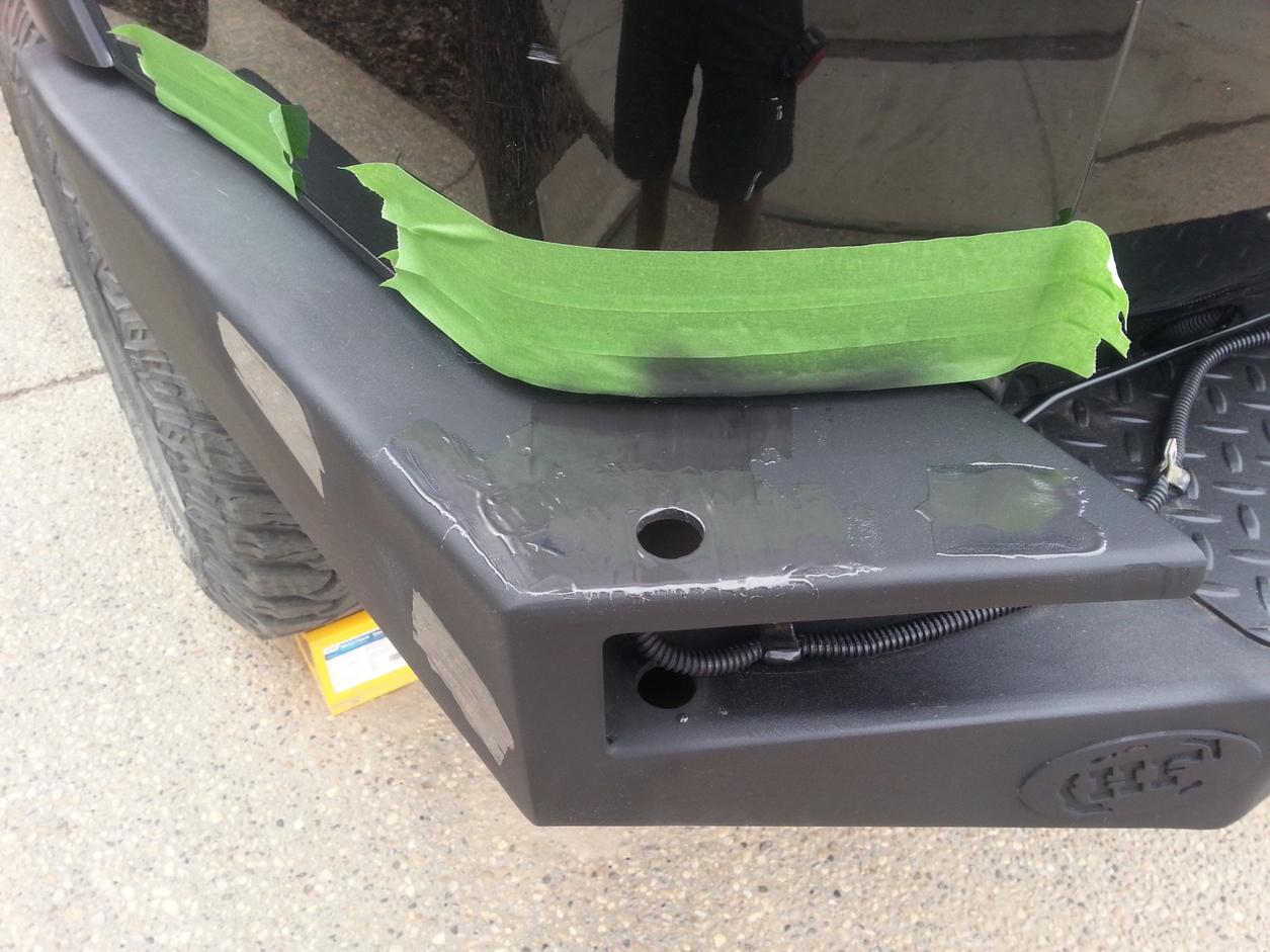

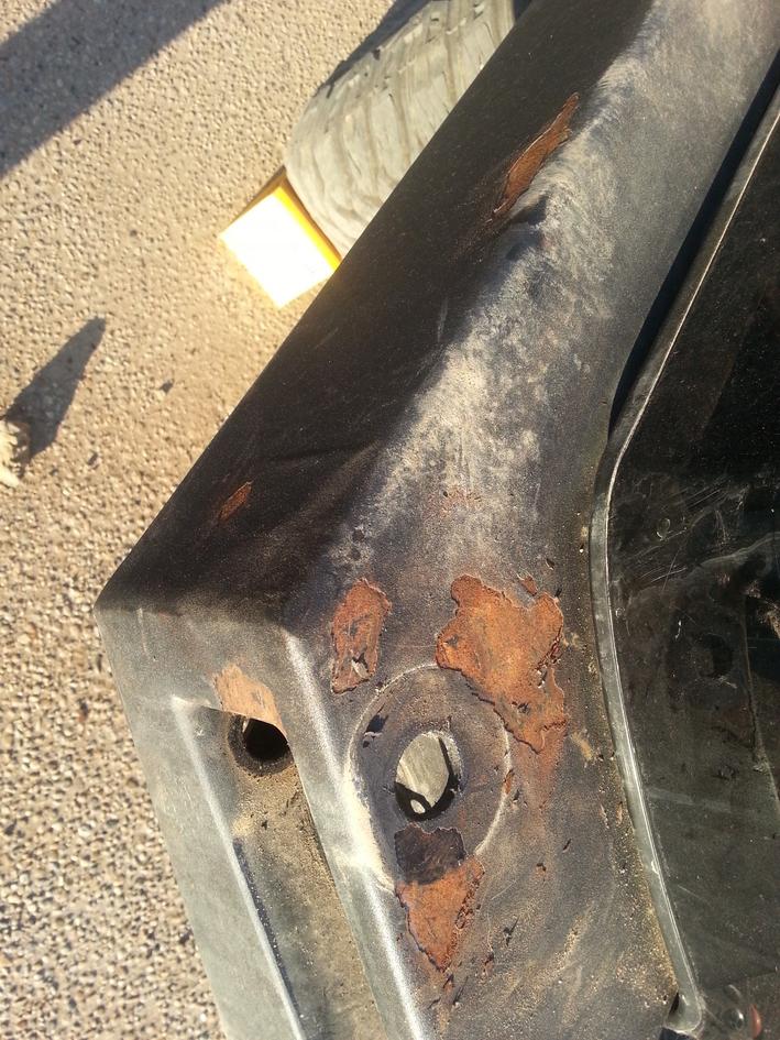

Unfortunately, this winter my rear bumper started rusting...a lot!
I'm not quite sure why, but my guess is that the cold temperature we experience up here (-40 degrees Celsius sometimes) cause microcracks in the powder coat. Water gets underneath the coating, steel starts rusting and coating starts to flake off. The water jug holder is definitely the worst. I used a flapper wheel to remove the rust on the bumper and a power washer on the jug holder. I then did a light coat of flat black paint, which blends in seamlessly and some JB Weld as a filler (instead of bondo). Once it sets, i'll sand it smooth and paint with Rustoleum Textured Black (which according to Hefty matches perfectly with their powder coat).
Any of you experience serious rusting of your bumpers? I almost wonder if the the flat textured powder coat is more susceptible because my front bumper has zero sign of rust and it is has more of a gloss finish.

That's weird, I thought powdercoating was flexible enough to move with metal expansion?
To be honest, I think there were some manufacturing shortfalls. Some areas I could see no cracking at all...its almost as if they powder coated over rusty or oily metal.

You definitely have some rust happening there. Rust Happens.
It doesn't get that cold here in So Cal that we need to use road salts or gravel. Isn't some of this rust due to road salts?
Looking at your prep work I can't see how much you ground, sanded or primed. I think you need to remove all of the loose paint and rust. I see edges of paint next to the bodywork that you can not get off if it's still on the car. You may need to take the bumper off so you can do some aggressive scraping, grinding and sanding. Once all of the loose paint, rust, oils and salts are removed, then primer and paint. Good luck.

it gets cold enough here in the winter that they generally don't use salt, since it isn't effective below a certain temp.

I'm not going to go crazy...just touch up the bad spots and monitor. The flat paint blends in absolutely seamlessly so frequent touchups will be no big deal until it becomes unmanageable.
We live in a very dry climate so this rust is extremely odd. Not much salt use here, more sand because of the cold.
Might also want to try some POR 15 I use this on one of my other trucks that has a replacement bumper and the stuff is tough.

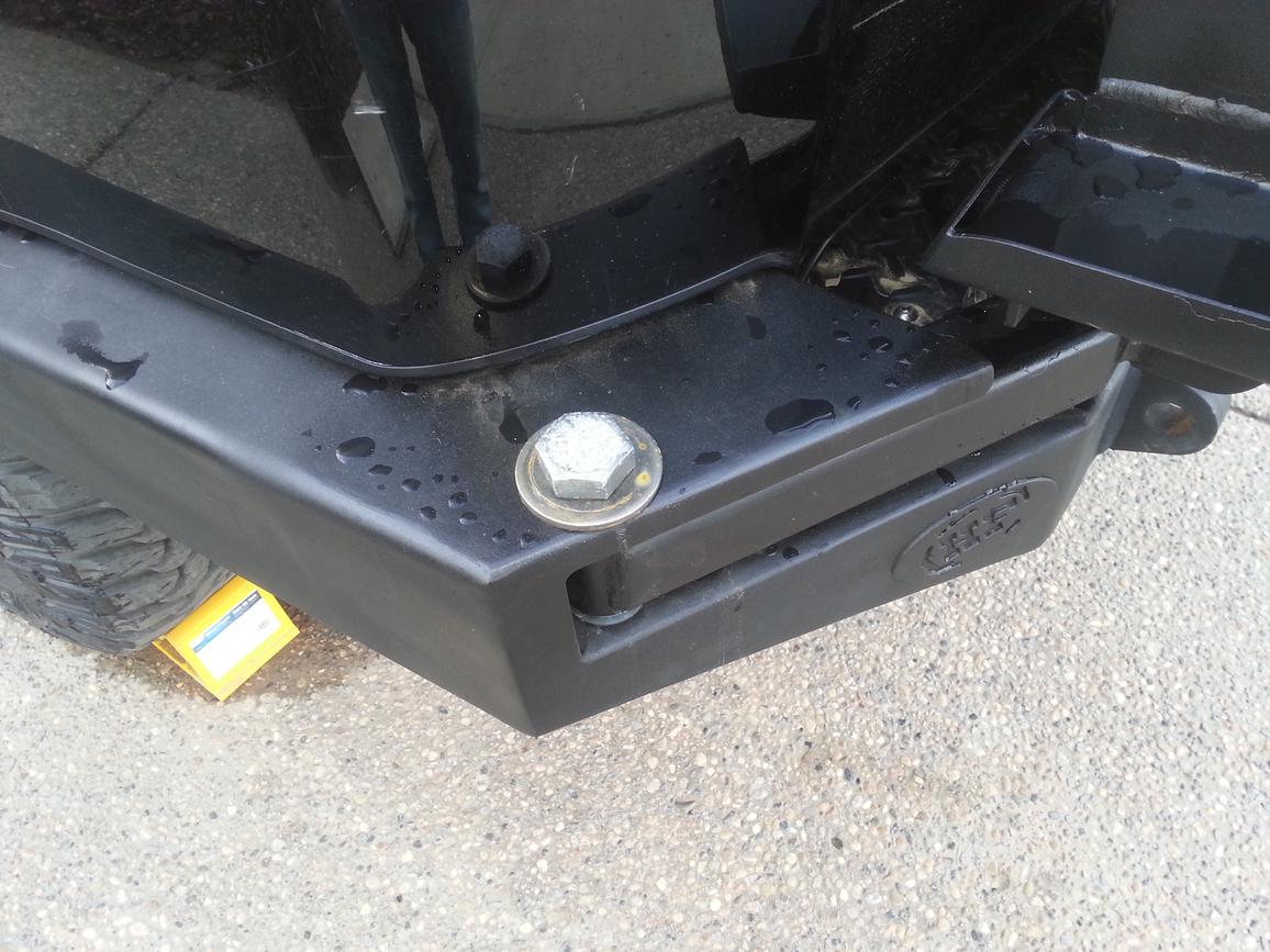

Done. Lets see how it holds up!
