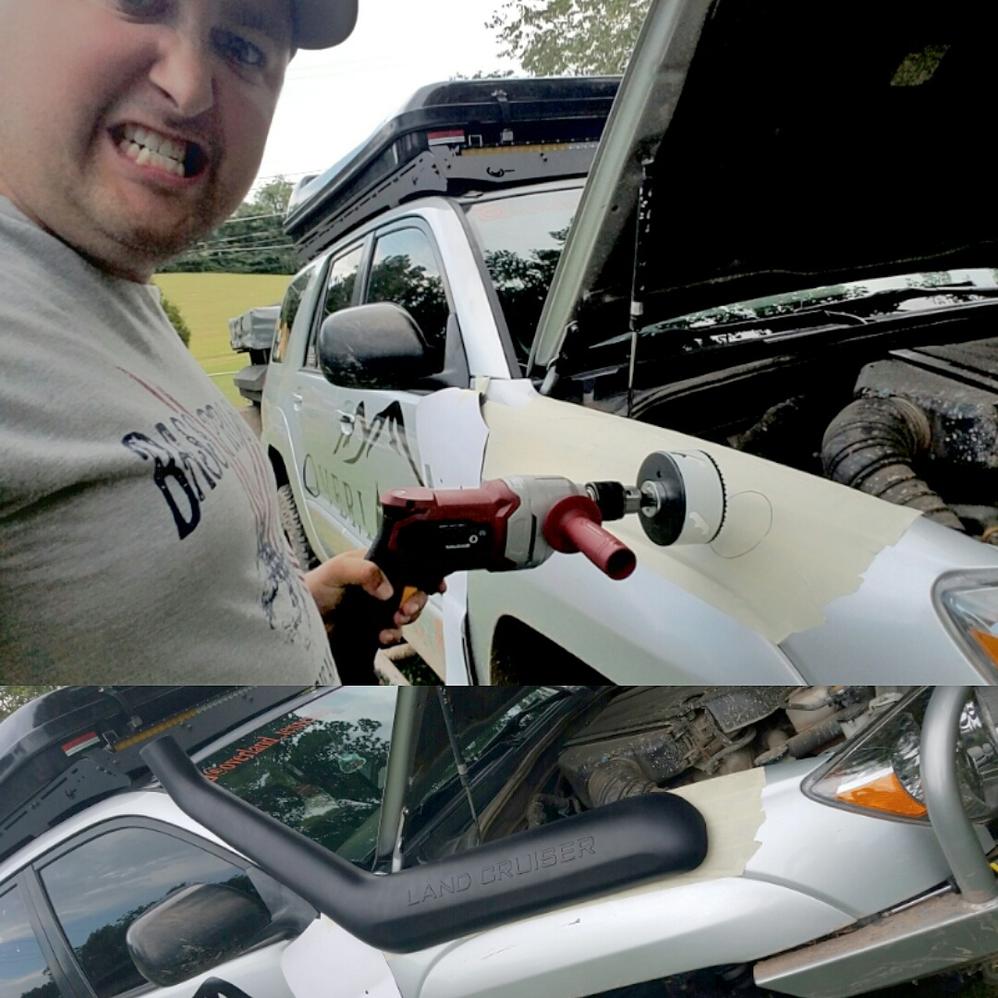

Installed mine tonight.

For all of you who have the LC80 snorkel installed, how did you plumb the intake? I installed mine this previous weekend, but couldn't find any hose's big enough at Auto Zone or Advanced auto that would fit both the snorkel and the intake tube on the v8.
Should have come with a rubber tube, I trimmed that down and used it to connect both ends.
I did the same, but the rubber tube doesn't fit the air box on the v8, I think the v6 is different? The diameter of the airbox on the v8 is about 3.75 or 4, and the tube that comes with it is about 3.5 inches
Oh, yeah no airbox on the V6. I connected directly to the intake hose that was in the fender. You cut the end off and then connect to the tube.
I wish that was the case for me. There has to be someone on here who's found a solution to this
I've installed 2 of these on the V6 and 1 on a V8 and the V8 was actually easier. You need to cut your fender back some with a sawzall and then heat the hose up and stretch it as much as you can and then lube it up and slip it over the intake tube of the airbox. It will work.
I did cut my fender back some, didn't think the hose would stretch enough even with the heat as it's so thick, but if you managed to get it on, i'll give it a try!
Def a joke. Thats one of the ebay Land Cruiser 80 series snorkels. I installed one of these back in the winter. Looks good, fits good, but noticeably lower MPG
noticeably lower due to drag because of the non-perfect fit or the concept behind a snorkel? My understanding was a snorkel at the very least should not affect the MPGs, if anything, it's supposed to help!
The fit is 95% so that shouldn't affect the MPG. It's the design. If you look at the 5th gen 4runner or Tacoma snorkels, they are a lot bigger/fatter to get more air through. I spoke to an ARB rep about this once and he said they have to make them that big to not restrict airflow. So I guess my conclusion is that the LC80 snorkel is just a bit undersized and is choking the engine a bit. Both of my buddies who have also installed these saw a small hit in mpg.
Ah, makes sense. Thanks for clarifying. I want some 4th gen love already! Soon we might just be able to 3D print ourselves a snorkle faster than ARB will release one
