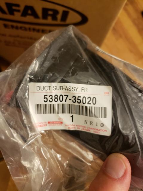

I got the Safari Snorkel sitting a few feet away in my living room. I ordered the Tacoma Air Duct (#9 on the diagram) https://parts.camelbacktoyota.com/p...iteid=214329&vehicleid=457852&diagram=8510150 . I am hoping that is all I need to connect it to my 90* airbox knuckle portion. https://parts.camelbacktoyota.com/p...ber=5281035010&vehicleid=457852&siteid=214329
Hopefully this portion will simply connect to the 4Runner portion of the duct and then connect to the Safari snorkel portion. I did research and discover some conflicting info listing #10 as the needed portion. But I am fairly confident that I just need the longer connecting duct. That should be here by the end of the week.
I already have the Tacoma whip antenna, so that should be one less thing to worry about. That, and I picked up a washer fluid relocation kit to get mounted and make some room on the passenger side.
that should be all you need. thats all i needed
So it turns out that you need part #5380735020.
The Camel Back Toyota diagram is WRONG! It listed the 90* knuckle, (#5281035010) as the correct part. This is incorrect.
You need part #5380735020 (for 2002 Toyota Tacoma 3.4 V6.)
What a PITA...

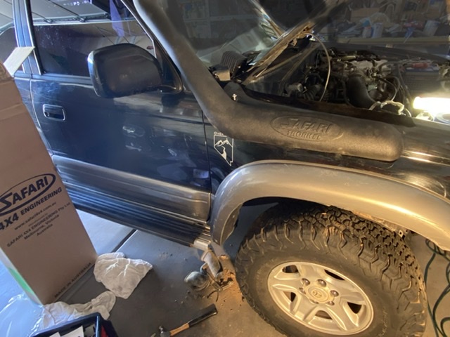

So far the install isn’t going too terribly bad

Well the Safari Hilux 167 snorkel install went pretty smooth. I ended up using 3m double stick tape for the A pillar attachment instead of drilling in to the A pillar. I want to try a cyclone pre-cleaner now to see if the air intake tube collapses like others have reported.
So if you’re looking to put an actual Safari snorkel on your 3rd gen, it is possible. Cost was about $330 shipped to my house, but it did take quite a while to get here since there were none in the USA. I ordered it the end of November and it got here the end of February. Obviously it’s more expensive and takes longer to get here, so you have to decide for yourself if the added wait and expense is worth it. For me, I’m glad I did it, but only time will tell if it’s more durable than the Wotofojsi or Best Snorkel USA or whatever Chinese brands are on Amazon.
For those interested, it’s the Safari SS136R. I ordered mine here: ARB 4x4 Accessories, Safari Snorkel Intake Kit, SS136R - Desert Rat
